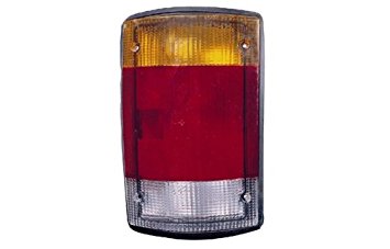

Yeah the early ones were supposed to be stock Econoline. Lots of those lights available on eBay and Amazon. For instance,
https://www.amazon.com/1992-1993-1994-E ... B004DS1L30
1992-1994 Econoline light

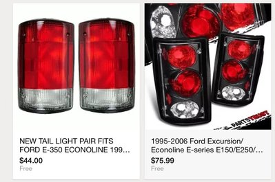

While we need confirmation, I'm pretty certain that owners with the smooth version like above should also be able to use the 1995-2006 Econoline lights that are red & white. Plus a choice of custom lights if you want a different look. E.g. on eBay:
1995-2006 E350 lights

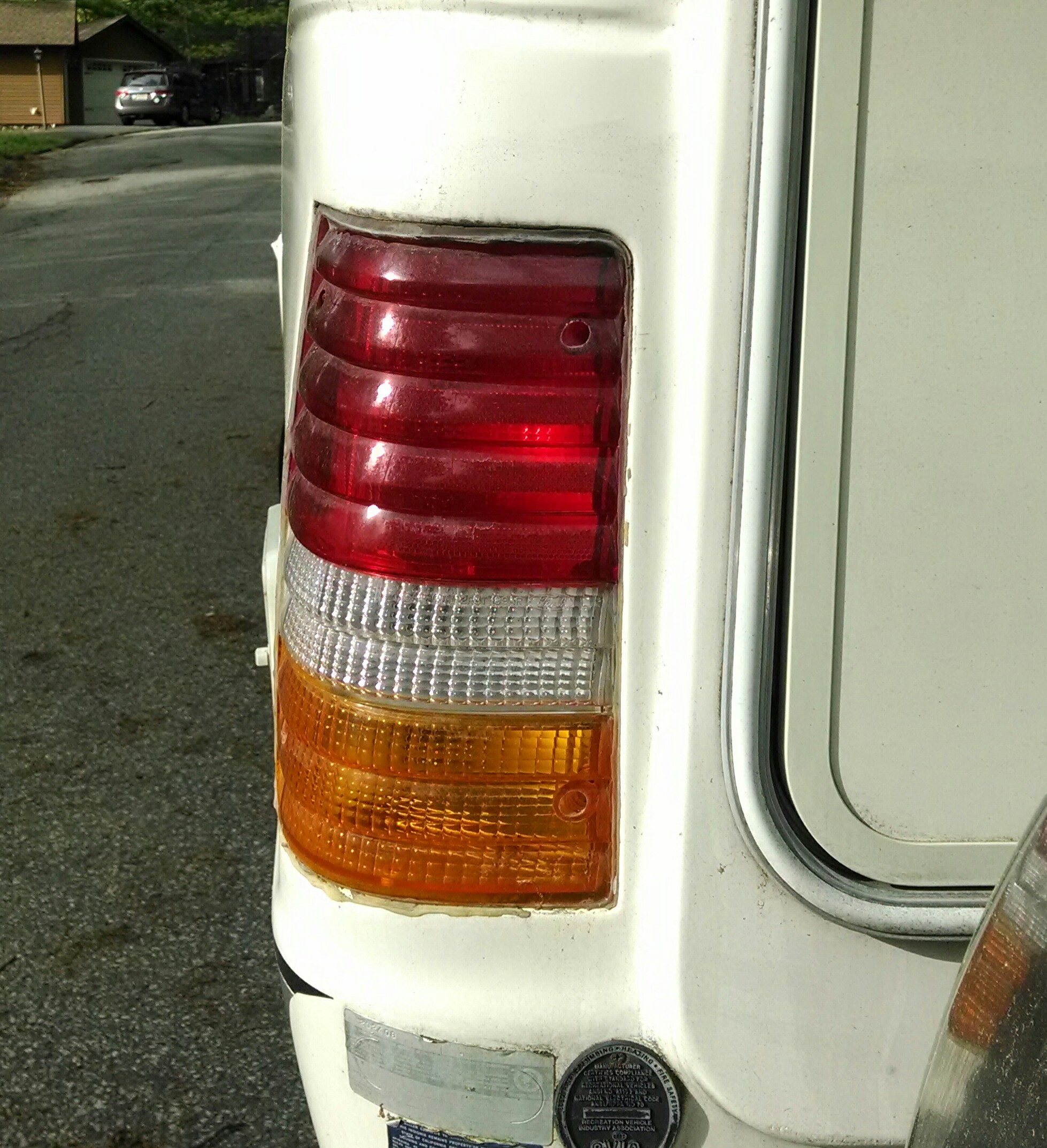

However, my 1994 Chinook apparently came with different lights plus a different body shape to fit them. Compared to the stock E-series replacements like those above, my lenses are slightly shorter, more curved, have no gaskets, and even the sockets have different locking tabs. So Econoline lights simply don't fit, even after modification.
Hmm. Come to think of it, they're also ribbed, unlike the flat smooth Econoline replacements. And red-white-yellow instead of a later pattern. I wonder... maybe I should look for another truck model or even brand. I bet Chinook was using up old stock with mine.
Edit: well, I finally looked at their part number (duh) and figured out what tail lights Chinook put on my Concourse... they used 1989 Aerostar tail lights !!! No wonder Econoline lights didn't fit. Well, at least I finally know. Mischief managed!
1989 Aerostar used in my 1994 Concourse
Checking my picture collection, I now see that Chinook used the Aerostar lights up through mid 1995. I even found what is likely a late 1991 flat hood Ford Concourse with them, probably a result of the mold starting to be updated for 1992.

AH-HA!
It's the ribbed Aerostar lights on my 1994 Premier. Thanks guys. Glad I asked. It seems odd that they'd spec the Aerostar lights instead of the Econoline lights. Too bad they didn't have the foresight to know how much more successful the Econoline would remain (along with the aftermarket) compared to the Aerostar.

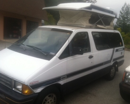

Note to Aerostar replacement lens buyers: you want the ones WITHOUT support for the rear washer. Otherwise at least the right rear lens will have a large top notch cut out for the tank or pump. Instead you want the washerless solid top versions.
Interestingly, Chinook sold an all wheel drive Aerostar popup roof camper in at least 1991. That must be where they got the idea for using that particular lens.
1991 Chinook Aerostar
From the lens years being used, it looks like Chinook went with whatever they get the most of, for the best price, by waiting until less expensive replacements were widely available.

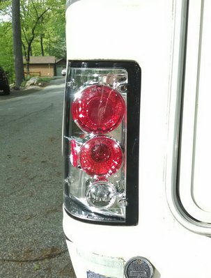

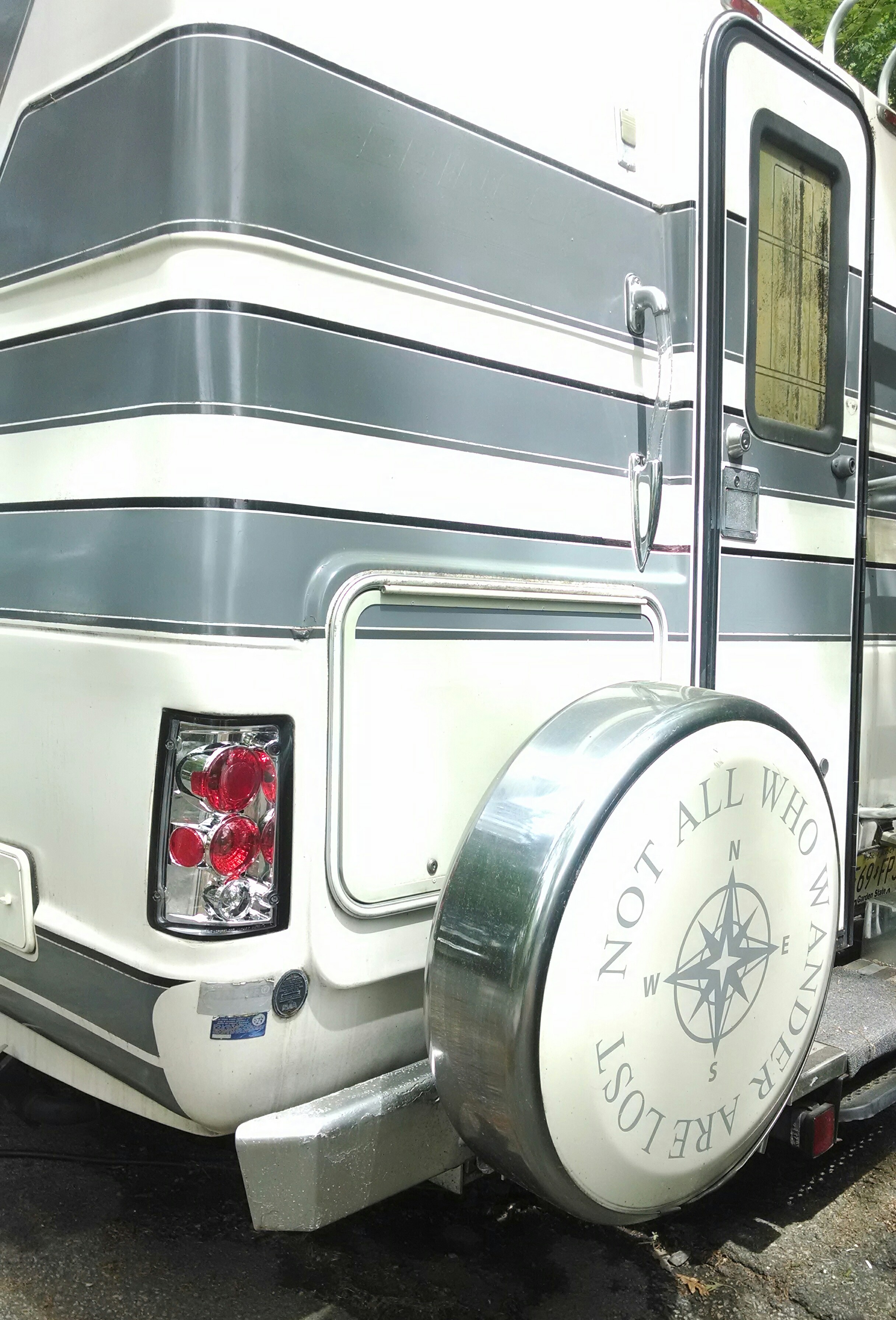

Okay, now that I knew the earlier units used Aerostar tail lights, I simply had to try to modernize mine to match my front LED daytime lights and billet grille :D
While there are lots of cool aftermarket taillights for the Econoline and Expedition versions, I only found one Aerostar aftermarket set. So..
From this crusty old lens:
Aerostar lens
Aerostar lens
To this Euro style:
Aftermarket Euro lens
(Still cleaning up old caulking someone had put around old lens.)
new rear
new rear
Still not sure I love them yet, as I miss the yellow a bit, but I do like the modernized feel of them... and of course, having a unique Chinook with them :). --- edit six months later: I love them!
