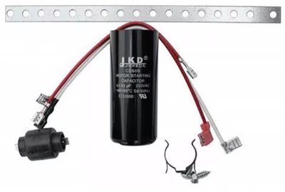

As for the AC, after first searching for a low profile replacement model (I don't want to be higher than my current 10" Penguin), I started reading up on why start caps blow.
One reason a compressor can lock is if power is lost while running, due to temporarily too much pressure differential for it to start again. Remember thst I mentioned that storms had come through, and I'm sure the power glitched a few times. So I waited a few days for the pressure on each side to equalize, installed a $33 Dometic Hard Start cap kit, and yep... she fired up just fine and has been running all day. Yay!
Dometic Hard Start Kit
Downside is that such a lockup probably does reduce overall lifetime, and my newly built-in AC power meter says it pulls more amps than it did before. But I'm okay with not spending $500-800 for a full replacement unit right yet :)
