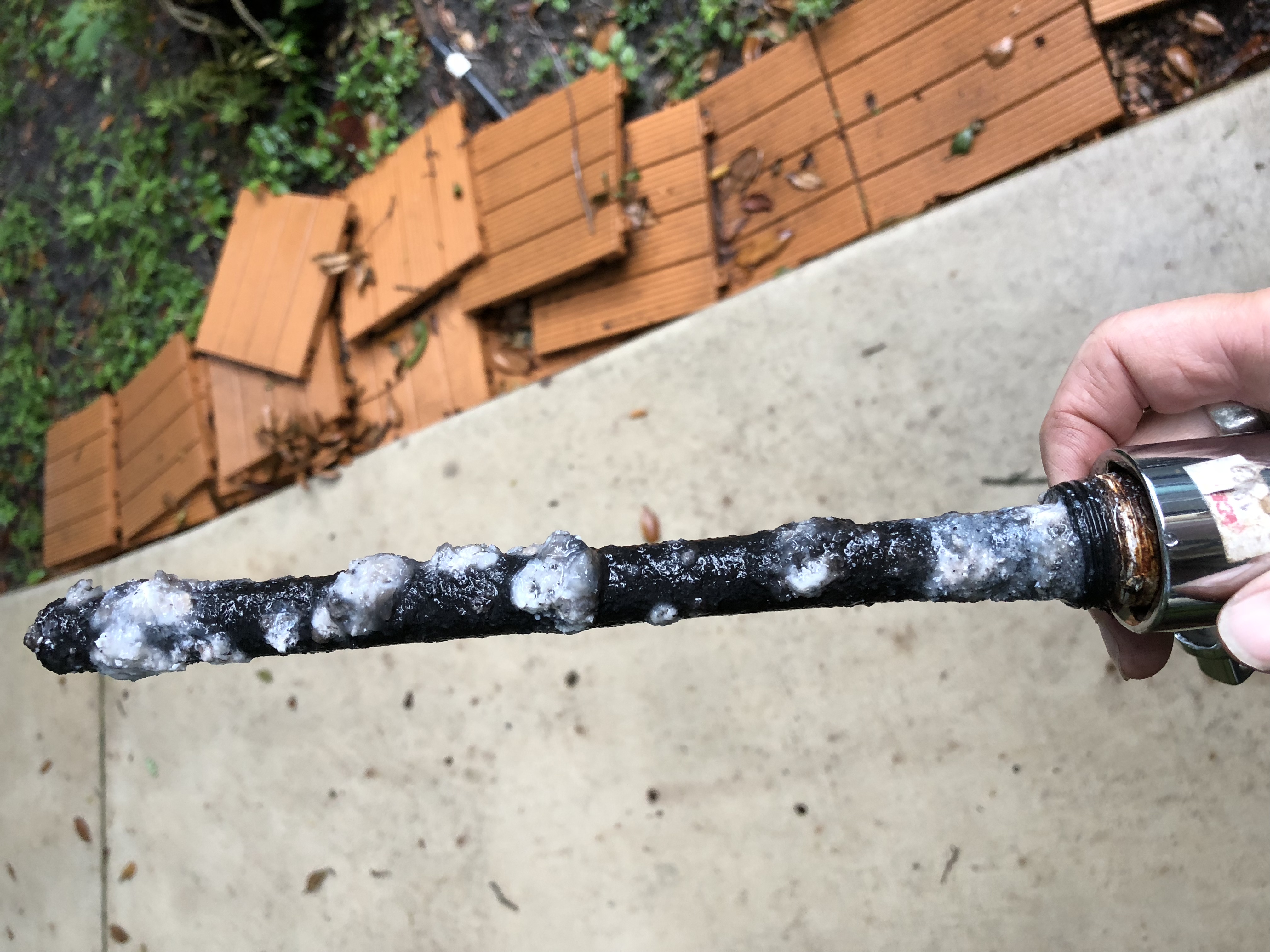

Could be related to the anode in the hot water tank. They are known to react with bacteria and produce the rotten egg smell. Bleach and or peroxide to sanitize the system would be my suggestion.

Blue, you are right on. after a little research I was able to locate the anode rod, and managed to get it out… It is quite corroded and the water coming out of the hot water tank was quite disgusting. Now to go to my local RV dealer to get a new rod and a flushing want to flush out the tank. Any suggestions on how to refill the hot water heater? In any case, so far so good and I’m feeling quite proud of myself !!

As a follow up to all who replied.....after much research, I was pretty convinced the sulphur smell was coming from the hot water heater. As instructed for my model water heater (Suburban), I took out the anode rod which was corroded and pretty gross. I went to my local RV dealer and purchased a new anode rod along with a flushing attachment for the garden hose. I flushed out the hot water tank and some pretty gross black sludge and particles came out. I flushed till clean. Wrapped the new anode rod w teflon tape, inserted and ratcheted it back into place, turned on the water and voila!!! No more sulphur smell!!! As a single woman, I am so happy and proud that I was able to do this myself and solve the problem. Don't ever let any problem get the best of you!!! You can do it!!!!
