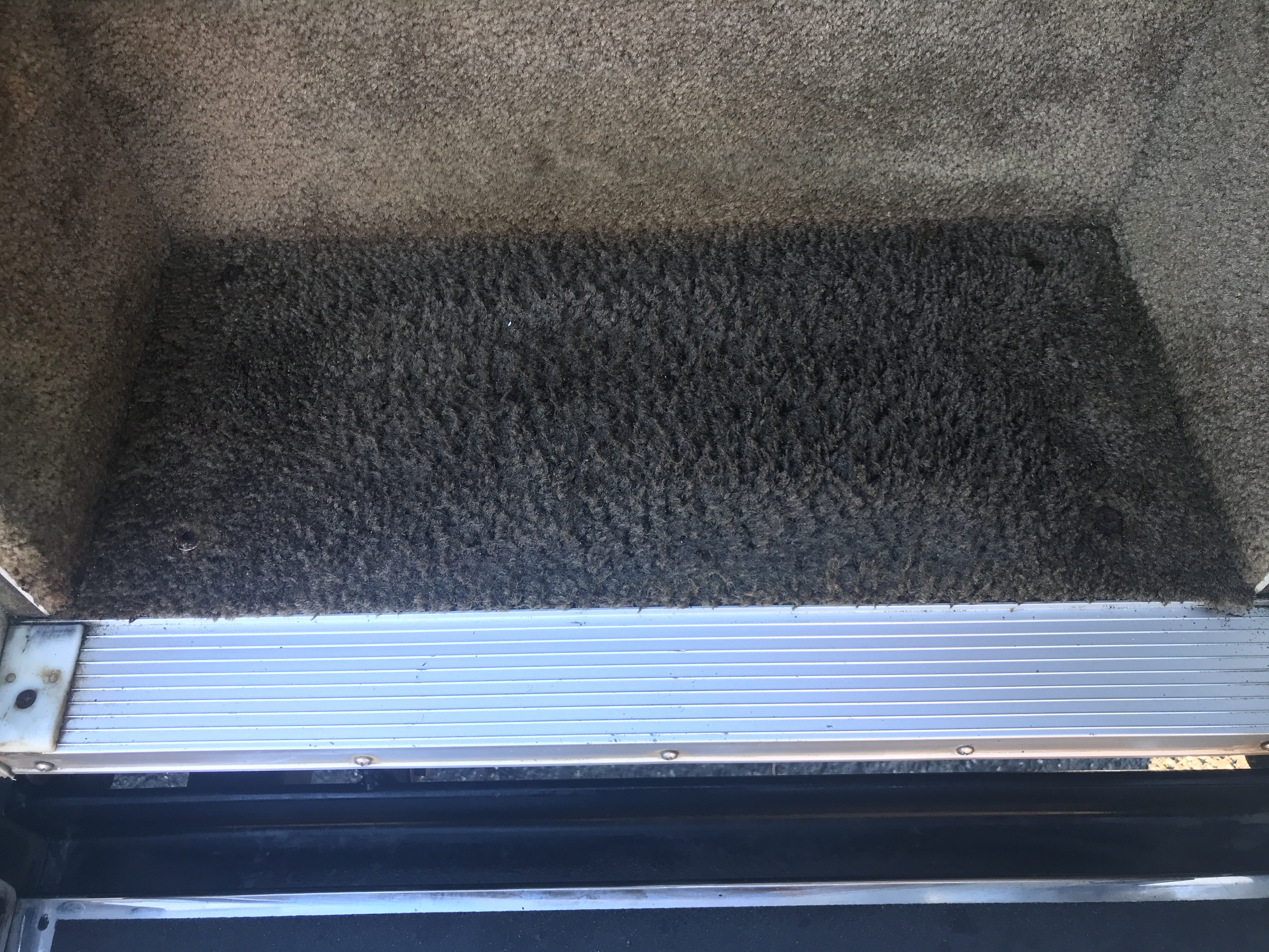

I checked the generator area today and it too seems to be pretty dry.
I inspected the rear door again and I notice that the seal is pretty much flattened and perhaps doesn’t make a good right contact with the jam. I believe the leak is coming from the door seal. Why else would the lower floor well be wet and nothing else above it. The MDF soaked it up like a sponge and I think that’s why it swelled up higher and looks the way it does.
By the way, the closet door latch wood is not wet. It looks like it was broken by someone trying to open the door without pushing the latch button. If someone doesn’t know about the push button, I’m not surprised if they try to force it. Anyway, it’s not wet up there, just broken.

On the door: Mine has pretty much no weatherstripping now, and even in heavy monsoon rains/wind didn't leak at all. Not saying yours didn't, but... If you go up on the ladder and look at the top/outside of the door, you'll see there is a cauik bead on that little "hood" in the fiberglass where the white painted door frame joins the fiberglass body. Could that be it? That faces "up" and is exposed to weather.
Also, have you looked under the false floor in the closet? (Sorry if I forgot and you did already.) That will allow you to see the plywood floor between the generator and the rear wall. To explain: That carpeted sort of half moon bit of the closet floor that is aft of the generator box is a false floor. There is a loop that allows you to pull it up and it just completely removes (you can put it back). If the loop is missing or tucked under, just know you can completely lift it up (just pull up on the shag :lol: ). The reason it is there is that the AC junction box for the generator wiring is under there on the plywood floor. So that little carpeted panel sits on little wooden cleats that are attached to it. If it's like mine it will just pull out. You might get some good clues there.
Another thing to know as you noodle: If you were to pull the carpet up in the back hallway, you'd see that the lower inside rear step is part of a fiberglass "pan" that sits on top of the plywood floor (at least in mine). So.... not sure water could run across the floor and onto the step? Maybe if it traveled over the carpet pad or something.
