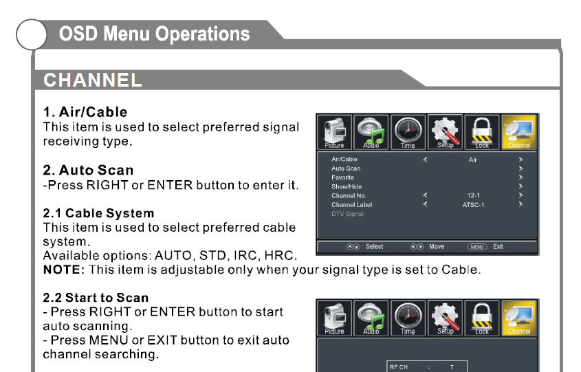

And just to be clear we're talking about the same things.........you're reprogramming the TV for cable versus air? Not just pushing the switch box button.
This:
Posts: 796
Re: Why don't I get cable TV at parks?
Correct. I'm aware I have to tell the TV itself too.
