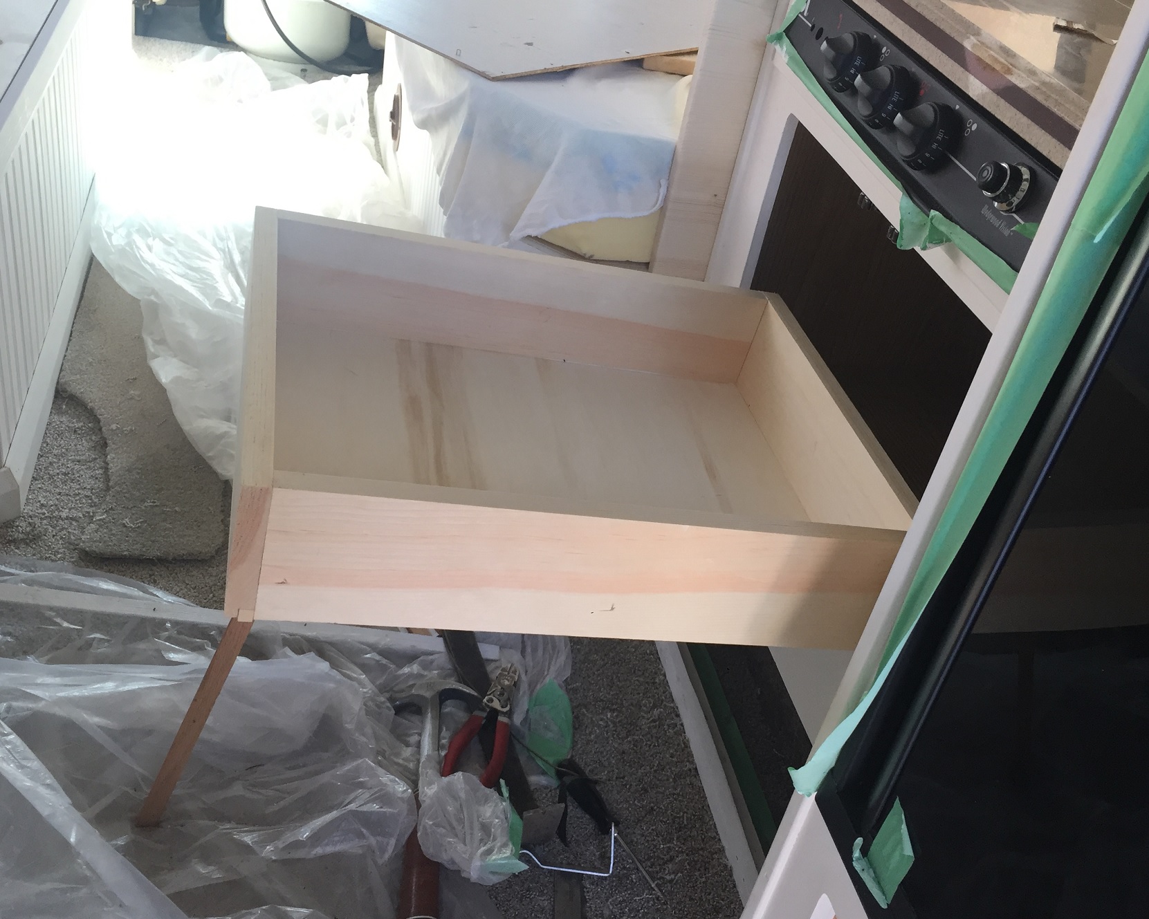

Alright! Cut all boards to length and then ran them through the table saw to cut the rabbeted edges to accept the plywood bases. Did the quicker and dirtier full cut which will create openings along the corners which needs to be filled with blocks to cover them. I glued them in and still need to trim and sand them off, they won't be noticeable when finished. Cut the leftover plywood I had to the right sizes and glued and nailed them in place. 1/4" ply is overkill and 1/8" would have been plenty but free is free.
I didn't spend time time cutting dovetail joints or doing anything "too" fancy, just simple butt joints and glue, just fast and simple but sill clean.

This little pot set came with the Chinook and the height appears just about perfect! Final images show a fast mockup in place and the drawers fit in both length and width, so it's onto the bearing slides. Unfortunately, they don't arrive for another day so I guess it's on to filling a couple of tiny nail holes and trimming the filler blocks and possibly getting my side pieces and panels cut to fit. All in all, I'm excited to see how this all works out but so far so good

All holes filled, glued in the corner blocks. A couple of edges are out 1/16" but a few passes with some sandpaper and everything will look really nice. I'm liking where this is going
