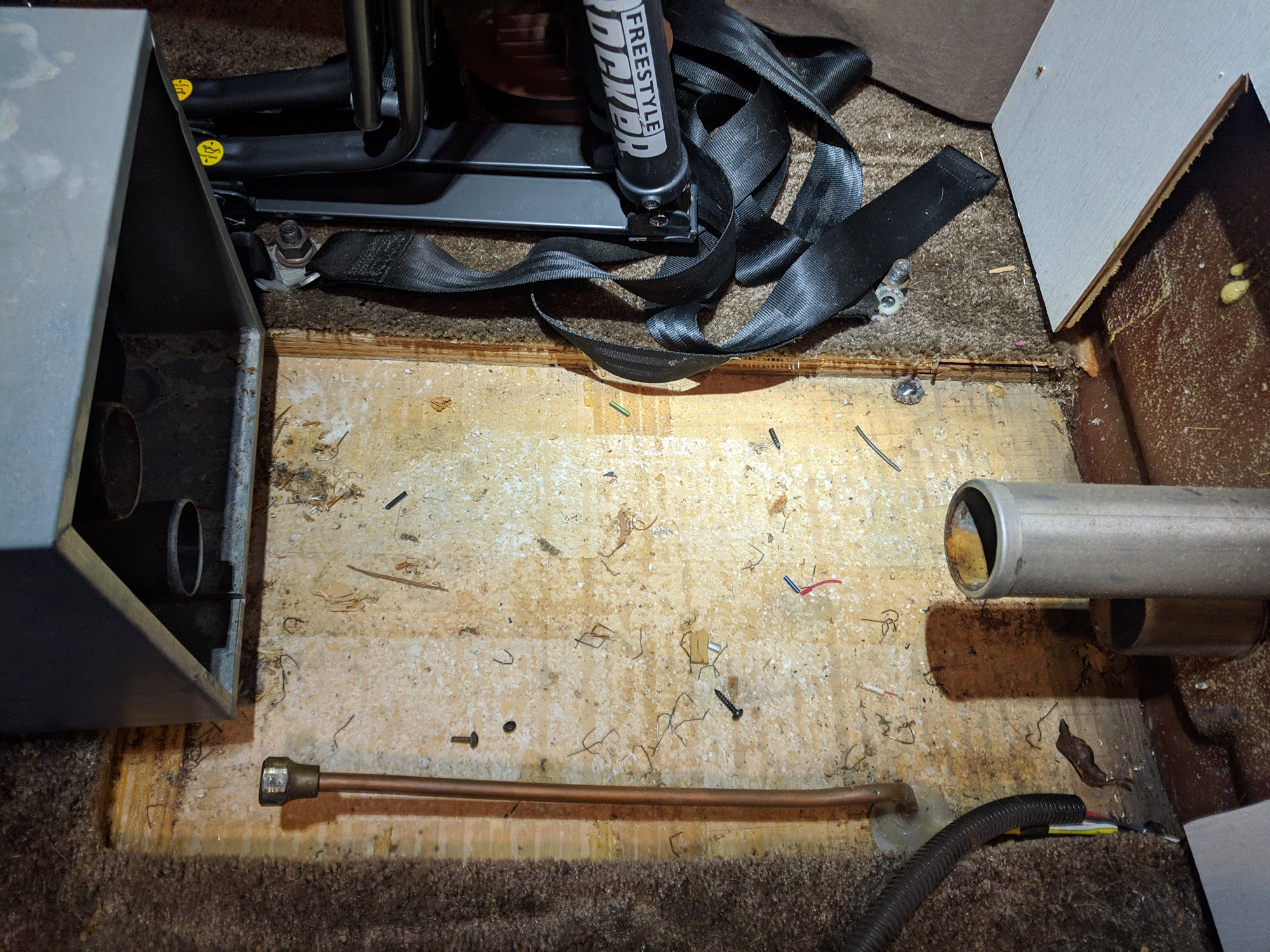

Since I know people like guts pictures, here's what was under my furnace when I took it out: lots of bits of snipped wire, some screws, wood shavings, and other assorted debris. Clearly I was never meant to see this :lol:
I need to go back and take some measurements for that cutout, so I can make a piece to fit in there.
I also notice that there is plenty of room behind the wall panel for adding insulation. Hmmmm... as long as I'm taking the furniture out... I need a "plotting and scheming" emoji

Yep, we're like surgical residents: Show us the good stuff! :mrgreen:
Well that looks familiar :) I didn't have the construction debris, so I guess the tidy guy drew the short straw when mine was made (because surely they drew straws to see who would have to try to get all those screws in to that super cramped space!).
I ordered a big roll of Thinsulate for adding insulation (got mine from impact3d, good folks). I haven't stuffed it in yet because in the back of my mind I still might take those walls down.... (and it's pretty warm where I am in the winter). If you think that's a lot of space, you ought to see behind the shower. You could practically rent it out!
