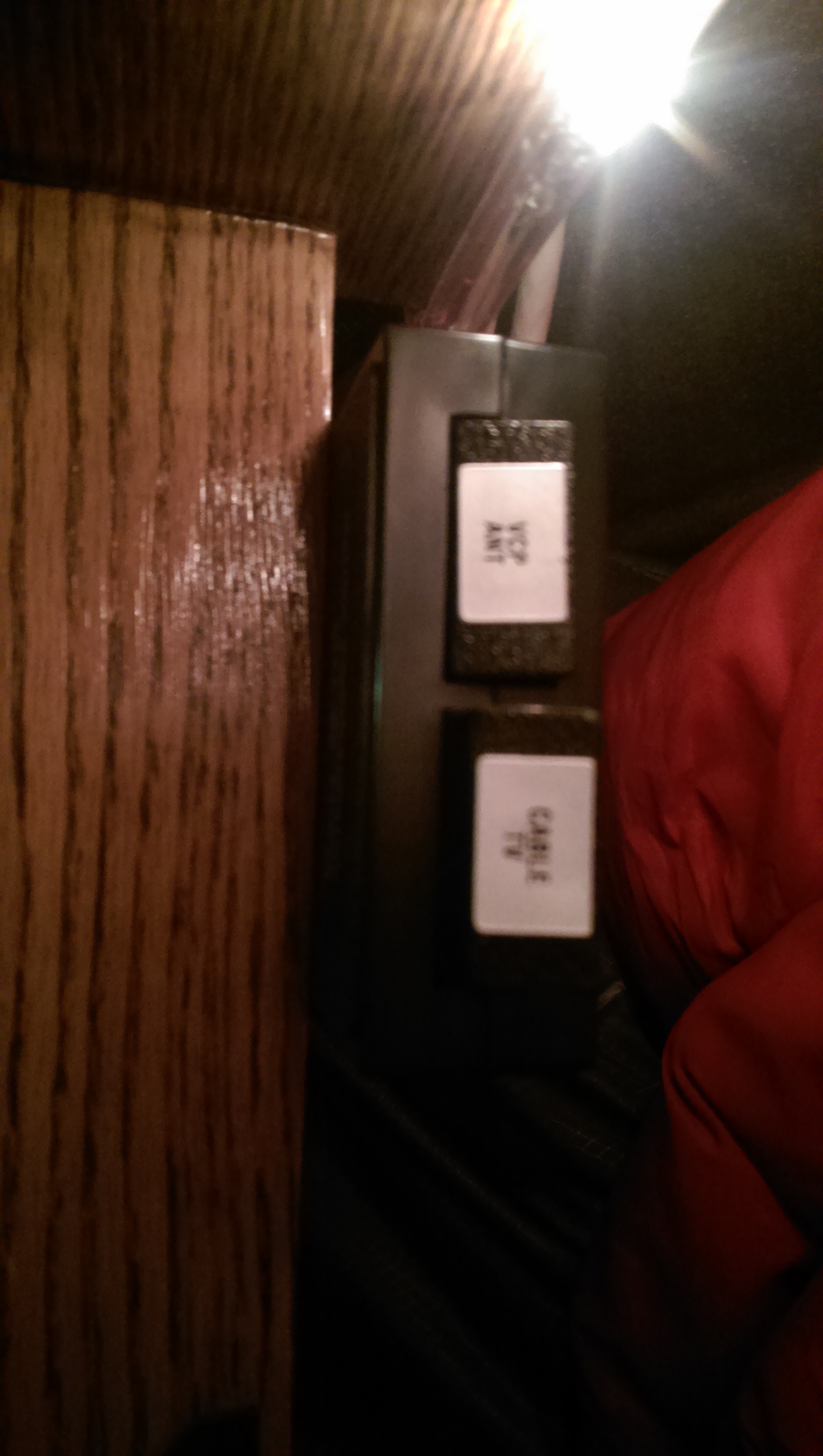

The cable is connected to a video switch located behind the center overhead cabinet on the left side (next to the TV location). The video switch switches the TV input between the external cable, and the TV antenna/Video player.Fjb wrote: September 26th, 2019, 4:09 pm 2001 Chinook Concourse “park cable hookup” is in the outside compartment where water fill and electric cable are located. Question is - where is it connected to on the inside for hookup to TV? Thanks for any assistance![]()

Sorry I wasn't clear enough. The cabinet I was referring to is the large cabinet in the front, next to where the "original" TV was located.

Thank you soooo much! Never in a million years would we have looked there! It appears that we have a cable TV connection in that location. Will hook it up tomorrow!
