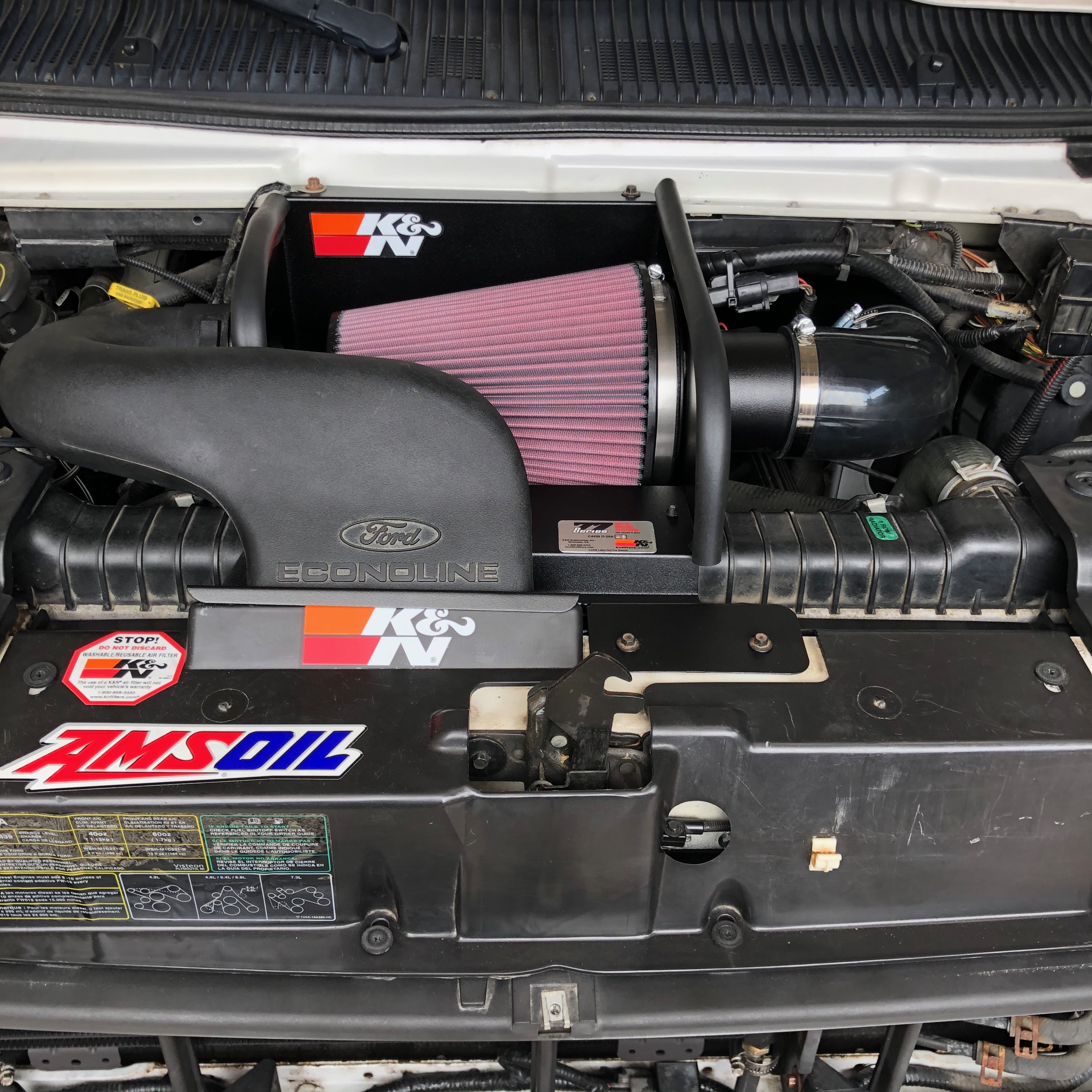

From a results standpoint, I've only done about 15-20 minute drives post install so not much data. With a heavy foot and some hills I struggled to get the trans temp above 150, so it will be interesting to see it in action on a triple digit day climbing grades. I live on the coast so I don't see much over 80 degrees around town. The K&N CAI was a nice upgrade, but pricey for the return on investment. Nice sound, and not overwhelmingly loud as a negative I've experienced in other vehicles. It has a noticeable punch at the top end, and certainly no loss at the bottom where the V10 typically shines. I'll update when I get on my next long trip with some heat to it.

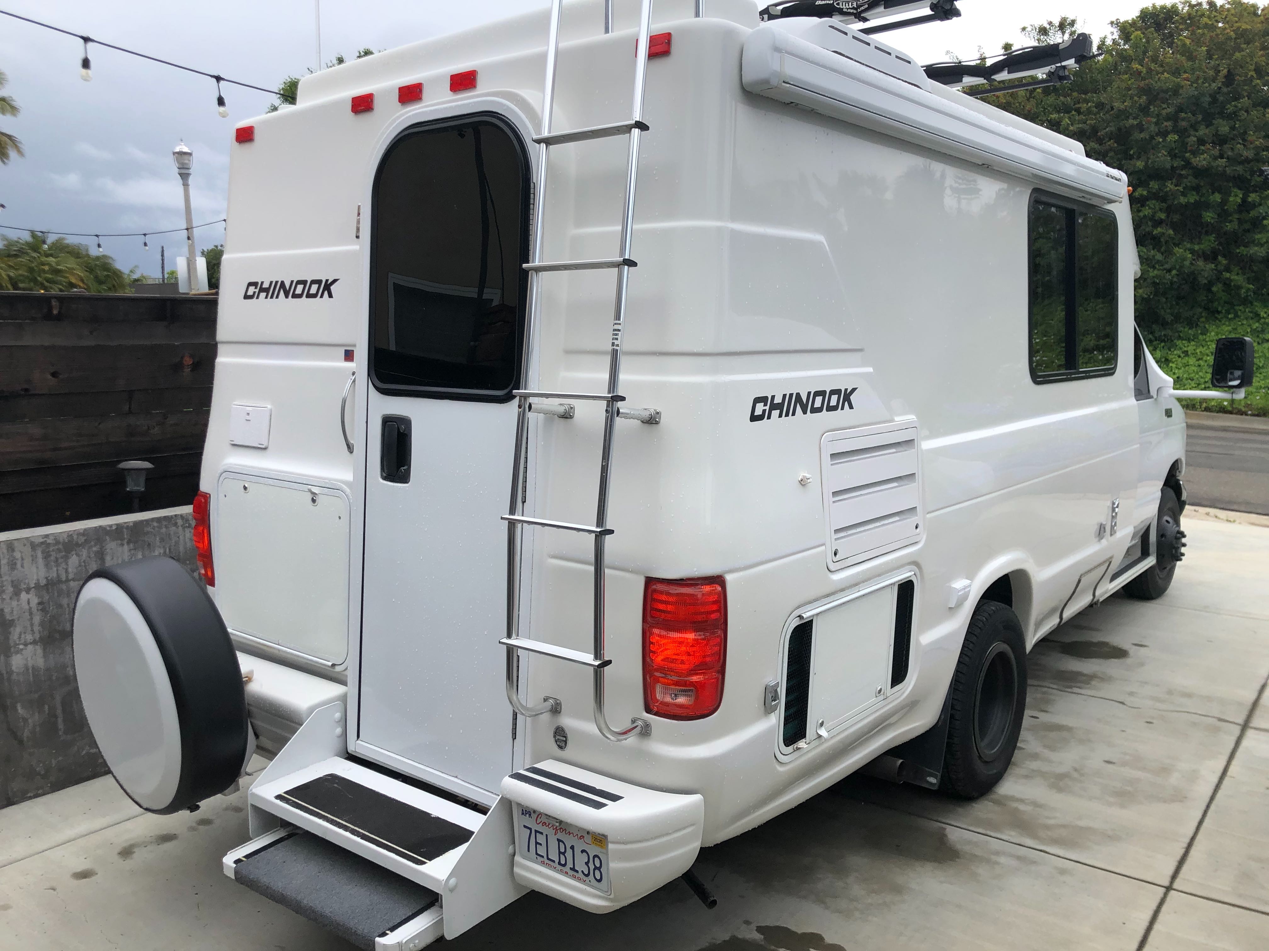

Anyways, here are some more pics of the cold air intake and my Chinook exterior for rig reference.
