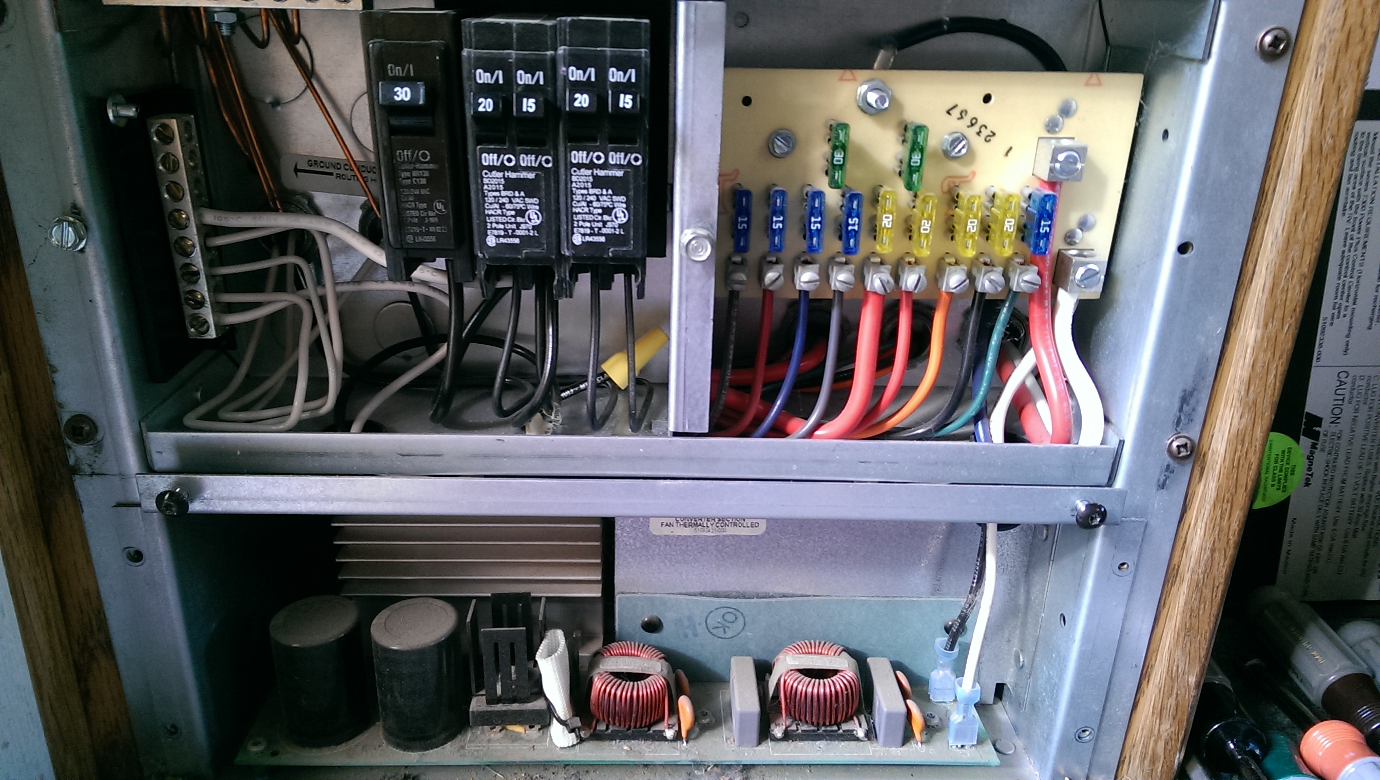

Attached is a picture "Magnatek Before", showing my original converter before the conversion.
There are three compartments: an AC distribution section (upper left), a DC distribution section (upper right), and the converter (below). Your layout should be the same, but your converter electronics in the bottom were quite different.

The 6300 series is a little different from the 7300 series we have in the later Chinooks, but the PD conversion process is pretty much the same. The PD unit has two sets of wires, an AC group (black/white/green), and a DC group (larger black/white). There is also a wizard cable with a 4-pin connector on each end.
The AC group goes out the left top hole of the new converter straight up into the AC distribution compartment above the controller.
The AC compartment has the big black AC circuit breakers (on the right), a terminal block for the AC white wires (far left), and a terminal block (top left) for the AC ground (green or bare copper) wires.
The AC black wire is attached to the "Charger" black circuit breaker in the AC compartment. In my unit, the charger breaker is the third from the right of the five breakers. The AC white wire is attached to one of the screw terminals on the left terminal block, and the AC green wire (ground) is attached to one of the screw terminals on the top left. This is the "ground bus" referred to in the installation (one of your original questions).
The DC wires (black/white) from the new converter go through the right top hole straight into the DC distribution compartment. The DC compartment has the DC distribution circuit card (replaced in the upgrade). One difference in the old 6300 vs 7300 converter is that there are two DC positive wires (red? and blue) in the 6300 instead of one black wire in the 7300. Both units had a white DC negative wire. In your case, the blue wire you disconnected from the DC card should have been attached to your old converter and removed when you took out the old one. If you still have it dangling (your original question), or if it is connected to something there is something amiss as it should have gone away when you took out the old bottom unit. Perhaps the original wiring was changed by the previous owner, related to your other 12V problems. If you still have it in the cabinet, it should not go anywhere, and can be removed. The new PD converter black (DC positive) and white (DC negative) should connect to the new DC board according to the instructions.
Finally the wizard cable should be connected to the new converter (front left connector on the converter card) and run through the top right hole to the DC distribution card connector.
You other question regard a "gray wire" run to the DC distibution section needs more clarification in order to answer. There are many DC supply wires run to the fuse panel. (Was the gray wire one of those?) You should have moved all of them from the old DC card to the new one, along with the fuses. I am out of pictures for this post, so I will add another post with pictures of the before and after DC boards.

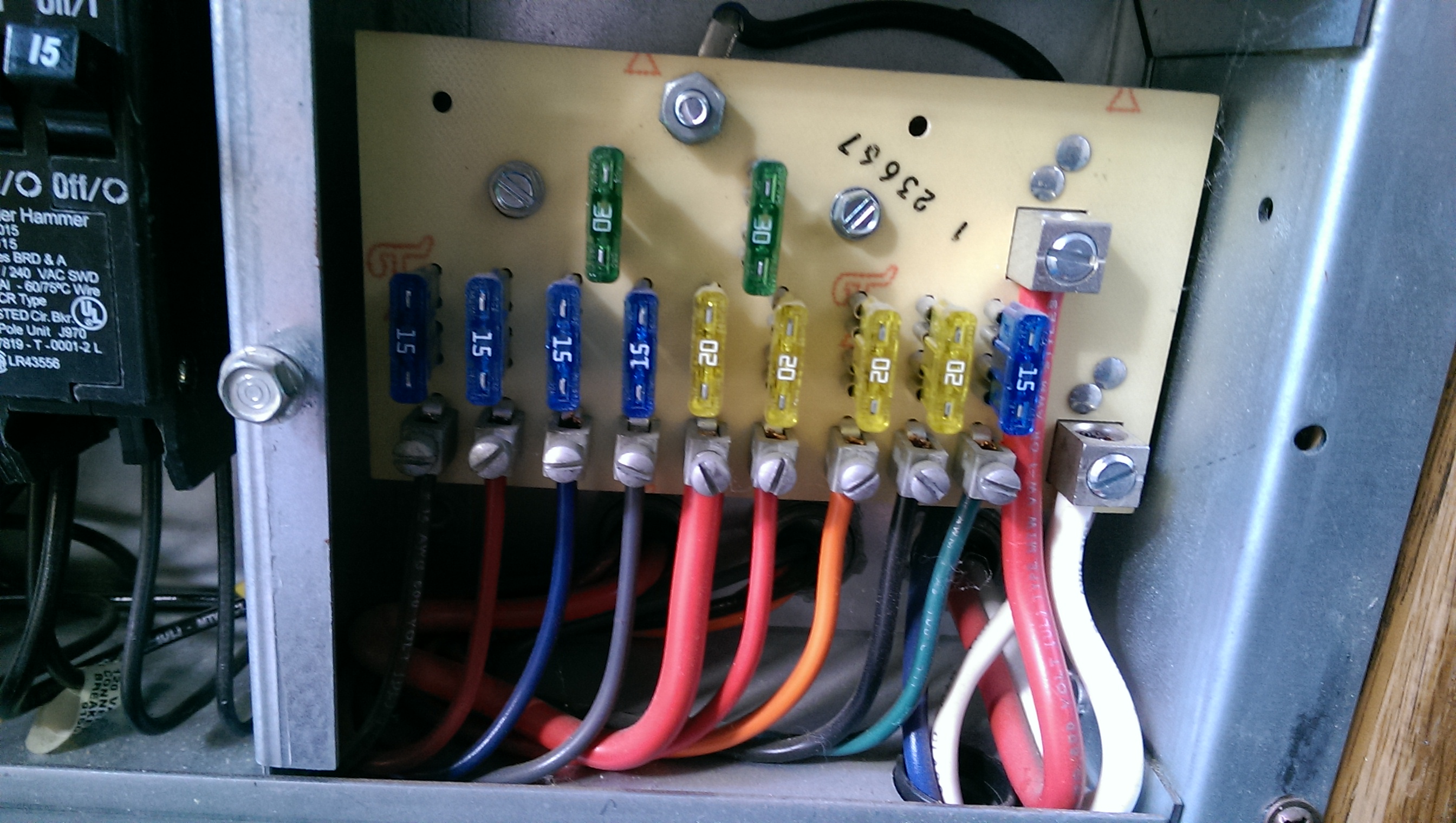

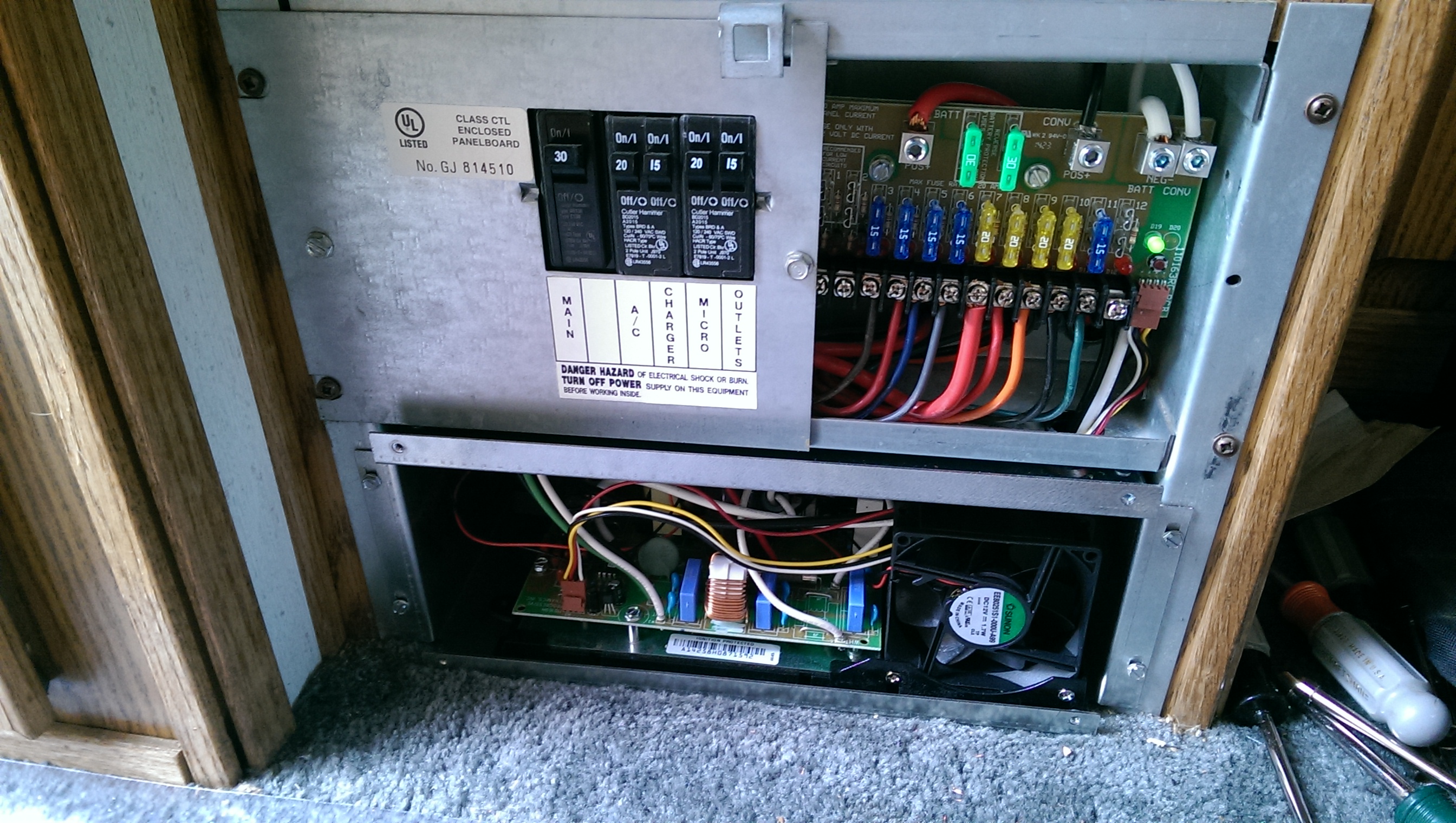

More pictures for the Magnatek to PD converter upgrade.
The Magnatek DC section before:
The PD DC Wires:
And the completed assembly after the conversion.
This shows the new DC distribution with all of the DC wires and fuses, along with the wizard connector and cable. The new DC card has two additional low current circuits, and one additional regular DC circuit, compared to the original. I skipped over the low current and maintained the algnment and placement of the original circuits. There is an unpopulated spare circuit left on the right. I may move the parasite circuit (LP detector,etc) to one of the low current circuits later.
