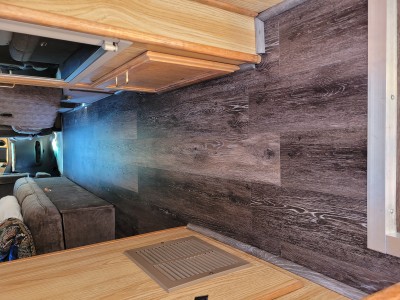

The LifeProof flooring has a pretty thick rubber underlay attached. I used my oscillating multi tool to carve around the floor bolts. I spray painted the bolt, lay the piece of flooring down to transfer the paint mark, took it to my bench and carved it out.

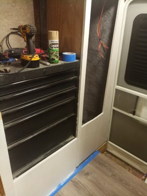

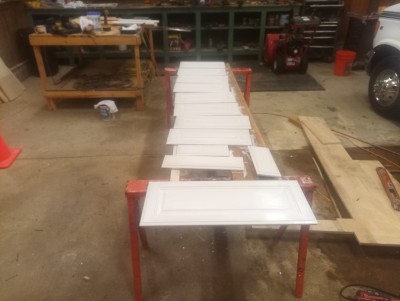

Working on painting right now. I have everything removed. I'll update with more pictures once I finish.
I despise painting. This can't be over soon enough.
