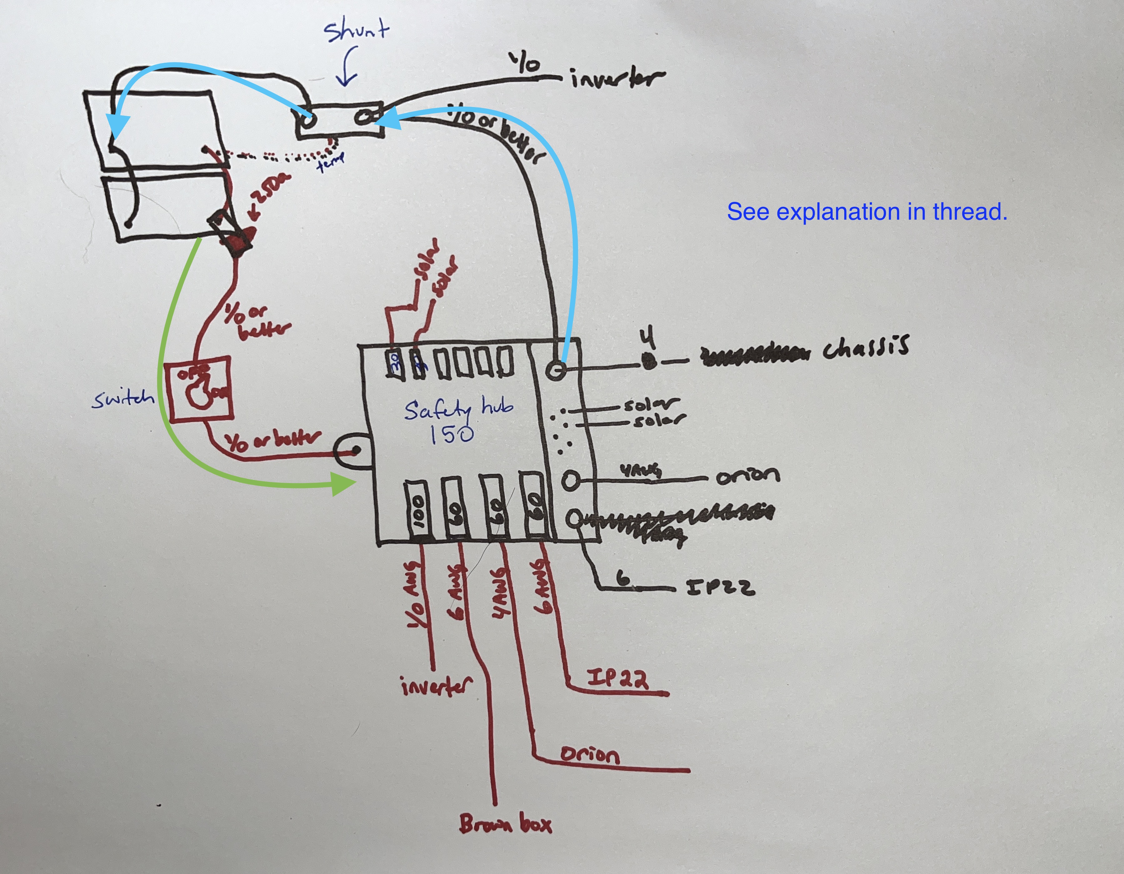

But on the second half -- using 4AWG between the SH neg bus/shunt/batt neg post -- I disagree. I will insert a drawing here with an explanation below it.
[But wait.... now that I stare at my drawing an hour later..... maybe there is not a loop there? Ha, the fact that the SH is all one piece makes it weird to think about. So maybe I'm wrong and any current in the "teal" leg would have to have passed through a smaller fuse/positive leg in order to get back around. That said, even so my own personal preference is to have the "equivalent" negative legs always be the same size as the matching positive legs. If nothing else just for the same reason you have a larger "green" initial positive leg than you do the spurs... because that leg -- and the corresponding return leg -- can carry many loads at once, so it's just a good idea. Otherwise why have that first leg be 250a fused 1/0? (We know why.) But okay, so carry on reading with that in mind...]
I posit that the teal colored wires should (also) be 1/0, along with the green ones. Here's why. Look at the "loop" made by the 1/0 positive wire coming from the battery (green arrow) and the return path that I have shown in teal (which I also think should be 1/0).
Let's say there is a short in that teal section of wire. What is fusing it? Answer is the 250a MRBF on the positive battery post. 4AWG only has an ampacity of 160 amps in even the best case scenario. 1/0AWG has an ampacity of 285 amps in the best case and 245 amps in a slightly more conservative case (using the 90ºC rating for 105ºC rated wire). In other words, 1/0 is adequate, but not super generous for a 250a fuse.
Now let's say you go down to a 200 amp main fuse. Then you could make that 1/0AWG loop juuuust barely 2AWG, but that would be even tighter to the ampacity rating. If I were going to go down to a 200 amp fuse, I would still keep 1/0 and just have a more generous safety factor.
I would stick with 1/0 and a 250 amp main fuse. Why? Well that cable is carrying everything. Why whittle it down? In case it helps, I have a 2/0AWG (bigger!) jumper (from the Blue Sea switch to the Safety hub) that is about 3" long. And same in 2/0AWG from the SH neg bus to the shunt load side. You are working with 1/0, which is smaller, so you could make it even slightly shorter. I usually would use a solid link for these shorties, but in this case (for reasons that would just clutter up this post), I wanted to use cable and lugs. Key is that I "pre-curved" the wire (basicallly worked with its natural curve) and then crimped on the lugs also patterning to the bend. I have actually made shorter ones that were literally two lugs with wire in each one and no "body" wire to speak of. Just heat shrink (less curve in those).

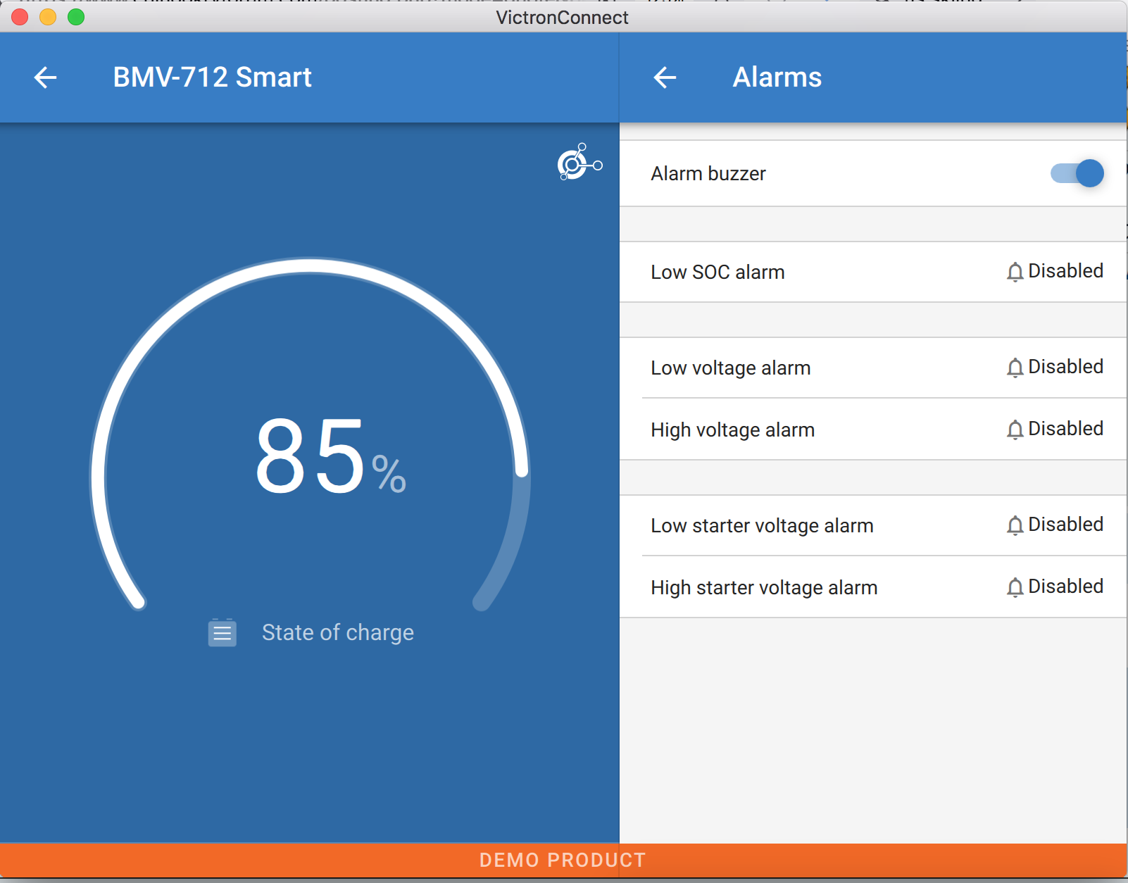

This is a good time to mention that once you have Victron Connect up and running (which you can do now or maybe already have), a great resource is to go into the "Demo Library," which you can choose by going to the upper left hamburger menu in the Victron Connect app. This allows you to go in and see all the settings and mess around with various devices, without doing it on YOUR devices. Or see what a device has to offer before buying it. These things are usually also in the manual but this is a great alternative. Here is the "alarms" page from the Demo Library for the BMV712:
Here you can see that you can set one or more alarms. For my current LFP bank, I use a low SOC alarm. This is due to the fact that LFP voltage is very stable. This is great for actually using the batteries, but not so good for using voltage to set an alarm. There's just not enough voltage variation.
But SOC can drift over time due to various factors. So with an AGM bank I think I would use voltage for my "low" alarm. Set it to perhaps 12.2v or thereabouts. OTOH, perhaps your inverter will cause too much voltage sag for that with lead acid batteries. If that's the case, you can go with low SOC % instead.
A tip on SOC: Besides making sure you get the intial parameters set correctly, you can also manually sync it to 100% anytime you KNOW the batteries are at 100%. You can do this in the VC app, or you can also do it by pressing and holding the + and - buttons on the display head simultaneously for a couple seconds. This helps keep it accurate.
Also, as your AGM batteries age, if you want SOC to stay accurate, you will want to reduce the capacity of your bank. This is a bit of a guess of course. But essentially if you start with say 200ah, but then two years later your bank's capacity is down to 160ah, then your baseline has changed. So your SOC would be all wrong, as it would be calculating percent based on a 200ah bank. Changing the bank capacity (easy in the app) will coordinate things again.
Good thing is all of this is easy to change right from your phone. It's not like ye olden days where you had to open up some obtuse program or squint at dip switches or numeric codes that meant something you had to look up and decipher (even the BMV 600 still had those). "Hmm, what is 'L4'....?"

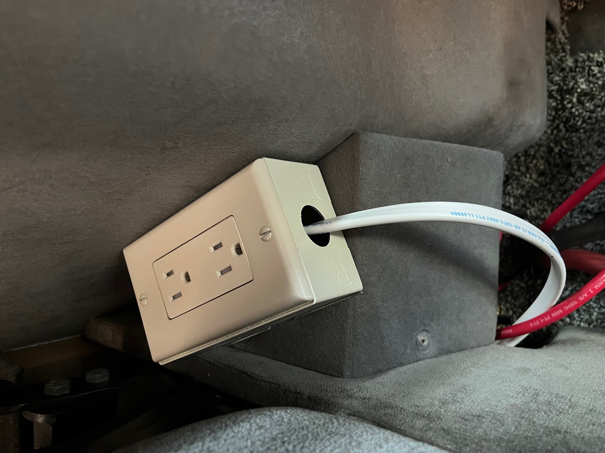

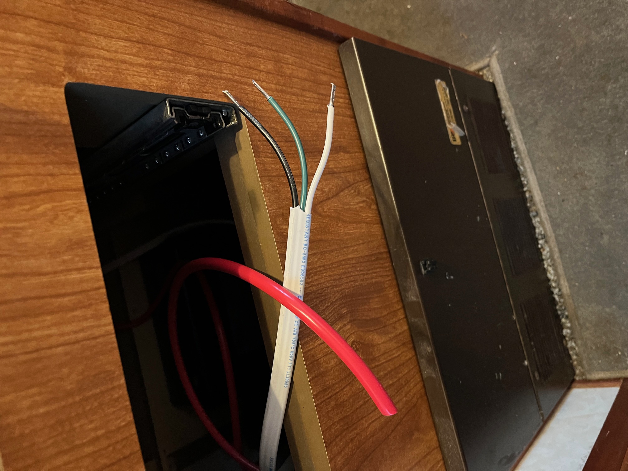

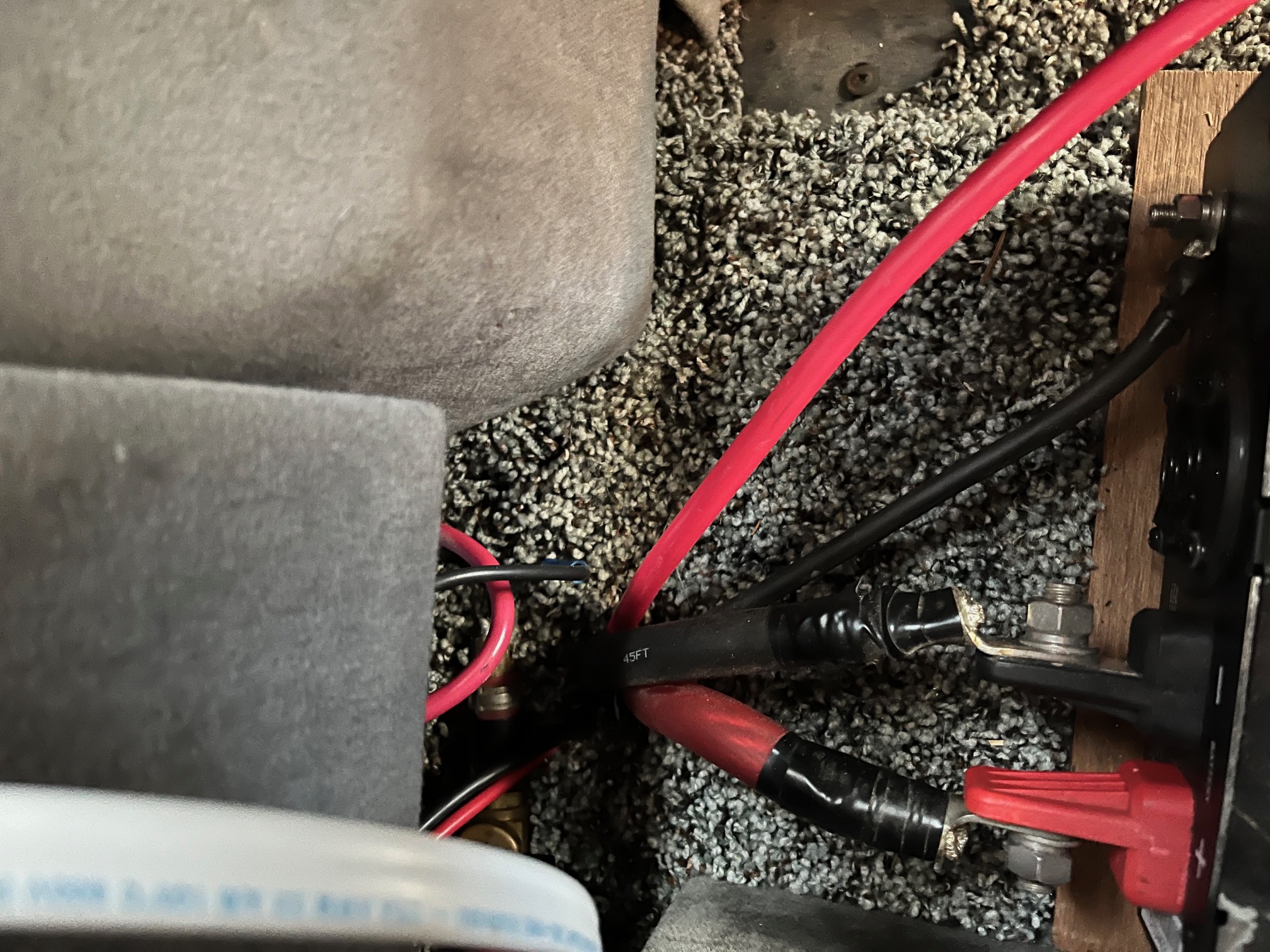

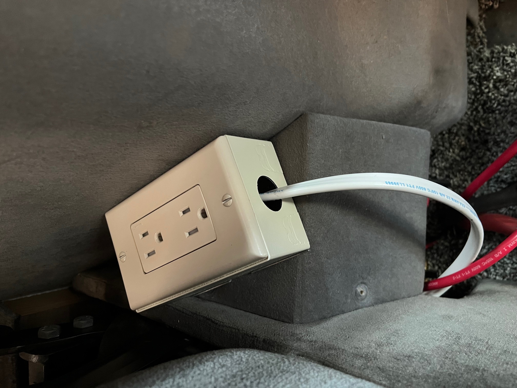

It's been way too cold up here in New England to do any work outside, so that work (new Start Battery terminals, IDing existing wires into the battery, removal of the Blue Sea ARC) will all have wait. In meantime, I have cranked up the heat in the Rig to do some of inside stuff in preparation for installation of new Batteries, Chargers, Safety Hub, and BMV 712 that my Man Eddie will be doing. Here's a rundown:
--got a flush mounted outlet and wired it with 14/3 that runs behind the couch to the Brown Box. The outlet will mount in LVD location (once LVD is removed).
--Ran new 6awg wire from Distribution Board area behind sink, behind couch to the hole (leading to battery compartment) that was made for the inverter wires...there is room enough for the 6awg as well...nice bonus. Then I can repurpose the hole that currently takes the old 8awg to batteries for the BMV wire from Shunt to Display. I've decided to velcro the Display to the top of the "triangle thingie" that covers the LVD (and will cover the new outlet)...FYI, I discovered that the Distribution Board will not take anything larger than 8awg coming in from the batteries--so I will use a step-down straight connector (6awg to 8awg) to attach a short run at end of this line to the Distribution Board. Now that I have gotten my sea legs, I've decided to make as many of my own wires for the project as I can... cutting wire, using ferrules, making ring terminals, crimping, and heat shrinking. Growing my tool box and learning new things!
...some pics of the "work in progress" attached.

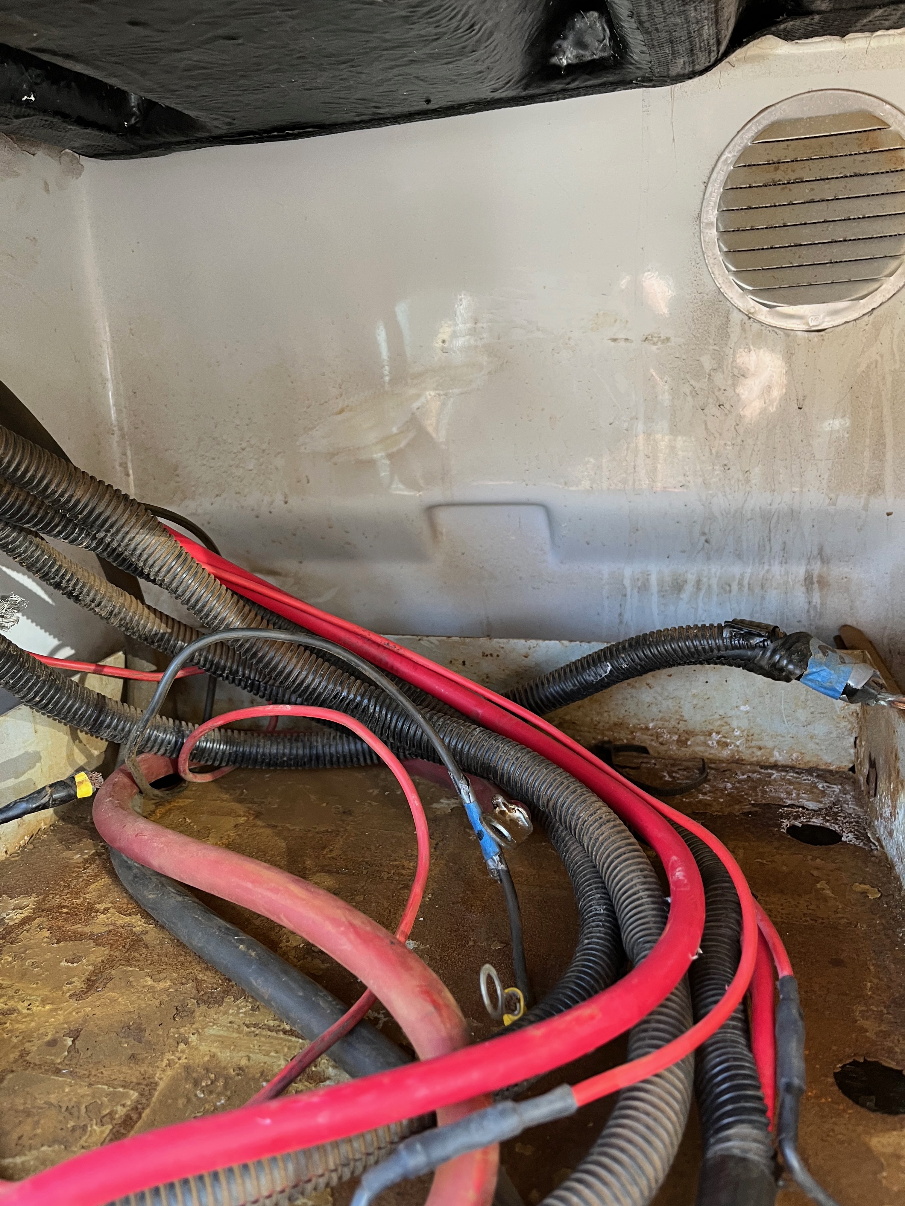

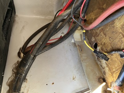

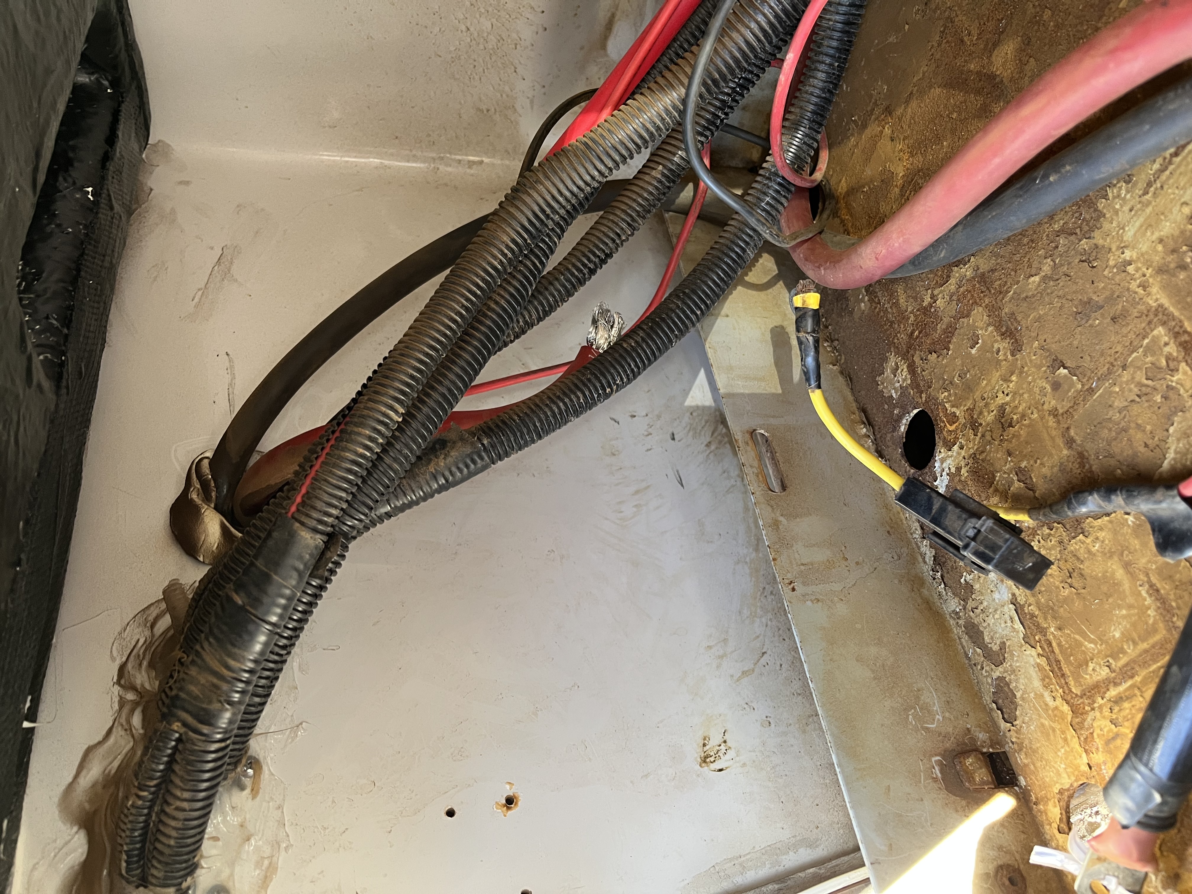

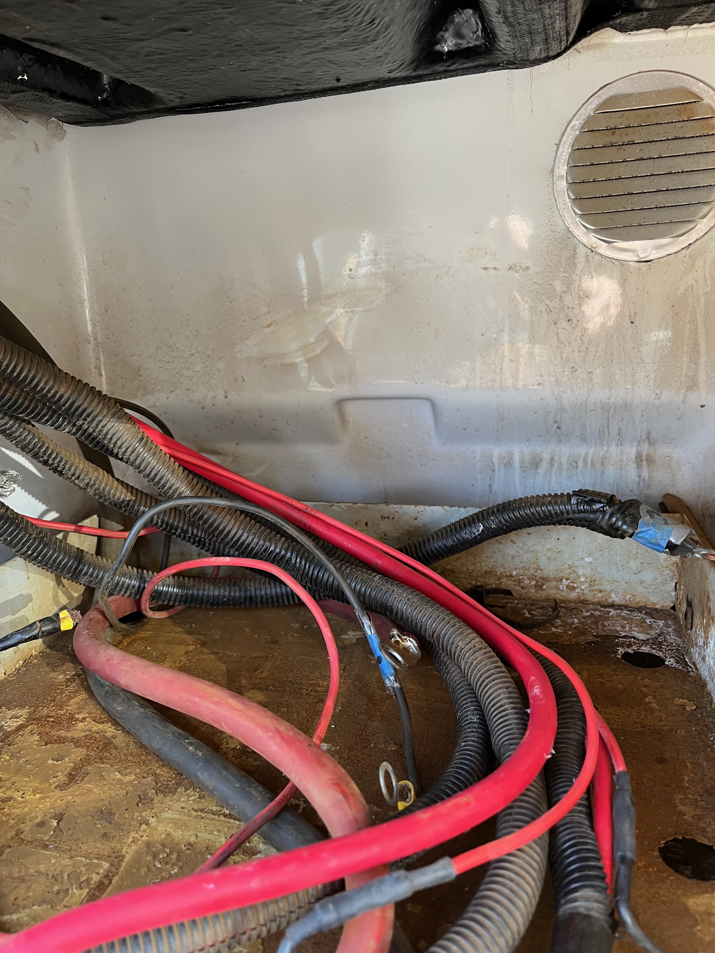

Working on my electrical upgrade and in need of some advice. What should I do with the wires coming into the battery box (see pictures) that I no longer need? I have identified the ones to keep, but what should I do with that mess of others coming in from the left? Cut and cap them from the underside where they come into the box?
And does anyone know of a way in which I can use the old 2 awg wire that went from the Blue Sea ARC inside the engine bay to the Battery Box as a snake of some kind to find a good path for the new set of 4 awg wires that will now run from the Start Battery to House Battery Box?
Any and all help welcome.

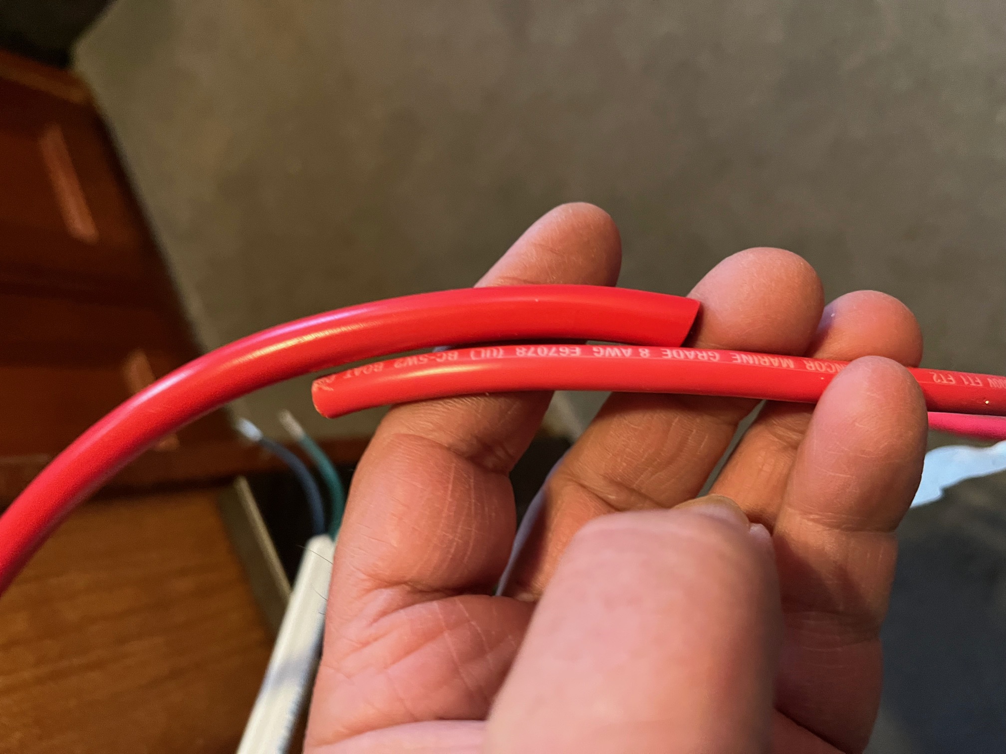

Re: Batteries and Charging

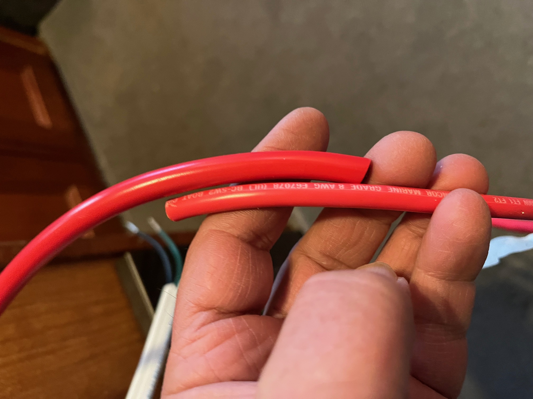

deppstein wrote: February 19th, 2025, 2:11 pmFYI, I discovered that the Distribution Board will not take anything larger than 8awg coming in from the batteries--so I will use a step-down straight connector (6awg to 8awg) to attach a short run at end of this line to the Distribution Board.
Just as another option: If 8AWG has the ampacity to cover your main fuse (that's going to fuse the 6AWG run from the Safety Hub to the brown box - sorry I forget what size fuse you are using), you *could* just nip a few strands off the 6AWG. I know that sounds like a huge cheat, BUT..... a bunch of unneeded joints isn't great either, and IF the 8AWG has the ampacity (or you fuse to meet that), then you are only running the 6AWG for voltage drop (usually the case in 12-volt systems). Having 3/4" of 8AWG won't materially affect voltage drop in the slightest.
As I remember it, the brown box has one of those "shove it in and screw it down" sort of connectors. You could consider using a ferrule, but that's independent of making it small enough to go in the hole.
