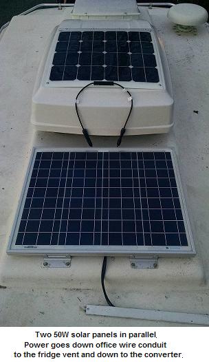

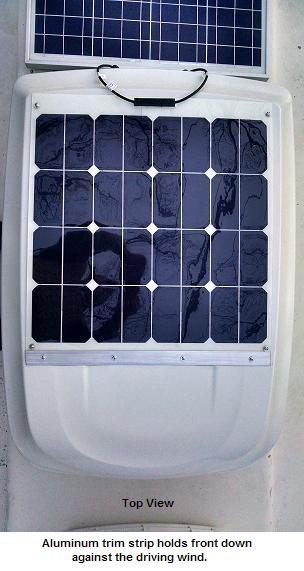

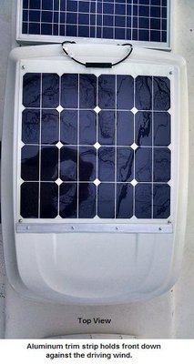

caconcourse wrote:By way of warning, the panel on the AC shroud is the second one I installed. ... the (first) panel blew off in a raging wind. It was attached with small screws and a strip of packing tape. The new replacement is held down by 4 3/8" nuts and bolts through the shroud, along with some 3M VHB (very high bond) tape along the front edge and a couple of places on the sides and back.
Just wanted to thank you for the idea of mounting a flexible panel on the A/C shroud, and also for the wind warning :)
This afternoon I added a second 50W panel to my 1994 Concourse. (I'm saving both roof sides for walking at this point - that's why it's dirty in this photo - grin.)
Two 50W solar panels mounted on top middle roof layer
Keeping your advice in mind, I used bolts & washers instead of screws, some silicone adhesive, and an aluminum carpet trim piece at the front to act as a wind break and to help hold the panel front down. (There is clear silicone in the slightly open areas under the front trim to stop wind and rain from going under the trim.)
50W panel on A/C shroud from front
50W panel on A/C shroud from top
I was inspired not only by your post, but also by reading about how much even small shadows from roof vents drop a solar panel's output. Obviously a panel on the highest point makes extra good sense.

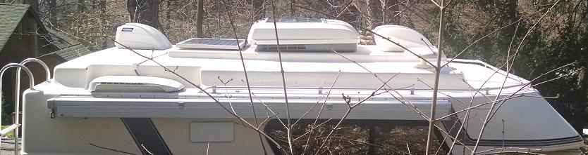

So last... a side view, to show how thin it all is:
Don't forget that you can click on an image to (usually) make it bigger.
And sorry about the branches in the way :)
