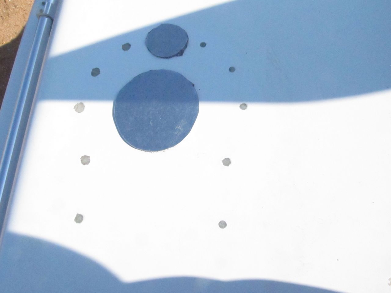

I chamfered and then patched the horseshoe of screw holes with neat, then thickened epoxy. These holes are small so don't need patches other than the thickened (with structural filler such as colloidal silica or structural thickener powder). I won't go into detail yet in case you already know epoxy or plan to do something else. This can be gelcoated or painted over after the epoxy has time to cure (I use tape to protect it from UV during this time period, as epoxy is vulnerable to UV).

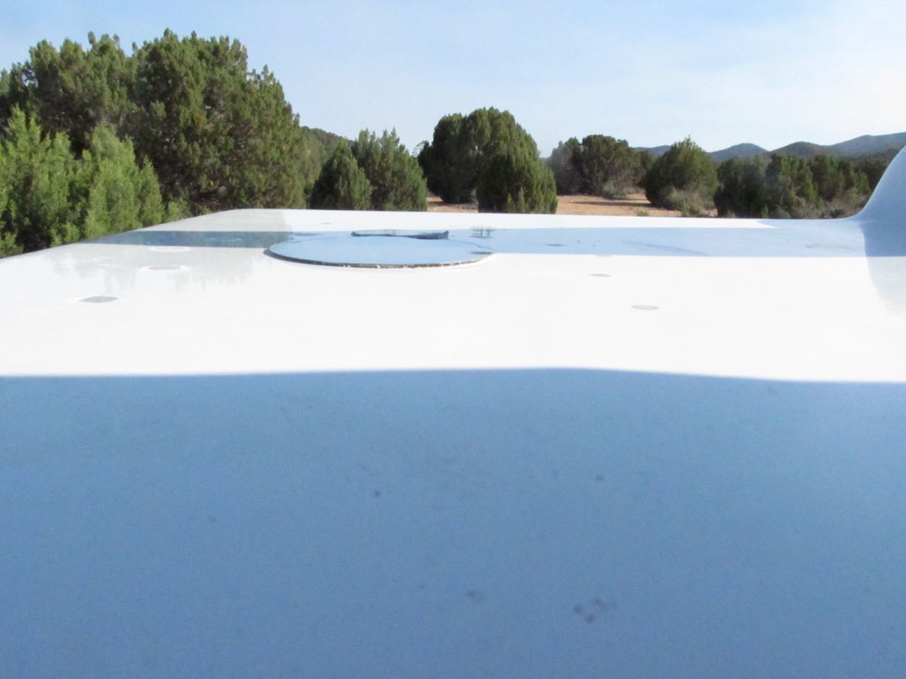

The two larger holes I thought I would probably use for running solar cables into the rig, so I "temporary long term" patched them with watertight but easily removable patches. These consist of circles cut out of thickish galvanized flashing (bought in ~30" x 36" sheets at Home Depot), and affixed with butyl tape. They have held up incredibly well and no leaking, yet easily removable and a bit of mineral spirits cleans it up without undue hassle.
Here are two photos of the roof after I epoxy filled the smaller holes and "long term temporary" patched the two larger ones. As you can see the epoxy filled holes are completely flush once trimmed (sharp chisel during green stage). The one galvanized patch I have not rolled down yet, so you can see it sticking up slightly. The solar down wire fitting I'm planning to use will fit the original larger hole so there will be no more patch, and then presuming I don't use the smaller/larger hole, I'll patch that as well (for real with fiberglass/epoxy).

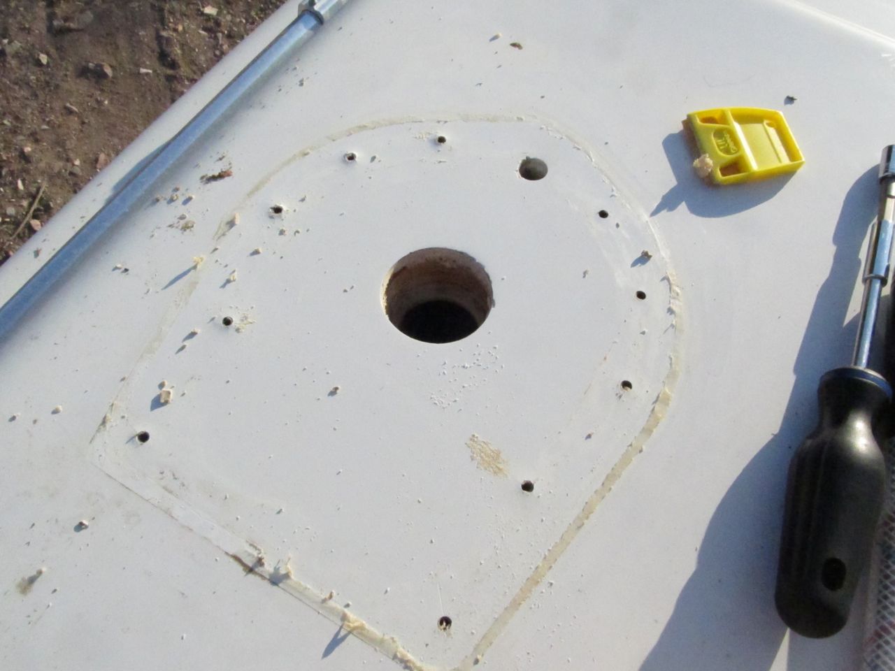

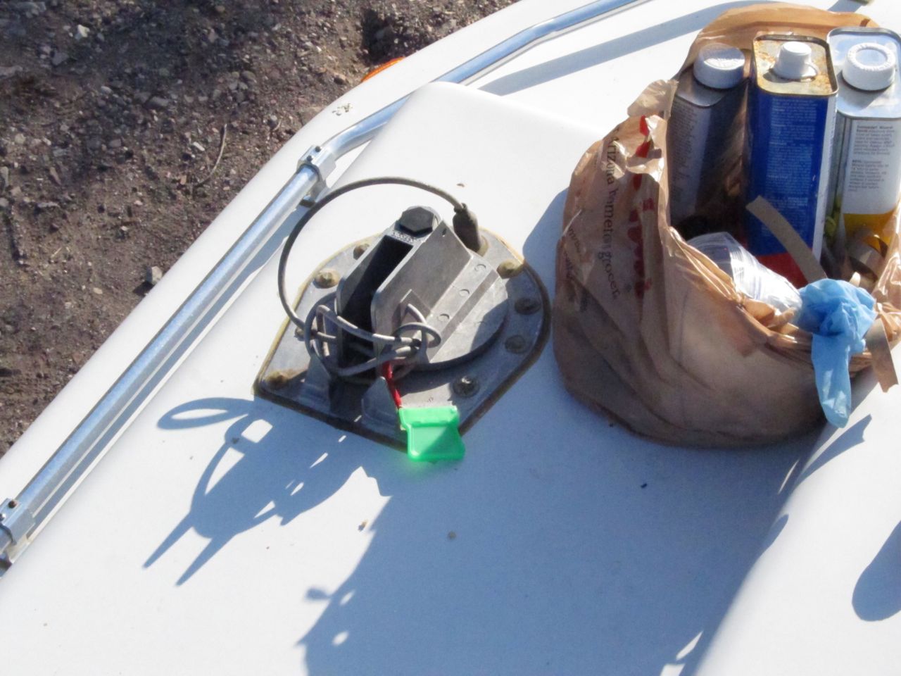

Glad it's of use. I ran across a couple of more photos.
Here I'm mid-removal. Just shows things after the big crank-up section is removed.
And here is the roof just after removal. You can see that they didn't pre-chamfer the small holes for the screws, so they had "ruffled up" the fiberglass. Hence I chamfered them (and removed any small bits of cracked gelcoat) before filling them with the neat-then-thickened epoxy. BTW the razor blade you can see just at the corner of the below photo is a plastic "razor blade." They are very handy for working on fiberglass or other surfaces you don't want to scratch. This one is orange (the blade). There is also blue and yellow (slightly different properties to the plastic).

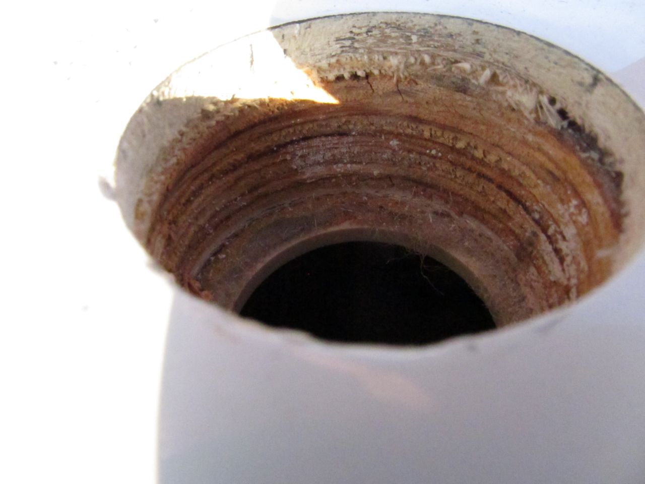

And here is the interior of the largest hole (where I will likely run my solar down wires). Shows the fiberglass roof skin, two layers of plywood, then the inner fiberglass skin (which the overhead carpet is attached to). This is the hole where the round "arrow" thingie is in the upper cabinet that has the crank handle in it.
