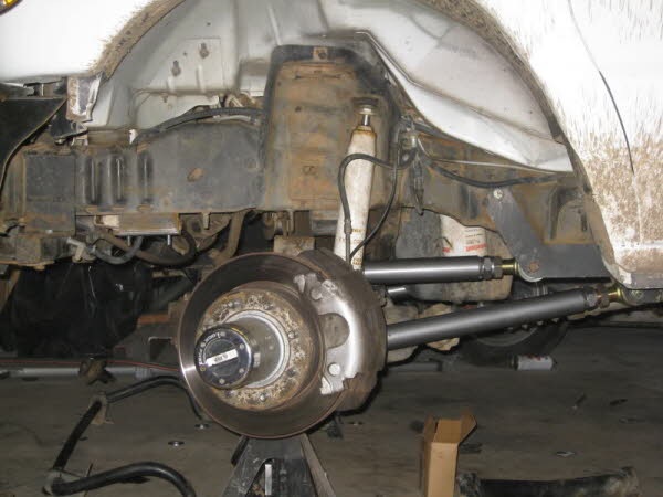

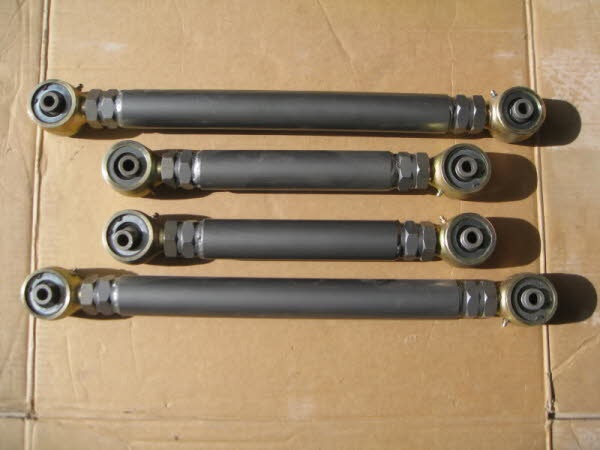

Regardless though, I think I've found my 4x4 conversion. Colorado camper van conversions in Drake, Co.
http://www.coloradocampervan.com/4X4_Co ... rsion.html
They(He?) do coil springs instead of leaf springs and even offer the ESOF button to engage the hubs. Though, you still have a transfer case lever. Derek explained that part of the adaptation from F350 to E350 was a pain and problematic (I.e. Expensive I assume.. And since I'm in a bit of a budget.. I didn't push the issue.. A lever is fine as long as I don't have to get out of the warm van to lock hubs in the snow. Not that it's a huge deal.. But nice.
http://www.coloradocampervan.com/Suspen ... stems.html
Some custom control arms seems cool to me too (pretty much everything else is stock ford I think)

You're pretty much right on the money on all accounts. I opted to put a deposit on having mine converted at Colorado Camper Van conversions. It does require me to get bigger wheels and tires too. It's a coil spring conversion rather than leaf springs. Comfort is more important to me than durability. I'm not going to be doing off roading, I just want to safely get through snow. For no additional cost he is installing a switch to lock the hubs. They can be done manually too if they become problematic. It will still have a lever for the transfer case though. He says the electronics/labor needed to get rid of the lever is costly.
