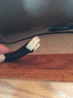

Got a question. In the overcab space of my 2002 Destiny 2400 there's a wire on the left side with a funny plug on the end of it which I've pictured. I'm trying to identify it, looks like a 12 volt line, It appears to've attached to a four-pin connector of some kind on the back of some device.
On the opposite side of the same compartment there's a similar power line with a plug on its end with a two-wire connector. Again, it's suspected of being a 12-volt line. Both have attachment clips on them. Together, these probably are great sources of power for 12-volt tv's, etc, especially if I can locate their fuse numbers.
I know that many of these mh's have had multiple tv's, receivers, cd/dvd players, etc, over the years and I suspect that's the reason for these being there. Anyone know what these attached to originally?

That looks the same as the connector on the left side that went to the KEC brand 12v TV that came stock in my 2004 Premier. Although the connector appears to have 4 pins mine only had 2 wires (black/ground and red/hot) going to it. I quickly replaced that TV with a flat screen and used those wires to power a 12V outlet in the overhead. The VCR on the right side had a similar 2 pin connector I used to power the Double Din DVD/Radio I replaced it with.

Great answers, both helped! :) It's great to have two unused 12-volt leads up there, of course, especially so as I'm getting ready to get rid of the 120 volt, generator-required tv. I guess I'll pop in an inverter to power the DISH receiver, they don't seem to take much juice.
