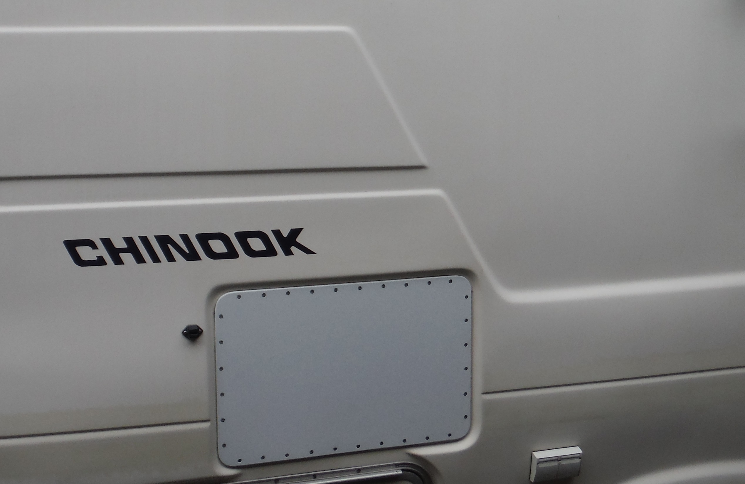

Blank-off for the lower intake. Just a slab of 1/4" PVC. I left the upper fridge vent for all-weather passive ventilation, which is sometimes nice, sometimes not. I like fresh air, so it's usually a plus. I might block it off and devise something that will allow more control.

Like Scott, I've made a plate to close off the external side vent (notorious for leakage problems, and not just due to poor bedding). My plate is about the same size and shape, only difference being that I made mine of fiberglass board and have an internal fastening system.
