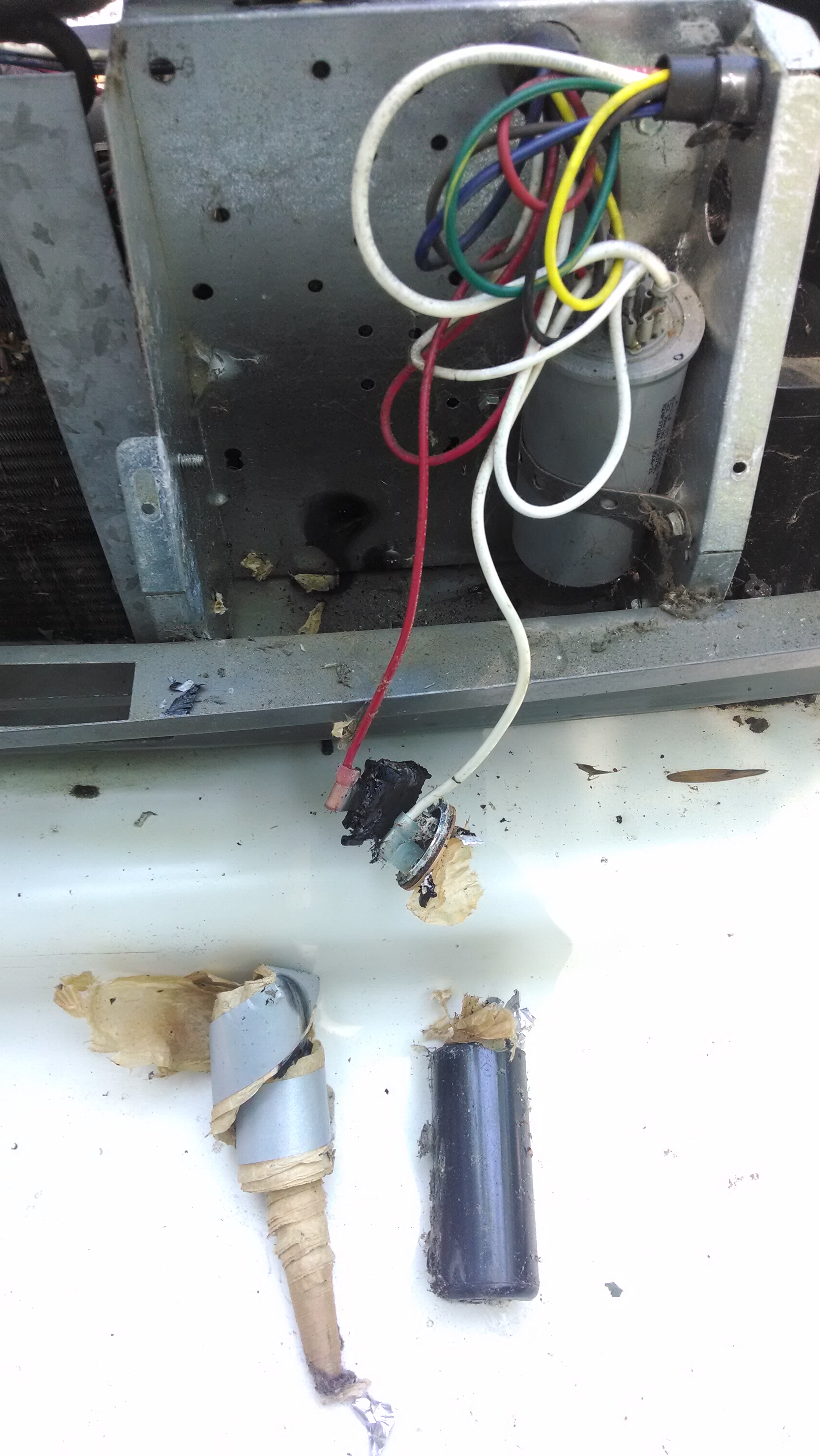

So I climbed up on the roof today with a meter to test it, opened the top of the AC and the metal shroud surrounding the capacitors and pulled out this mess:
Start capacitor insides
Top of the cap was off, with paper and foil guts everywhere. I think it qualifies as a blown start capacitor :-)
I ordered a new one off Amazon for about $7. Should have it in Monday and I'm hoping that's all I'll need.

Well that's conclusive. Jeepers.

No need to troubleshoot or safely discharge this one with a voltmeter; looks like a stick grenade went off. Seems the relay attached to the red wire is still serviceable?
Some internet gurus recommend replacing the run capacitor at the same time. I believe it is the larger one in your picture. They also talk about benefits from a “hard start” capacitor designed for the increased torque with newer freons. Probably best to stick with the original specs.

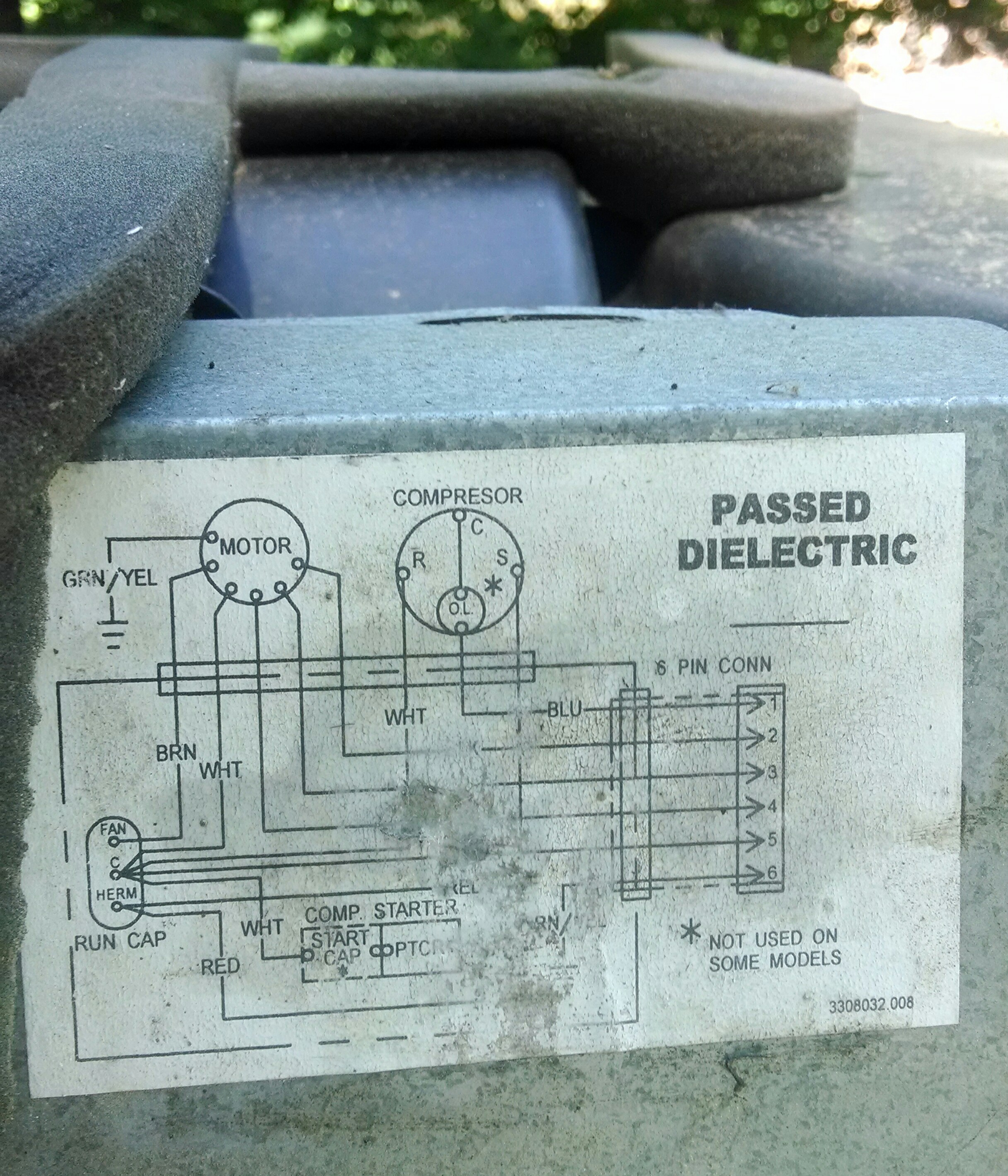

There was a paper circuit diagram of the capacitors section on the metal shield.
As usual, I decided to take a photo of it and upload to my private Pinterest board so it would be available to me for later reference.
But, stupid me saw some dirt on the diagram. So without thinking, I dipped my fingers in a roof puddle of rain water from the night before, and used it to try to wipe the dirt off the paper.
Uh, nope. Water + paper = shredded paper where I wiped. Idiot.
Fortunately I was still able to see most of the diagram, but man I wish I had not sprung into cleaning action so fast.
Grrr. Presented as yet another cautionary tale in the hope that my mistakes will save someone else :D
Update: good copy of the circuit diagram:

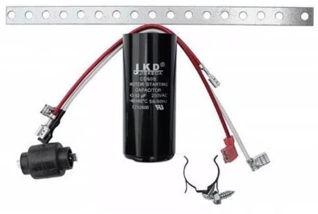

As for the AC, after first searching for a low profile replacement model (I don't want to be higher than my current 10" Penguin), I started reading up on why start caps blow.
One reason a compressor can lock is if power is lost while running, due to temporarily too much pressure differential for it to start again. Remember thst I mentioned that storms had come through, and I'm sure the power glitched a few times. So I waited a few days for the pressure on each side to equalize, installed a $33 Dometic Hard Start cap kit, and yep... she fired up just fine and has been running all day. Yay!
Dometic Hard Start Kit
Downside is that such a lockup probably does reduce overall lifetime, and my newly built-in AC power meter says it pulls more amps than it did before. But I'm okay with not spending $500-800 for a full replacement unit right yet :)
