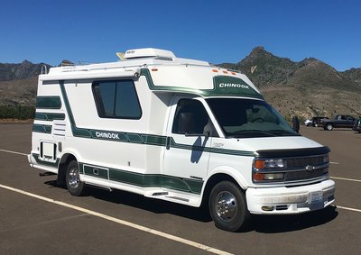

I am just getting acquainted with my new (to me) 2001 Chinook Destiny. We have taken it on one weekend trip and will be going on another in a few days to find someplace dark enough to watch the upcoming Perseid meteor shower.
I have been reading the board archives to find out how others have dealt with things I hope to do, like towing a trailer and setting up a rear camera. I expect I will have a few more questions as I go along but for now, I will drop in, say hello and try to keep the Chinook banner high.
And the name? Rocinante was Don Quixote's horse and for some reason, that is what my wife decided to call the Chinook.

Hi and welcome! I like the green - will look great in camps :)

Welcome Jim. Great looking rig. (I've always been more of a GM guy but always had Ford chassis motorhomes) Sounds like an ambitious list of upgrades. Look forward to more pictures. The name of my Chinook? The Chinook. ;)
