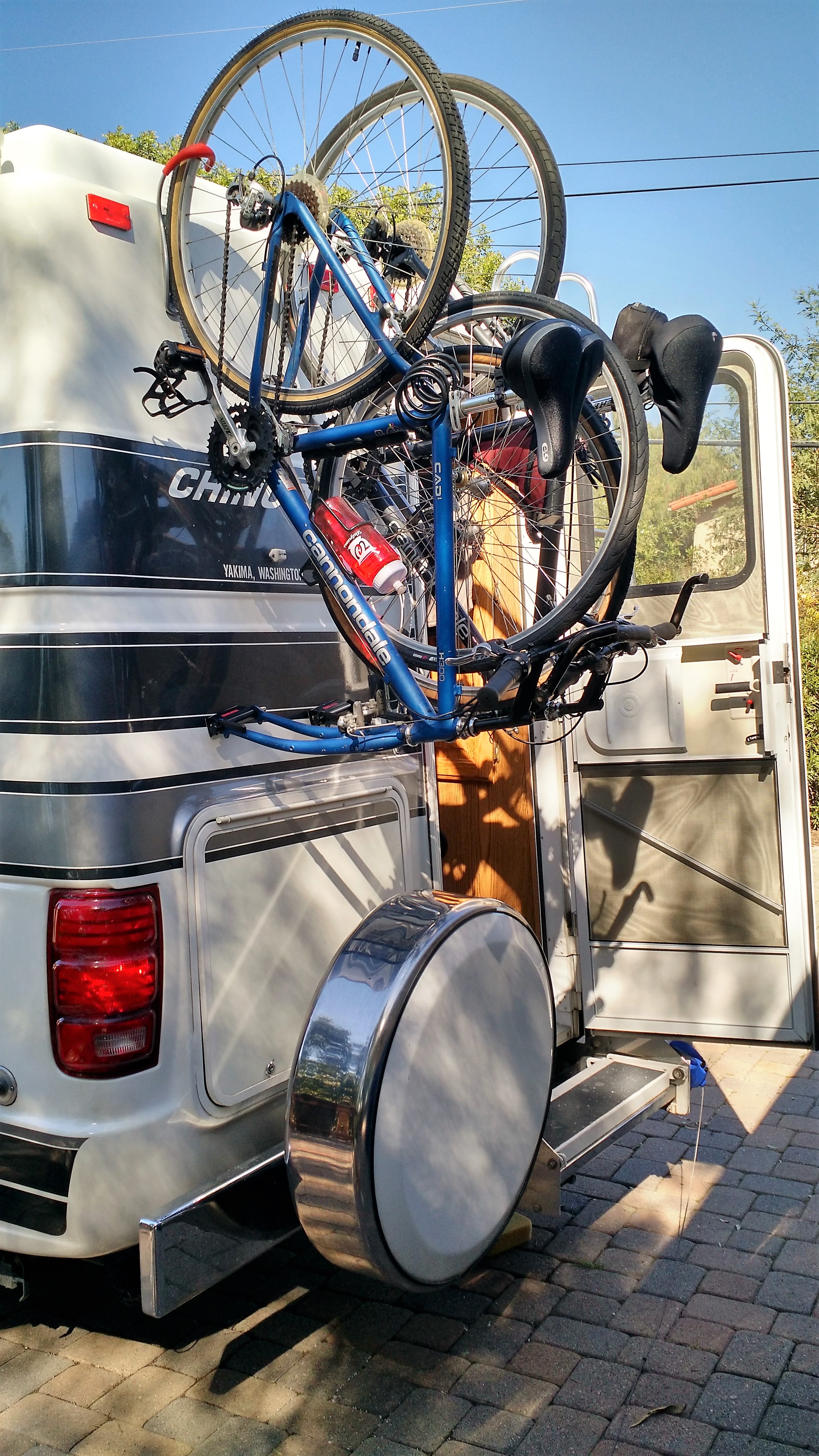

This is where we carry our bikes with the rear door (shown open).
I made the racks using a pair of bike wall hangers and a pair of Yakima fork blocks. We tuck the front wheels in between the bikes and hold everything with velcro straps. The forks are tilted slightly so the two bikes can be mounted closer together since the handlebars don't interfere.

That is a nifty solution! I've never seen garage bike hangers like that - only the screw in J style. And you can even probably make (or have made) something to hold the tire locker door up to the handlebars when accessing that :D (Later tire lockers open down but our era have the hinge on top.)
Could you elaborate slightly on how you mount/hold the front wheels?
Also, did you make an access plate in the shower to get to the backside of the upper hangers? Or?
Glad you showed that. Now maybe grantcln can go with a rear door as an option.
PS: Came back to add a question: Can you get the rear wheel up to the hooks from the ground? Or do you stand on the step or a stool? (Or are you 7' tall...)

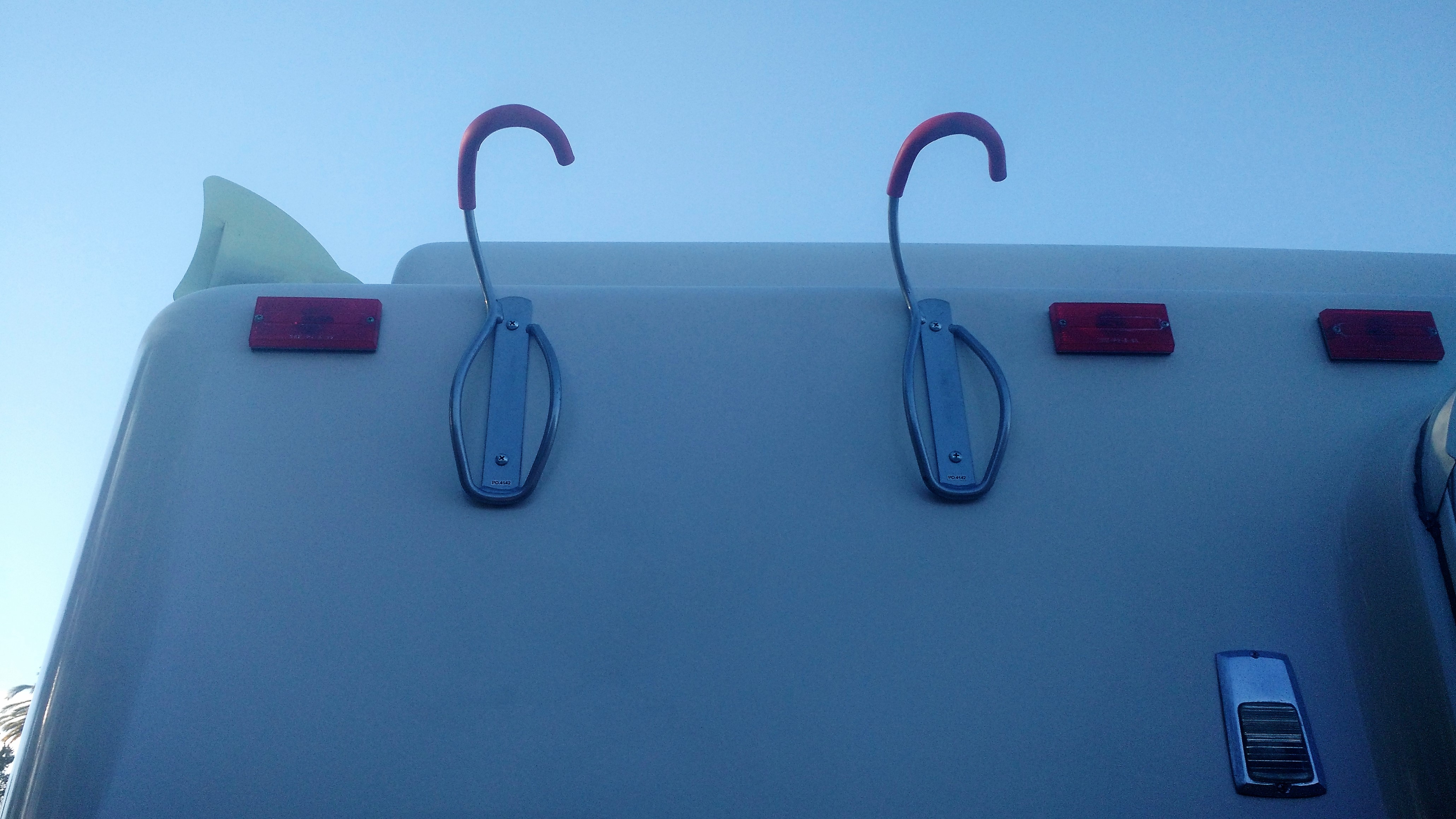

The top hooks are mounted with 3M very high bond (VHB) adhesive tape and the supplied screws. The tape provides the bonding and it is incredibly strong. We snagged the bikes on a dump water hose once (ouch) and pulled so hard, it bent the hook and broke the bike wheel. The bond was not affected in any way. When I had to remove the bent hook, I cut the bond with a razor, but got impatient and pulled the last bit, and it actually pulled off some of the gelcoat! (ouch again). I repaired the gouge with marine epoxy, but it is hidden under the replacement hook. the bent hook was so strong I could not straighten it, even with a vise!

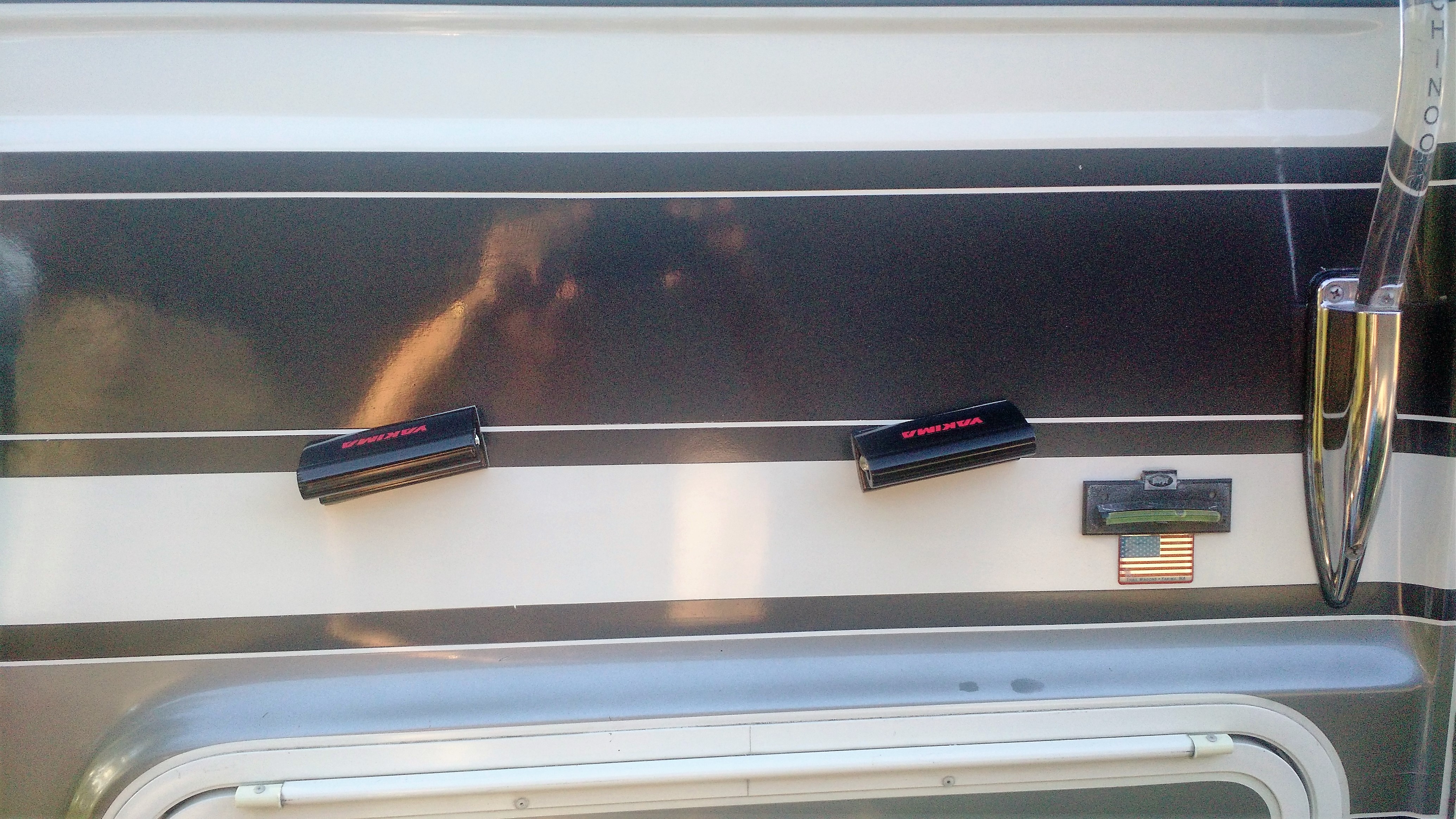

The fork blocks are also mounted with VHB tape, but also have carriage bolts with washers and nuts inside. The forks are turned inward and mounted "upside down" in the blocks, which makes the mounting much more compact by reducing the height. There is a cavity formed above the handlebars and between the rear wheels where we stuff the front wheels.
We use Velcro straps to tie the front wheels together at one point (the top), and then strap the bottoms to the handlebars and frames. We strap the two handlebars together, so both bikes and front wheels all act as a single mass attached to the wall, so it is very stable. We carried the bikes for over 20,000 miles with no troubles, other than the aforementioned water hose snag, and a couple of fabric covers shredded in the wind. We also strap the pedals to keep them from rubbing against the walls (lesson learned).

I can mount the bikes standing on the ground (I'm 5' 10") and it's not difficult. There is a twisting motion to get the tire on and off the hook, which is a little tricky at first. I have more confidence in the top hook holding the weight (after "the incident") so I don't worry so much about getting the forks in the block before releasing the weight from my arms, which makes it a little easier to load/unload.
