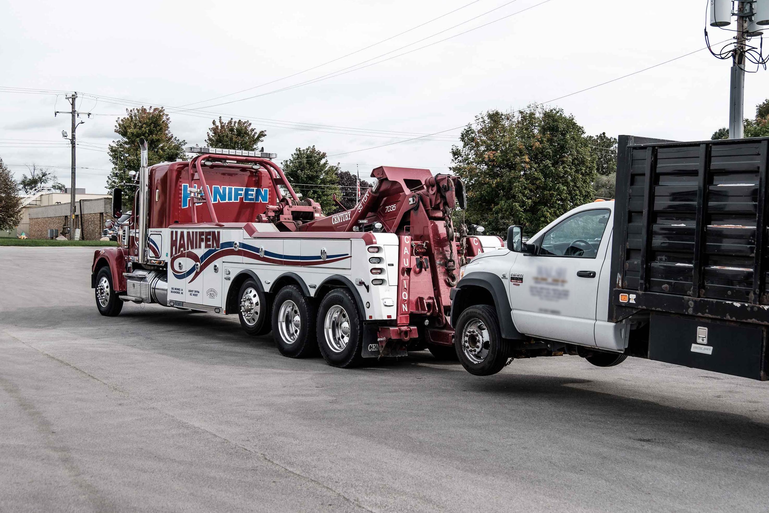

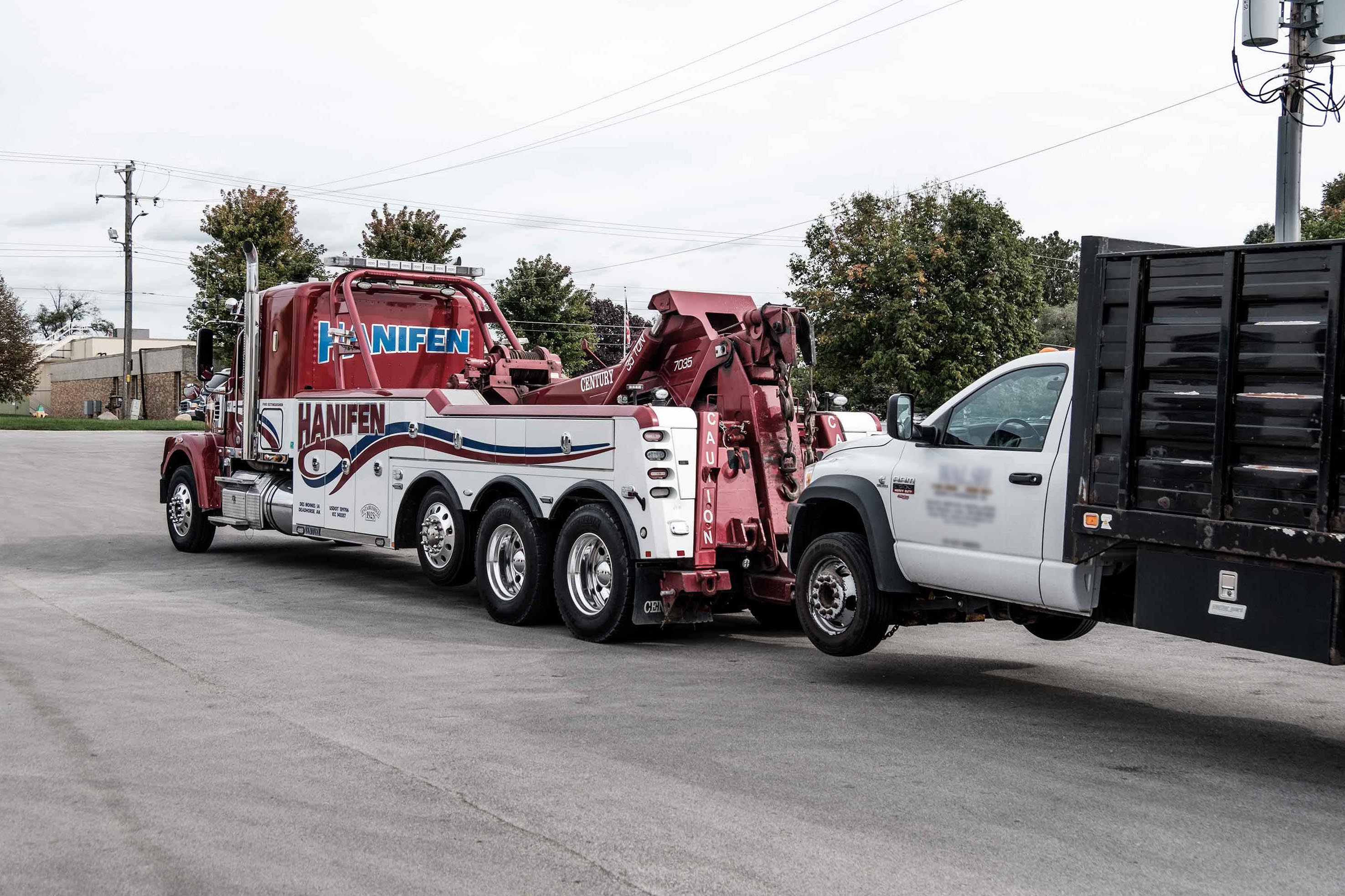

Believe me, both the previous tow trucks tried front and back, the first was a flatbed and the second was a regular normal-type beefy towtruck.
Tried the flatbed rear first, but by the time you get a cable under it and start pulling, it drags against the rear before the tires get close to the bed to start going up. The rear overhang was just too much. We did have a bike rack off the hitch, but it still wouldn't have worked without it.
Yeah, Geico cancelled the road service, but on the other hand they didn't argue the bill, and I think they might have had to pay the first two trucks something, and I saw something like a $300 bill on the last one that actually did the tow. Those super flat-tow trucks are expensive (I think there is a name for them, but I can't remember what it is).
Actually, it might be called a Heavy Duty tow truck or wrecker (wrecker is sounding familiar). Oh, and they do normally tow using the drive wheels, but the rear overhang, again, was too long for the truck to get its fork-lift thing far enough, sigh.
It looked like the tow truck in this picture, towing the white garden-type truck (I just found the image using google, but mine looked very much like this one).

Good to know (well, err, sort of). I notice they are pulling the stake truck by the front wheels as well. Maybe also because of an overhang.
I can think of one other way a flatbed *might* work, but then I haven't tried it. That would be a method I sometimes use if there is a sharp dip that I need to get past. So what if one went stern first, and then used an inclined plane (ramp) made of Lynx blocks to gradually approach the flat bed? That presumes their cable is long enough and that they are open to options.

What BobW9 said ^^^^^ I needed my Chinook towed 30 miles at highway speed when the fuel pump went out. I knew better than to rely on some generic roadside assistance company and went with a service who specialize in recovering tractor trailers off the freeway.
They immediately understood my needs over the phone and dispatched a truck with hydraulic lift that scoops under the front tires like the photo shows. Absolutely - the driveshaft must be removed to avoid transmission damage!
I saved some time and money by doing this myself and laying the shaft inside. The four bolts attaching the driveshaft to the differential are indeed a chore to remove without an impact/air gun. I persisted with hand tools (12-point offset wrench) and fortunately the Chinook has enough room to lay its driveshaft inside. I was later admonished for soiling the fine carpet :roll:
