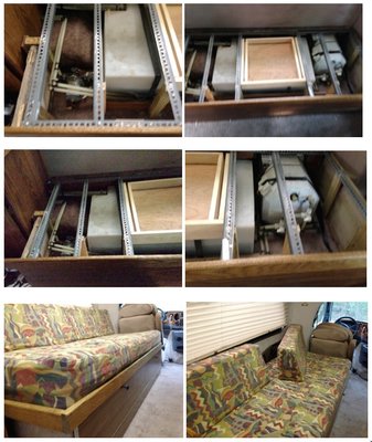

I guess I'll post here as things progress. It will take a while to be completely done, as I am moving my batteries inside, under the new bed, next to the fresh water tank. And will also have the fuses and switches along the bed, just above the batteries. Assuming everything works out
The bed has a 7" storage layer under it, above the water tank/heater. It makes the bed/couch taller than the dinette cushions, but I really, really, need this space

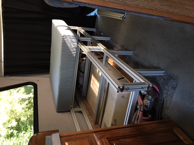

I am using the 8020 Aluminum rails that have been mentioned before in the forum somewhere (that's how I got the idea). I really like them, though it does get expensive. I am using the 1.5" rails, with lots of supports. A friend of mine laughed when he saw them last week, though he admitted that he also likes to over-build things like this. I am paranoid regarding the bed weakening one day from all the travel vibrations, or my girlfriend and me playing on it, and crushing my fresh water tank, water heater, and/or batteries! Not to mention the weight of the tools and things I'm probably going to have under the bed in the new storage area.
Progress update on couch/bed. Looking good overall, making adjustments currently. The couch was secured with a 1/2" thick bolt, and yes, the bolt does go all the way through the floor and has a washer and nut under the chassis, and it takes two people to remove the bolt. In my case, the bolt, nut, and washer, was very rusted and it took hours of holding, banging, multiple wrenches, PB Blaster, and sweat to get the two bolts off! I need to get brackets that I can use to bolt to the floor, or modify the brackets I have, for a larger bolt hole. One of the current brackets has a slot (to allow adjusting where the screw will be tightened), and I don't have a drill press to force the drill bit steady in the middle of the slot to make the larger hole.
In the picture you can see the 7" storage level, and one cushion laying on top to give perspective. Once I've adjusted all the rails just so, then I need to go buy plywood for the storage layer and bed layer. The couch back is not in the photo, but it came out too tall, so I will be cutting about 3" off it, and rounding the top edge just a couple inches, so it is more comfortable leaning against it. It will slide into the aisle when sleeping, probably held up by a small bench. Other than that, I like the cushions.
You can see on the left along the wall that I'm using the 2x4 wood beam that was already there for the original couch. I'm thinking that I may have a version 2.0 in a month or two, replacing that wood beam with a 8020 1.5" rail, as it will make it easy to more perfectly line up the rails on both sides (you can't see in the photo, but it is off being level by a slight amount).
Or maybe I'll find that I don't notice it and just leave the wood beam. Note that the beam was held up by just two 1.5" legs (and they were shaved thinner at the bottom!), plus all the screws that hold it to the wall (which is a 1/4" plywood panel I found). I added another two 1.5" legs under the middle of the beam for more support. I have photos of that for another time.

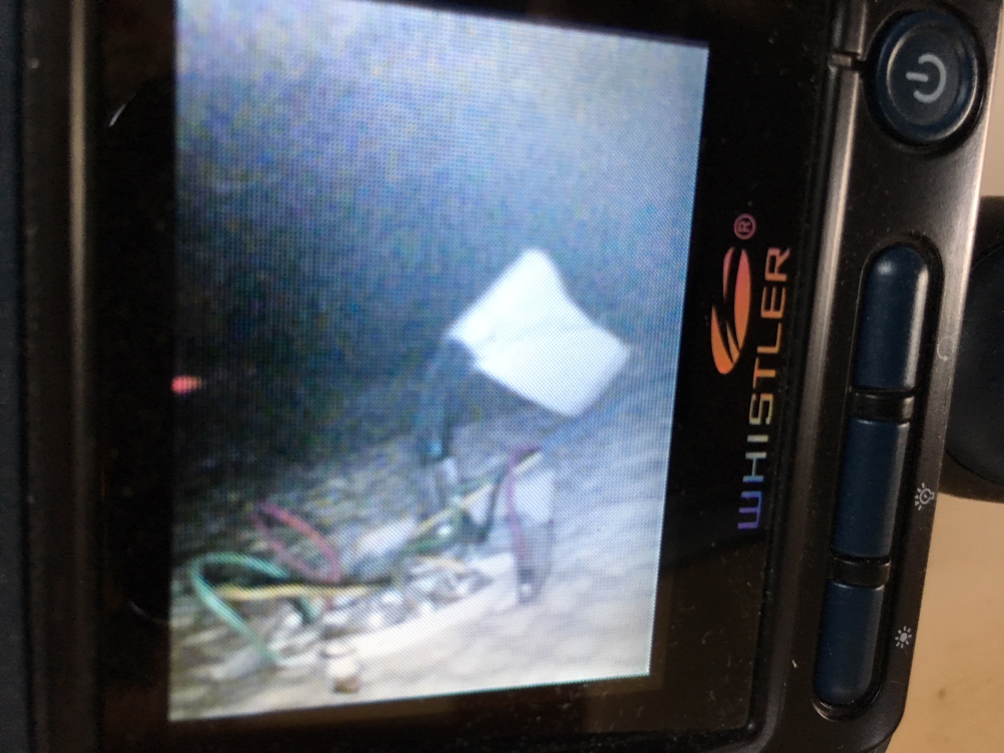

The 2nd photo I just had to show, as it is a weird electrical junction attached to the back of the plywood wall, completely inaccessible, only visible using a flexible wire camera for seeing in walls. Could get any clear photos, and, from what I can tell, only way to get to it is completely removing the entire wall.
The photos are sideways in the posting, but if you click on them they come up correctly.
