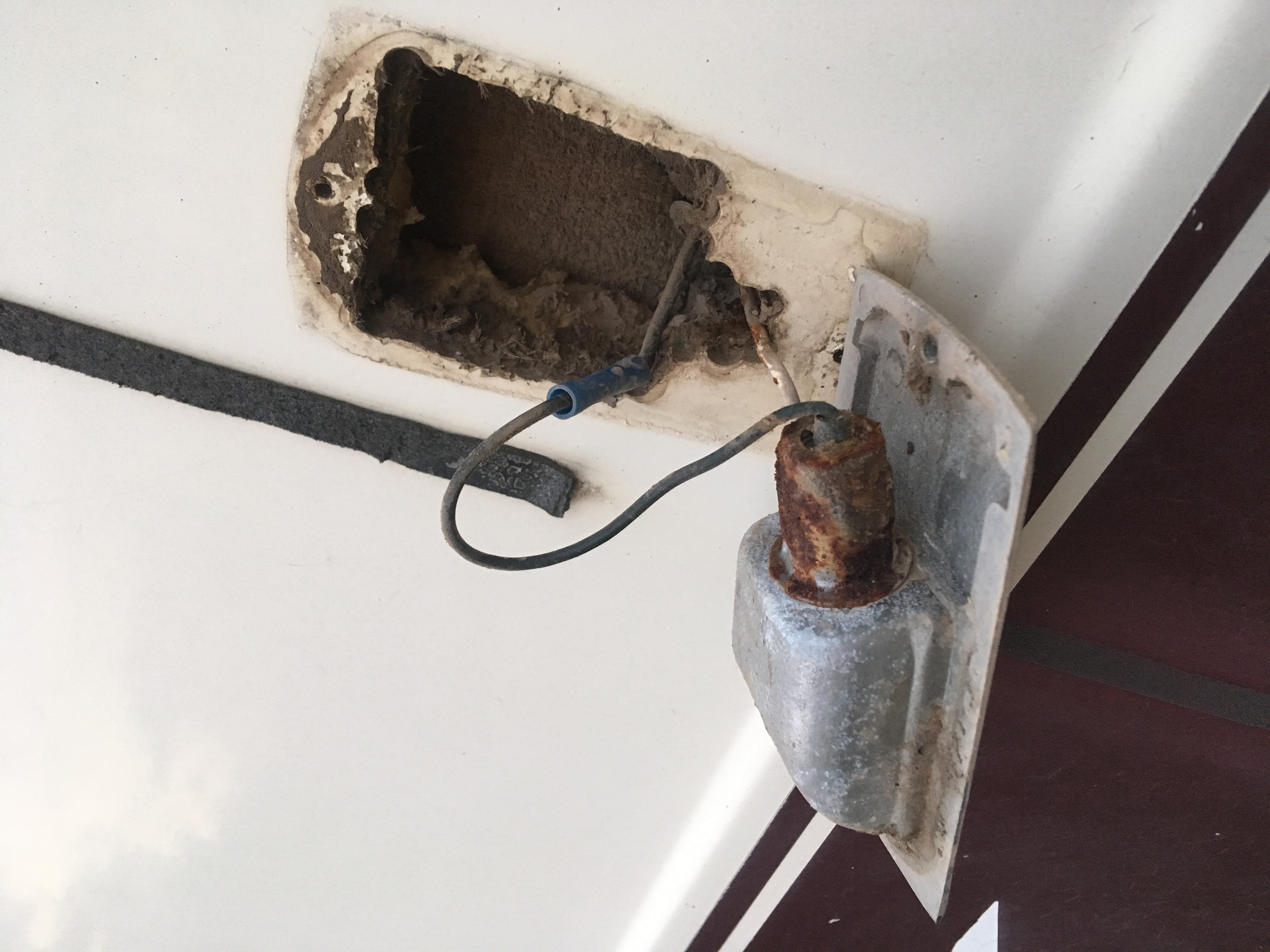

Thank you, you are correct. I just found out the dump light underneath actually works! The others are in rugged shape. See pic. I need to find an LED replacement.
