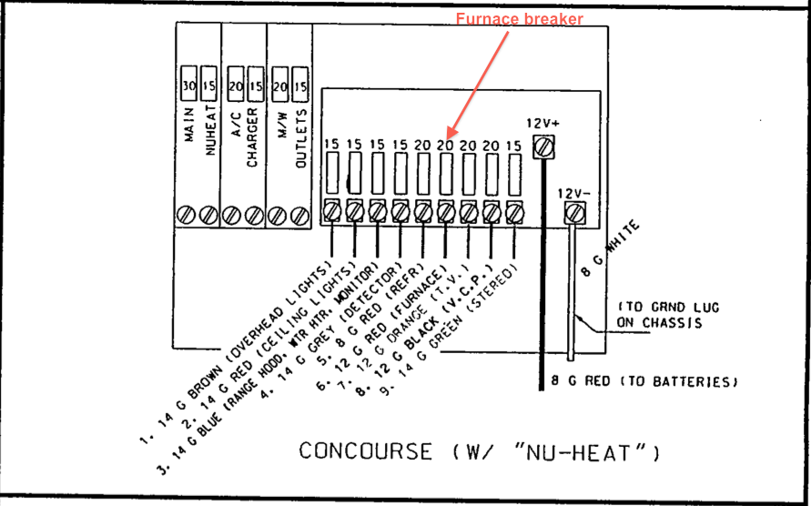

The furnace fuse is in the "brown box" that is by the floor on the end of the sink "ell." The top half of the door flips down.
The DC fuses are on the right side. The furnace fuse is the sixth one from the left, should be 20 amps. The wire coming out the bottom of that fuse position should be 12 gauge red (for a double check).
Here is the diagram from the 2000 manual:
There is one diagram for with "Nu heat" and one without. I'm showing the one with. The only difference is on the AC side (left side) where you see the two breakers next to each other labeled "Main" and "Nu-heat." In the non-nu-heat model there is just the one Main breaker in that same area. No difference on the DC side, which is where you are going to find the furnace breaker.
Click to enlarge:

I just got home from a dinner meeting and read these posts. It's dark and cold outside but I just had to go out and look at the fuse box.
Lo and behold! NO FUSE in the #6 spot!
I was going to take the rig in tomorrow for diagnostics, but now I'll be buying a fuse instead. Hope it works!
