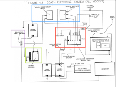

Here is a page from the 1998 manual. Even after you click to enlarge, it may be a bit blurry, but the original entire manual can be downloaded from our "reference" sub-forum here, and should be of better quality. Since your rig seems to resemble a 1997, and since the 1998 is very similar from what I have seen, I think you will find it very useful. Great diagrams of all the systems (electrical, plumbing supply, drain/waste/vent, etc. Plus tank capacities (which are nearly accurate) etc. Here is a link to the manuals thread. The 1998 manual is a link in the very first post.
viewtopic.php?f=6&t=279
In the below diagram, the part in the red box is the LVD. The left-hand facing side of the LVD on the diagram is the top as it is fastened to the pillar in the coach. The blue box above that represents the "over the shoulder" switches by the driver's seat. The green box is the battery combiner under the hood (presuming you have that too; it's a Sure Power 1315 and is on the driver's fenderwell, although they must have had a trained mouse to install it - it's buried in there. You may want to look for the serial number on the combiner, as some were recalled due to fire danger (mine was). The purple box represents the 80 amp breaker for the generator start wire (again, if yours is like this). If you raise the hood and stand facing aft and looking at the start battery, then look up to the "seam" where the back of the hood meets the body, you will see it if it is there. A black breaker about 1-3/4" x 2-1/2", with a red button, and held on by some perforated metal strapping. (Later models, after around 2000, used the house bank to start the generator, thus shortening a wire run that is considerably too long and skinny.)
Here is the Sure Power combiner (formerly) on my rig, on the driver's fenderwell. This is without the cover piece on it. This has the green box around it on the diagram.
And here is the generator start breaker, top center in the photo -- the one with the purple box around it on the diagram. BTW, not a great arrangement on the positive post (terminal stacking). One of mine was just about torn through and making bad contact (I have since changed it).
