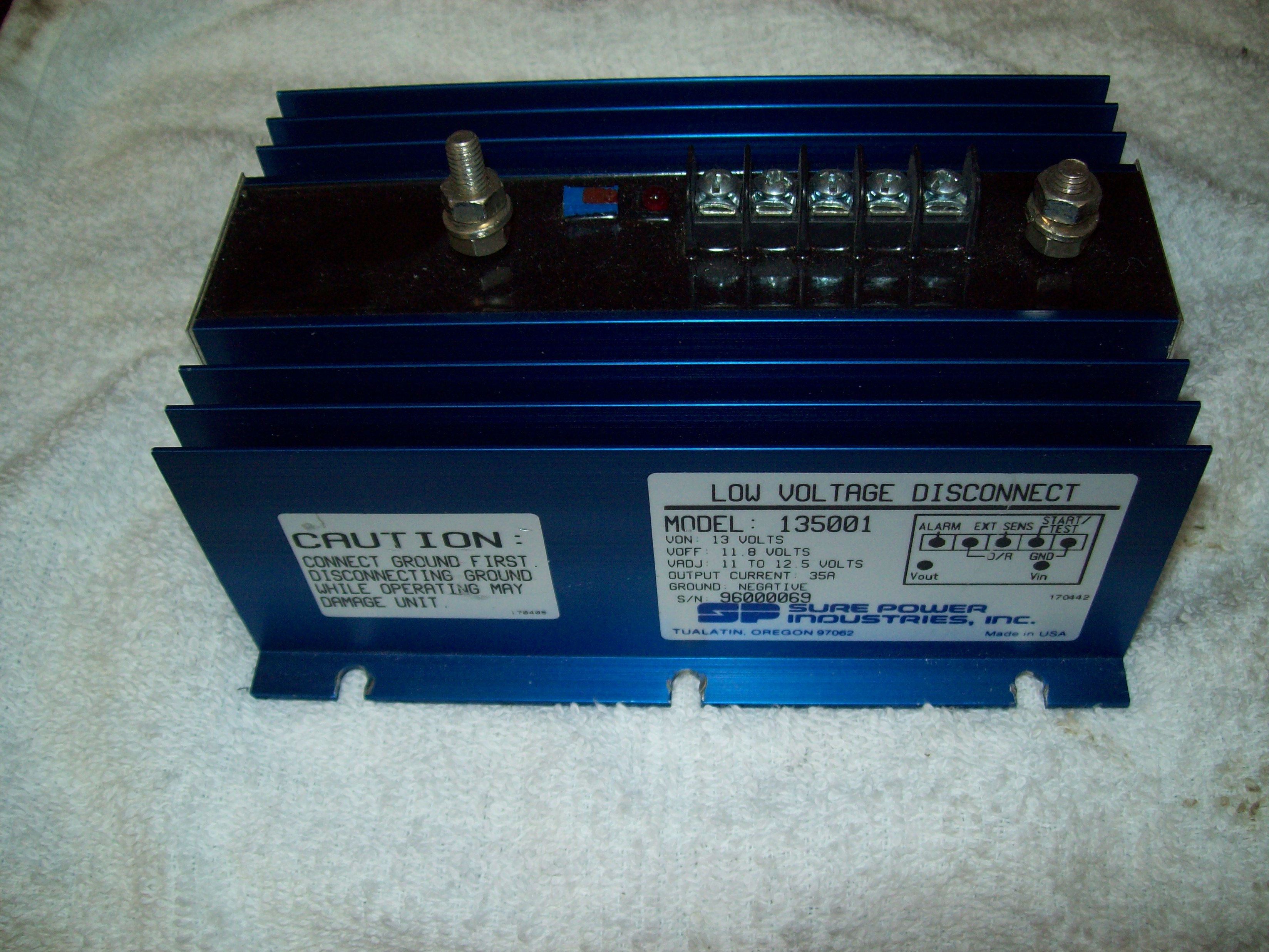

After working all those years the wife and I retired and bought the long awaited RV. We bought a chinook from a fellow across the country who advised it was in perfect working order, low miles, etc. So we fly in to pick up our new purchase and like most things, it was not quite what was described. Here we were miles from the airport and working with a complete jerk, so we decided to make the most of the situation and drove the new purchase back across country. One of the missing components was the sure power LVD. I have looked everywhere that I can think of to try and find one to keep the RV original, but have had no luck. If anyone could help me find one I would be very grateful....

Now, on your LVD. I somewhat mentioned this before, but...
First of all, I will say that Chinook built a pretty good RV (one reason I have one!). But they were not without flaw, AND (more importantly) electrical systems back then (even "good" ones) were a far cry from what is considered good today. In other words, while you are welcome to put it back to original, it's maybe a bit like saying "I bought this old house, and I'd like to find old newspapers and horsehair insulation to put between the walls to keep it original." The house may be a great house, and may have been built to a high standard, but knowing what we know today, few would choose to do it that way. And if it had been removed, one might want to choose something newer to put back. (Not that I don't have respect for old things; but old electrical is not quite the same as an old growth mahogany bar or the like.
I'm not where I have my removed Chinook things stored now, but if you are still looking for one when I am - and if I can lay hands on the LVD - you'd be welcome to it. On the other hand, if you decided to modernize the electrical a bit, you'd be able to get some help and support here.
It might be good (if you want some opinions from the folks here) to document or photograph what you have, in case there was some "reason" why the LVD was removed. In other words, has anything else changed? We have a pretty good idea what things looked like originally, if we know the year and model of your Chinook (you may have said; I can't see that info when I'm typing in this box).

Can you say the year and model of your rig? That'll help us to know what it was like originally, as there was a set way the electrical system went together for each year/model.
Will be interesting to see what's there instead. You may already know this if you know it's missing, but the LVD (if you have a 21' rig that's, say, 1997-2004 or so - if not then this may not be accurate) is under a little "triangle" shaped box that's at the base of the pillar that's at the forward end of the couch. This LVD basically has three purposes:
1) It works as a "power post" to join some of the battery/load wiring.
2) It works as a "roundhouse" for some of the smaller wiring that does the special functions (self-jump start, turn house power on buzzer, etc.)
3) It works as an LVD (albeit that's not the best way to monitor your house bank's power level if you want battery longevity plus no surprise lack of power).

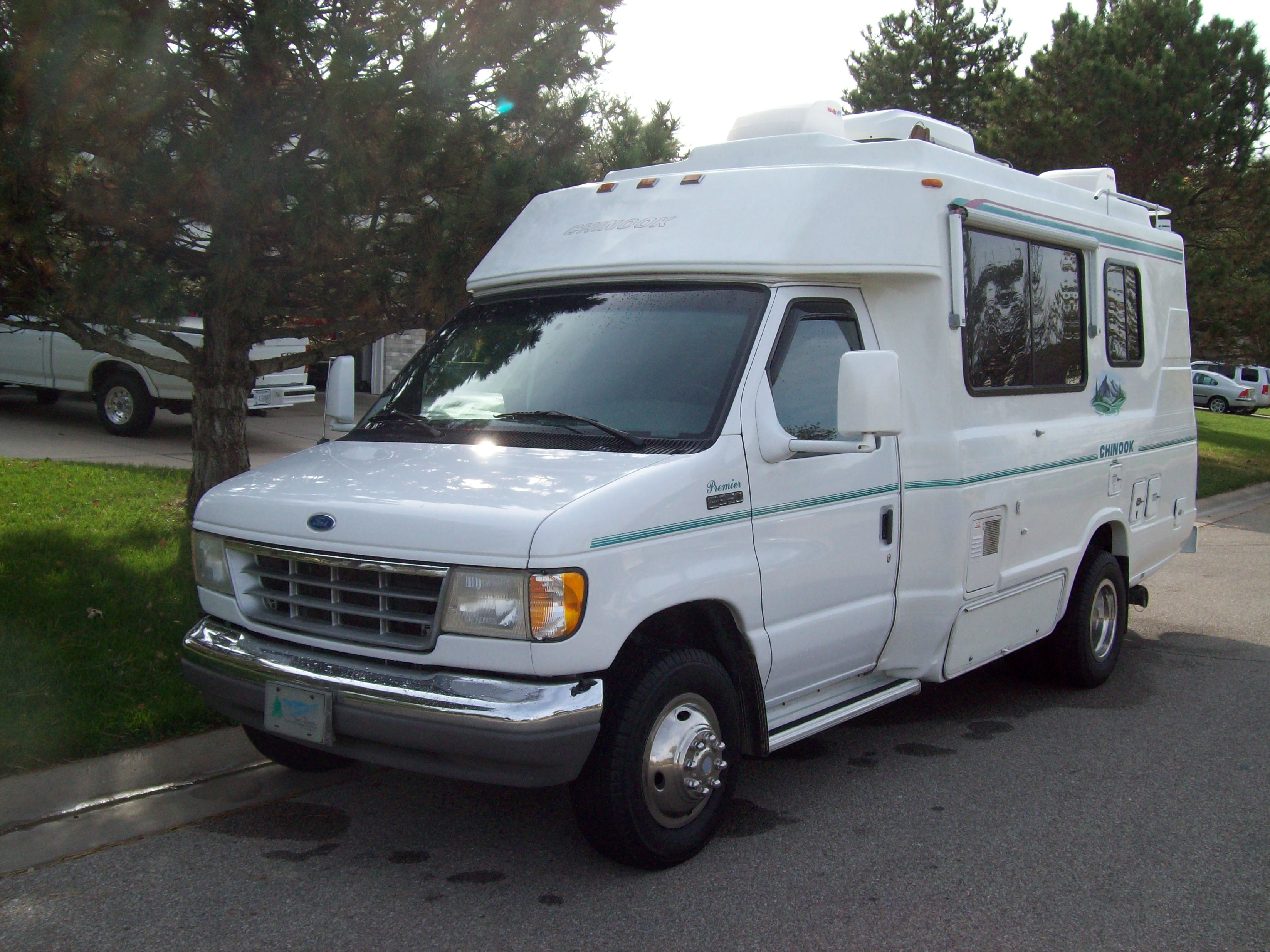

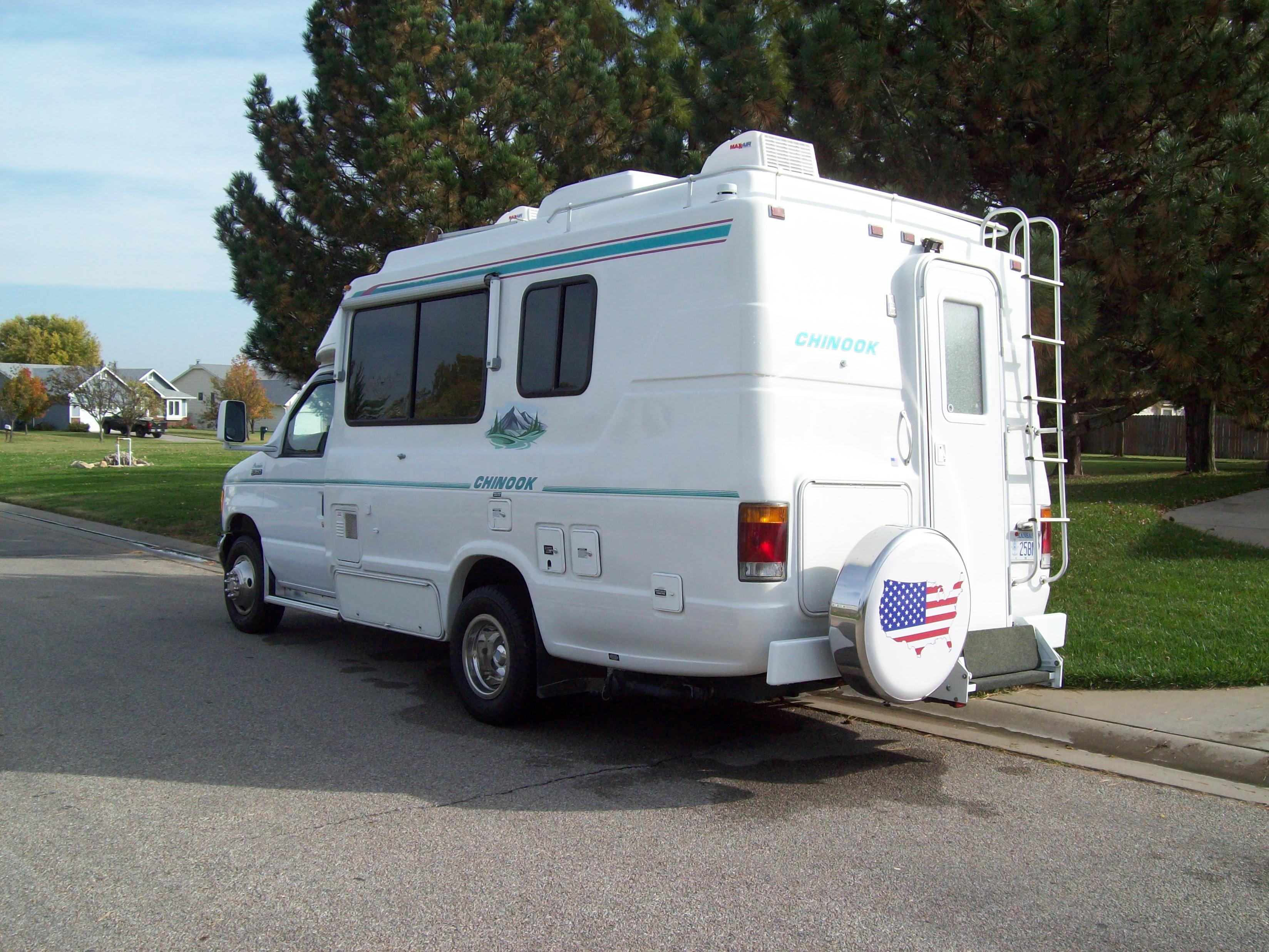

Back from the last trip for the foreseeable future and I thought I would post the information about the chinook rv we have been enjoying the last several months with many enjoyable experiences. If I can get this electrical situation figured out we have no regrets on our purchase. I think it would be safe to say we will staying in rv parks or at least have electrical power available at our kids house. It is a 1995 on a ford chassis with just over 40000 miles on the clock and in good shape. We put new tires on it and a new flat screen tv inside. The rest of it seems to be in pretty much original condition but I did take the original decals off as for the most part they were pretty faded.

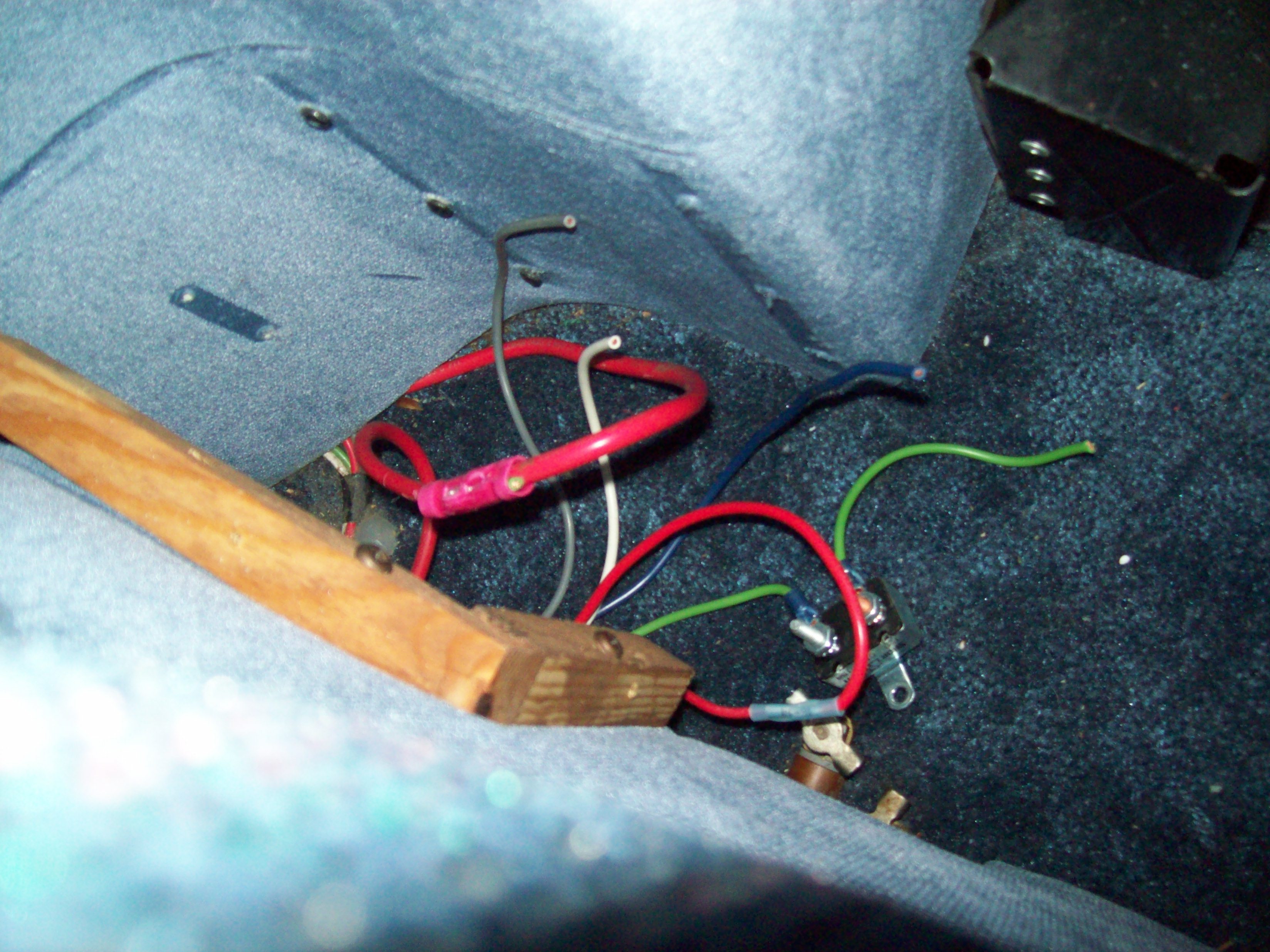

The sure power unit that was removed form behind the drivers seat is pictured leaving a mess of wires when they took the unit out. Needless to say the control panel above the drivers seat is lifeless after the sure power was removed.. There are two wires in the battery area that are capped off conspicuously, so I assume they are part of the system as well. Any advise on what would be the best way to take care of this concern, will be greatly appreciated.

A 1995 Chinook didn't usually have an LVD. What engine do you have, btw?
Edit: oops, now that I look at the photos, it's clear that while it might have a 1995 Ford chassis, it's carrying a late 96 onward model year Chinook house body on the rear. What state was it originally registered in? (Some states ignore the Chinook model year, and only go by the chassis date. You could actually have a 96 or 97 Premier, by Chinook model year. Did it come with a manual with a year on it? Or perhaps still have a build sheet in the rear closet? Also, on the passenger door, is there a build plate with a year?)

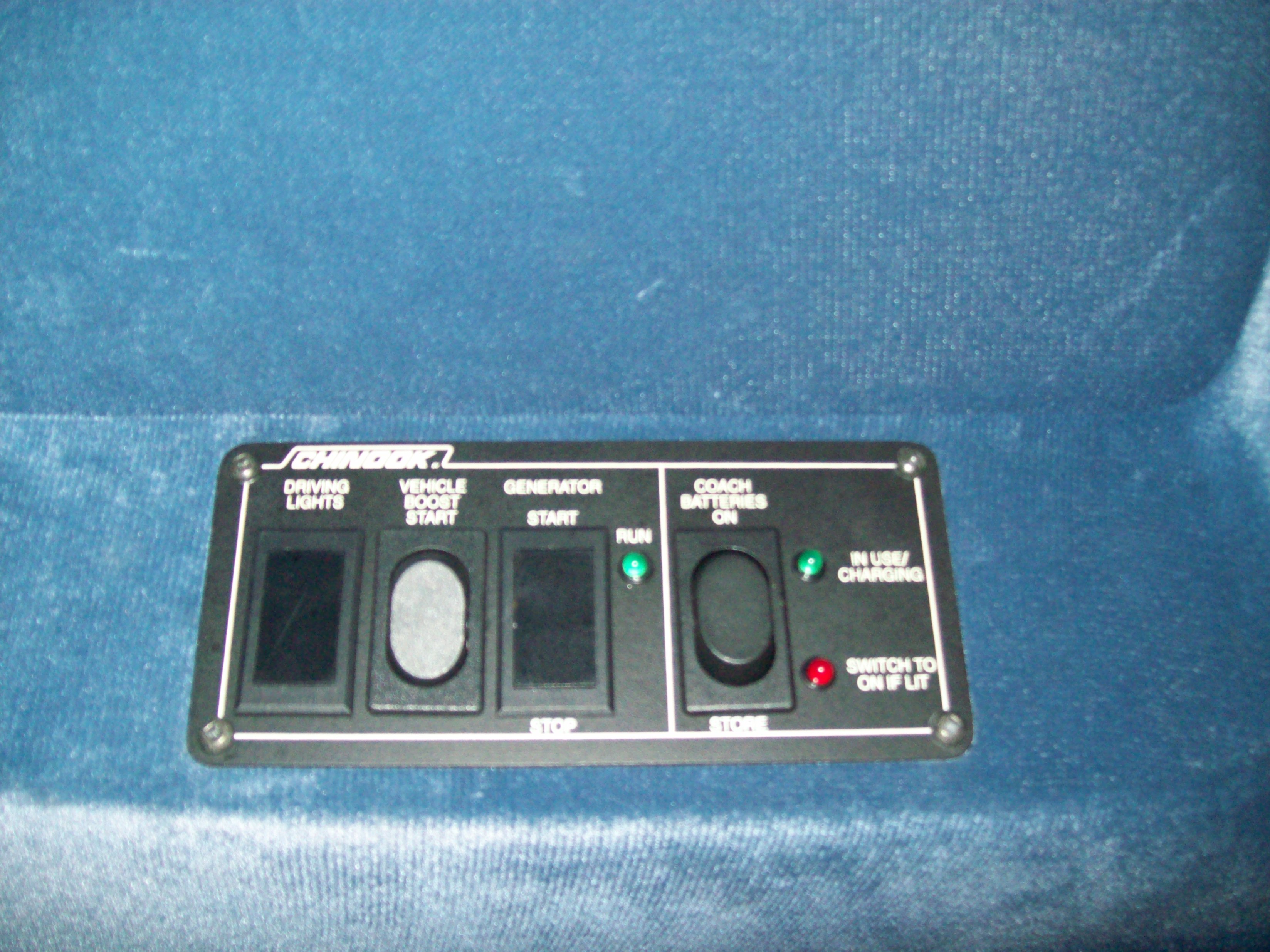

A big clue will be if you show a picture or give details on the switches you have above your driver position. Assuming they're stock, that is. Which ones are there will help us debug your situation.

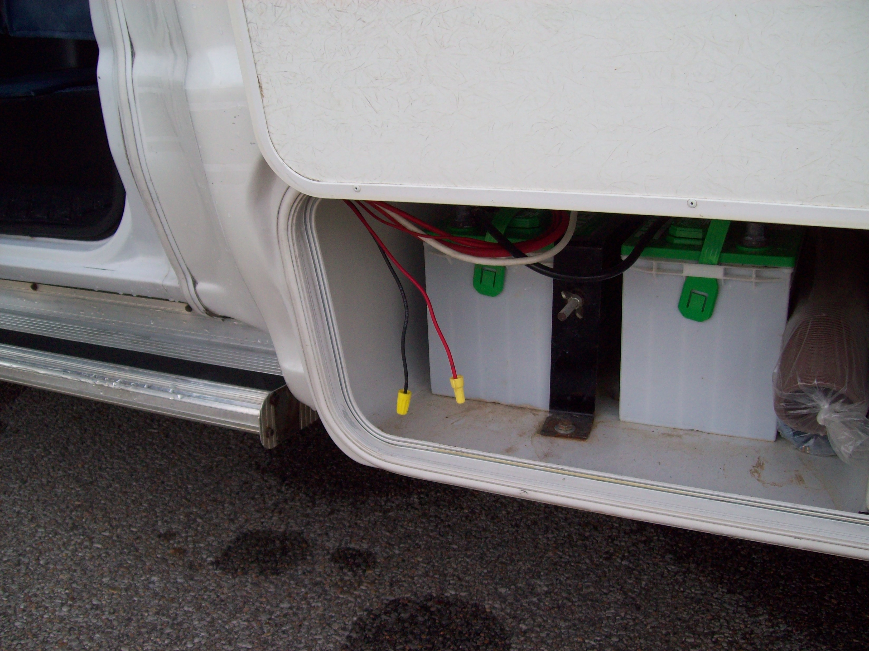

Also, how many house batteries do you have, and where are they located? One under the hood, or two in the side compartment behind the driver door? The reason I ask, is because your rig seems to be one of those built during a big changeover period (96-97), and Chinook was known to mix and match parts and wiring methods during that time. Especially with a Premier.
Also, do you know if the house batteries are good?

Sounds to me like you have a "pre-engine-family-change" chassis (i.e. '95 or '96) but that it was built as a 1997 Chinook Premier. Or at least, maybe a late '96 (?). Reason I say that is that it sure looks like you have the 1997-newer style electrical system, but yet you have an engine that last came in a 1996 from Ford. If you take a look at the electrical drawings in the 1998 manual in the reference section, I think you may find it similar to your rig (as it is the 1997-newer system that is shown).
I think 1995 was the last Ford official year for the amber taillights, but then I looked at a 1997 Premier that WAS a 1997 (had the V10 engine that just started coming in 1997) but it had the amber taillights. So apparently Chinook had a stockpile of cutaway chassis taillights.
The switch panel over driver's shoulder is just like in my '99. Only difference is I have all the blanks filled by switches; but I think that's because it's a Concourse (Premier was "lower" model; Concourse was "upper" model -- of course they both rock :D).
Your batteries are just where mine came on the '99 (Concourse has a slide-out tray, but otherwise same place). LVD footprint looks just the same, same location.

I have heard of the LVD's malfunctioning during certain electrical operations (involving doing work but not disconnecting batts or etc.). Maybe that happened and so flipper just removed it (or prior owner).
I can see why you would want it back, but I'm also thinking about what are the consequences of not having it there. Just as an exercise.
1) It provided a "power post" where the large red wire (6AWG in my rig) came from the batteries below, then went back to charger and loads (they use the same wire to do both things, hence the light and buzzer on the over-the-shoulder panel). Looks like maybe I see a blob of red electrical tape there? Might want to check that joint - you don't want a bad connection and a bunch of resistance.
2) Small wires came off it for things like boost start, the "store" switch over shoulder (allows most but not all house power functions to be shut off in storage), and the buzzer to remind you not to have in store while charging with generator, etc.
3) LVD function. Although it may have been a "horse already out of the barn" level that it warned you at.
4) Was also a power post (basically a good/official joint place) for the ground wire.
So, options:
1) If I can lay hands on my old LVD you are welcome to it. That would be in a month or so.
2) Buy the newer one I listed the part number for. I could look at the manual more closely if you think you will do this. My guess is it has the same functions plus some better ones (I see the voltage for LVD is adjustable, for example, but only skimmed the brochure).
3) Wire in some new things and use it a bit differently.
In the meantime I would AT LEAST pull the tape off those joints in the large wires. You don't want those to just be taped together! At minimum you could buy a couple of power posts and use those (they have good connections plus you can affix them to something). Even a bolt would be better than just tape (not saying it's just tape, but I would look!)
Glad you are happy with your Chinook. I, too, get lots of comments and questions from people. I bet many of us do. It's a good looking rig and a great size that's just a wee bit bigger than a van but not huge.
