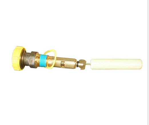

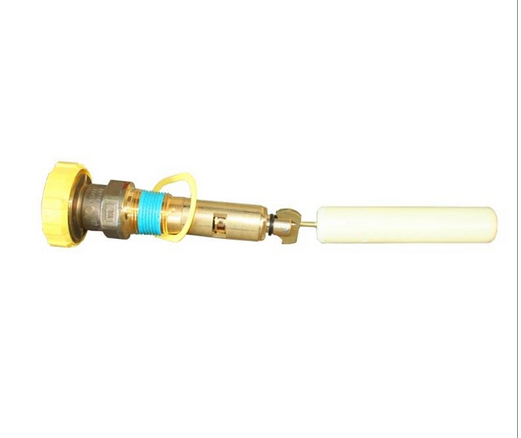

This is a photo of the more common fill valve. This is not "ours," but rather is the ubiquitous one. Same idea though. You can see the float, which can potentially hang up on the gauge float (which is just to the left of it) when removing/replacing. I am suspecting that the float on my fill valve might be messed up, causing the tank to not fill all the way (the gauge works fine though). Not sure yet. Maybe I'll find out it was my imagination and all is fine (think I'll go fill tomorrow...). Sounds like that would be a nice outcome for the wallet!
PS: I did ask Manchester if the float was available separately, and they said no, it has to be replaced as a unit. (Now who knows what an "old timey" place that works with tanks and valves every day would say, but the float cannot be ordered separately.)
