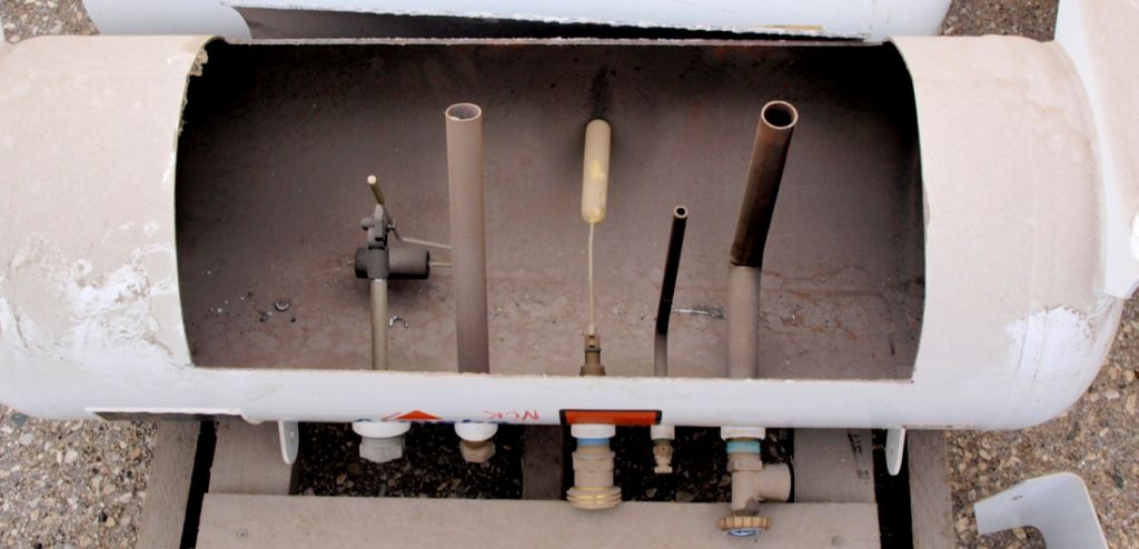

If it helps, not long ago I ran across this simple explanation of the insides of a tank:
http://roadtreking.com/innards-rv-propane-tank/
Picture shows the gauge (with float), pressure relief, fill (with cut-off float), 80% full overflow, and output pipes.
The relief and output pipes are topmost to access the gas. The gauge, fill and overflow pipes are down in the liquid.

I had saved that link as well, as it's good info for ASME tanks. In my case, if there is a problem, I bet it's with the little "paint roller" thingie on the left. I'll find out when I go to fill early next week.
