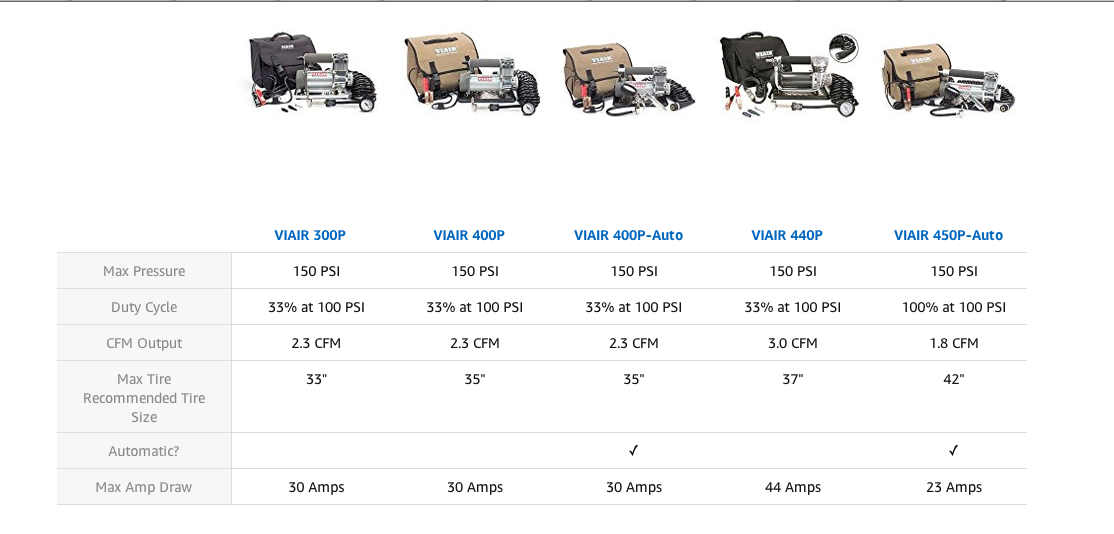

Here is another comparison chart - this is for the larger compressors. As usual, click twice to make it more legible.
After more thought and comparing, I'm thinking the 400P-Automatic. It doesn't have some of the "RV" things that the 450-Automatic RV does -- but I'm not sure I need those, and the 400 will fill faster, which I think would be nice if holding the chuck (which you need to do for the automatic).
On the other hand, if I'm not going to air up/down, then I wouldn't need even the 400P-A. So will I ever do that? I'll have to give it some thought... On the other other hand, it's a nice piece of kit regardless. I'll probably choose it. Maybe. We'll see :lol:

The Viair is rated at .97 cfm at 90 psi. Less than half the CMB15. In my way of thinking, the only decision is whether there is an onboard generator and the space to store the compressor. I have the storage space, a generator, and an invertor that can power the compressor. I run 65 psi in the front tires and 80 in the rear tires. With seasonal temperature changes and the small amount of pressure loss in storage, I can top off the tires in minutes. Once the compressor starts and airs up the air tank to 150 psi, it only runs a couple of minutes more while topping off all six tires.
Re: Deflating Tires for Unimproved Roads
Just as a note: I'm not sure why, but the Viair 450P-RV is rated at a much lower rate than the 400P. Maybe it has something to do with the fact that it's meant to air up truly large RV tires; or maybe it's because it can be used to blow out plumbing lines (?). I don't know, but just mention it because you don't expect the top model to output less. That's why I'm thinking about the 400P-A. I think the Automatic sounds nice (more like onboard air), but I don't want to have to hold the trigger any longer than necessary, and the 400 is faster.

I'll be just topping up tire pressure. First was thinking on-board air but switched to thinking portable for same reasons Blue mentions. Storage size is a consideration too. While I like the CMB15 specs, I dont want to dedicate the require storage space.
I'll likely invest in the VIAIR 440P.
