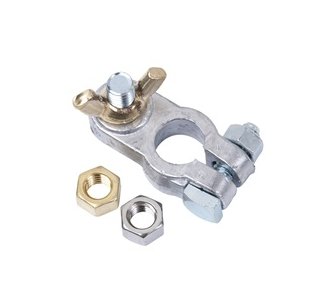

PS: I meant to post a link to the marine post adapters for automotive battery terminals. These allow you to use ring terminals to put multiple cables on one post (up to four condoned by ABYC), and also allow the fitment of MRBF fuse terminals (presuming the battery/bank is small enough that the 10,000 AIC rating is enough).
Ancor is one brand that makes them. This is the less expensive (but fine, I think) lead type. They also make a tinned copper variety (nice, but a luxury IMO). The typical convention on boats (which I follow on the RV) is for the positive post to be 3/8" and the negative to be 5/16".
One note is that although they show (and may come with, although I think they have stopped this practice recently) wing nuts, these are not a good way to secure things to a marine post. Far better to use regular nuts and lockwashers, or serrated flange nuts.
marine post adapters.png (52.87 KiB) Viewed 6480 times
Here is a MRBF holder with fuse in it. The fuse is the glass square. There are also double MRBF's if you need two different fuses on one post. These go right on the battery post, which is great (no unprotected wire) if you have the height (Ford Group 65 start battery does, at least on my '99 Ford hood), and if you don't need a higher AIC (typically one or two batteries such as group 27 would be fine, but one can always check to be sure).

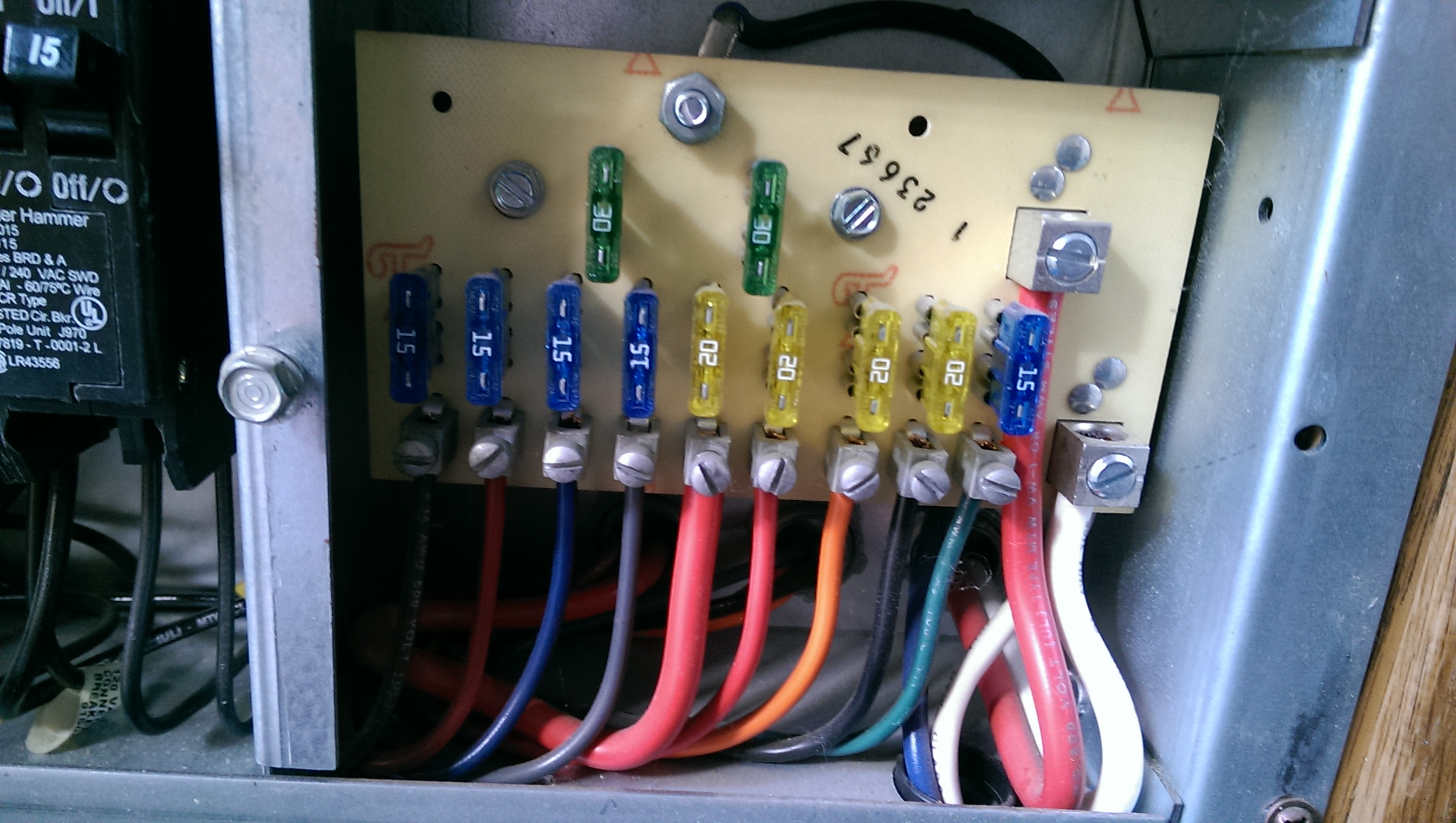

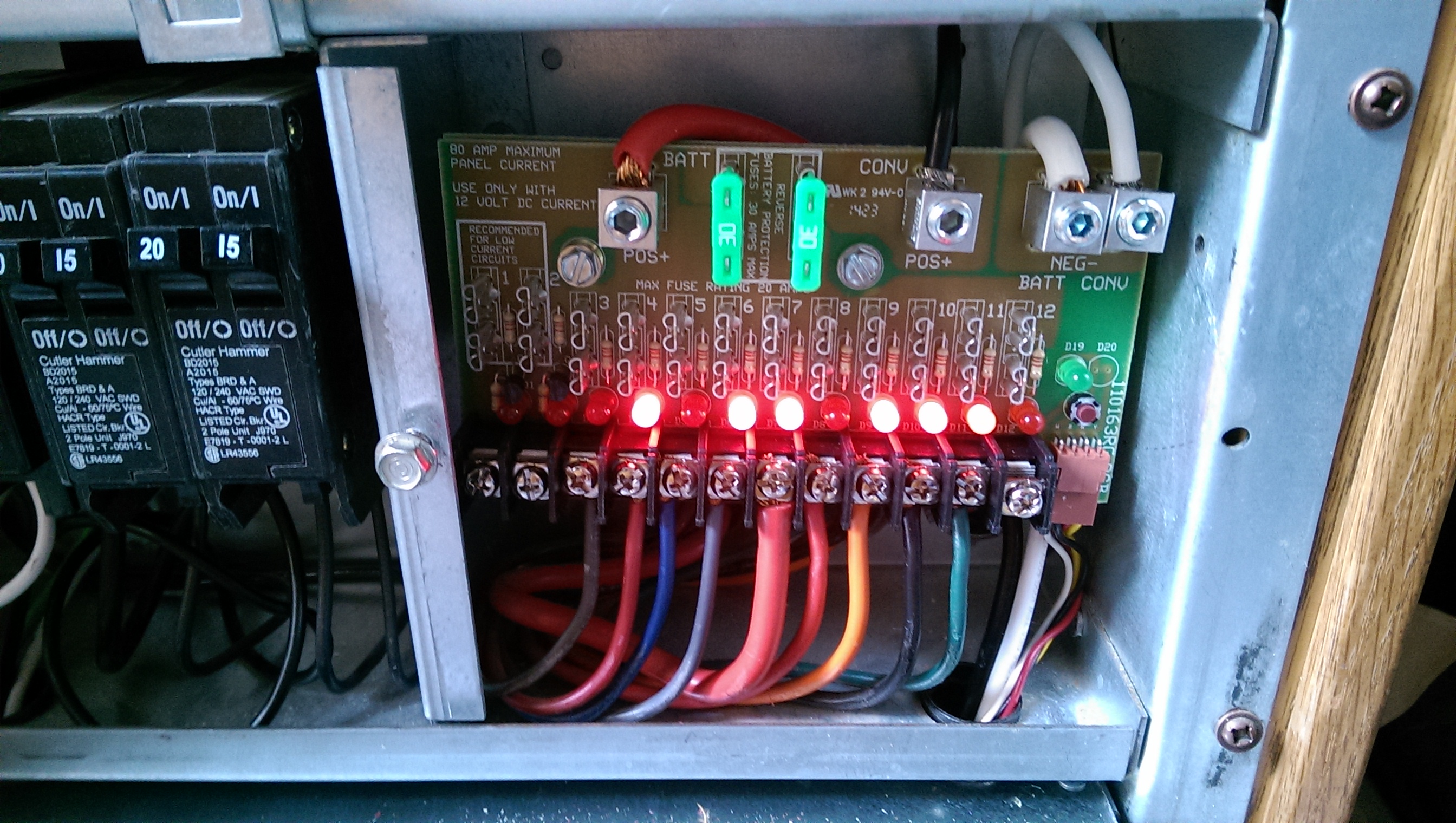

kyidletime wrote:. Oops, another question, I've noticed that some of the models come with a replacement DC distribution board, should I go that route? I guess that that's not particularly a necessity, huh?
Hi Alan,
Hope your upgrades go well. It would be interesting to know what manufacturer/model converter box you currently have in your Chinook, when choosing a replacement. Our newer Concourses had a Magnatek 7445 (45 Amp) , (which later became Parallax). If you have this unit, the PD4645 is made to swap in the new parts in the old box. This one comes with the new DC distribution board that can replace the old one. The new DC board has the "wizard" button buit-in that allows you to force the charger into a particular stage (usually used to prolong the boost mode, when you want to manually force a quick charge), and the board adds a couple of extra circuits, including a low amp circuit for your parasites (LP alarm, CO alarm, etc.). So, You may want to replace the DC board to get those features, plus it adds some LEDs so you can see which circuits are active, which can be helpful for troubleshooting. It's pretty easy to replace anyway, probably less than an hour.
You can buy an external "wizard" button, but it's more of a pain to install, since you have to make a special cable, and mount the button somewhere. I never use the wizard button anyway, so I like having it inside the box just in case I want it, but it doesn't need to be too convenient. Here is a picture of the old one and the new one. If you do change it, pull some slack on the big red wire on the right, because an extra inch or two would help.
Re: Looking for a pre 1997 Chinook concourse Owner
Agreed with Clay, that it would be interesting/informative to see what you have now in terms of the "power center" (which I have been calling the brown box).
