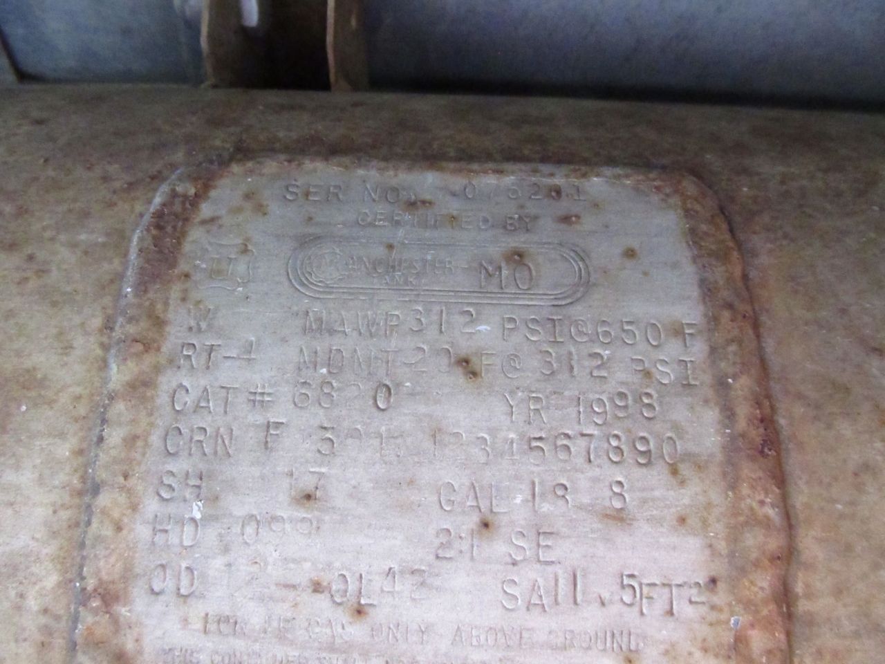

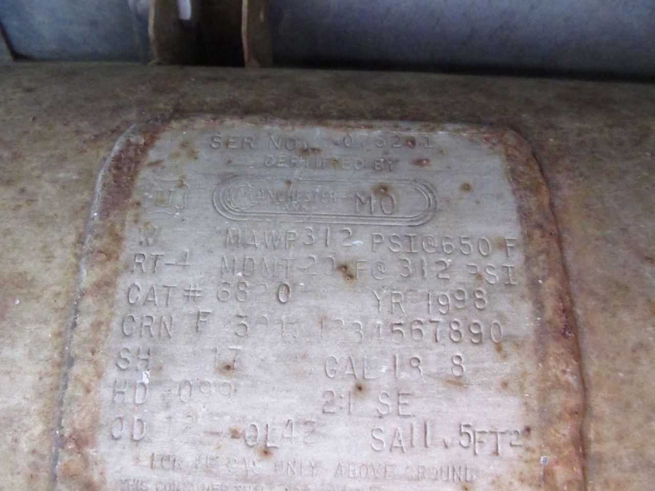

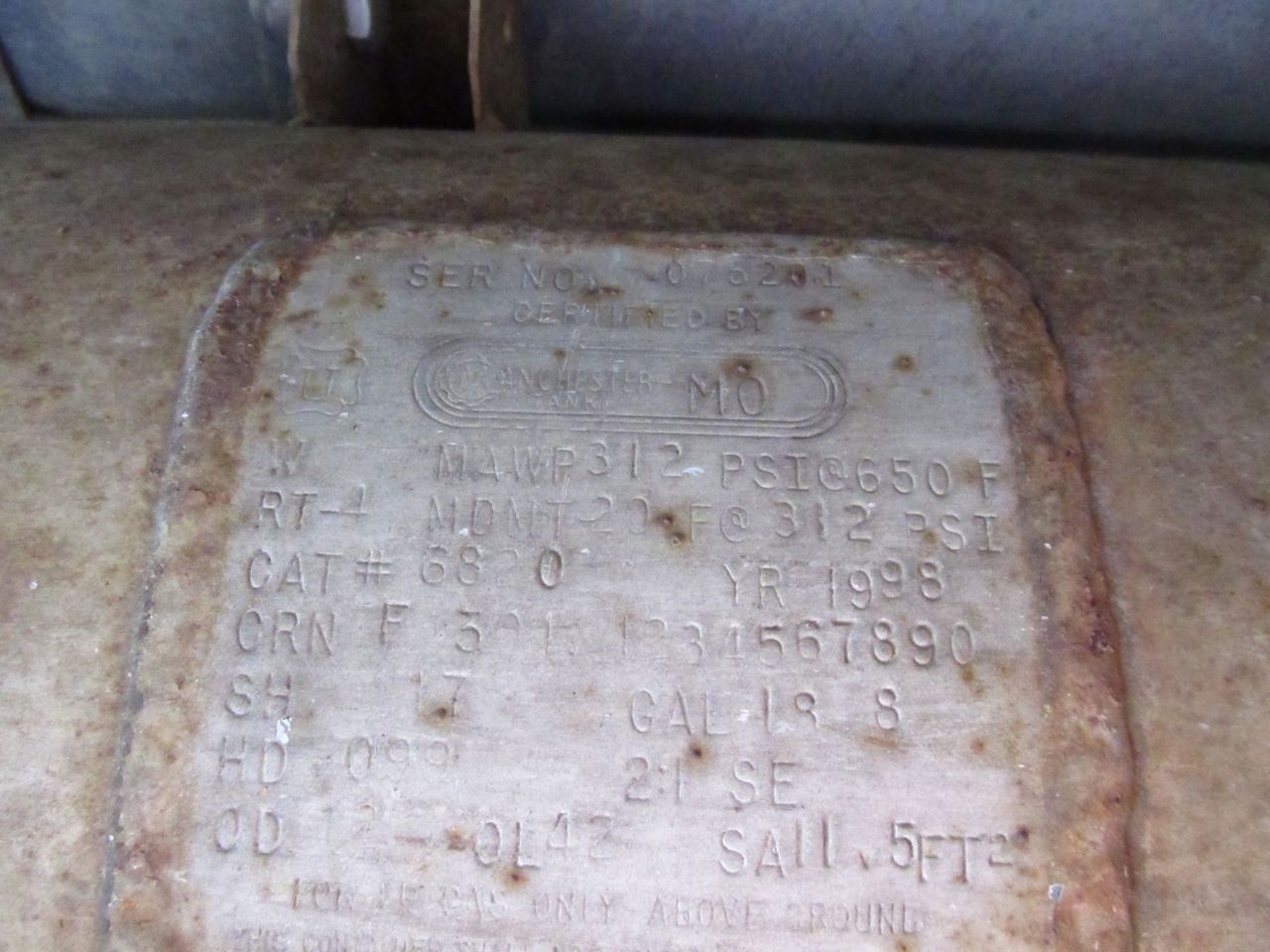

BTW, here is the stamped in label on mine. I'm not sure you can read it in the photo, but if you need any specific numbers, just let me know and I can check. I can read them all in person, I think. It's an 18.8 gallon Manchester tank.
Re: Rusty Propane Tank
BTW, I found a Manchester ASME tank catalog at the link below. They do have one they show as 18 gallons, although it doesn't look exactly the same as mine (the "shields" are separate vs. continuous), but it might be the same one? I'm looking at part #22987. Might be worth a call to them anyway.
On my tank I see "Cat # 6820" (catalog number?) but they could have changed it since it was made in 1998. I do also have a serial number on the tank if that would help at all (not sure if you can read yours).

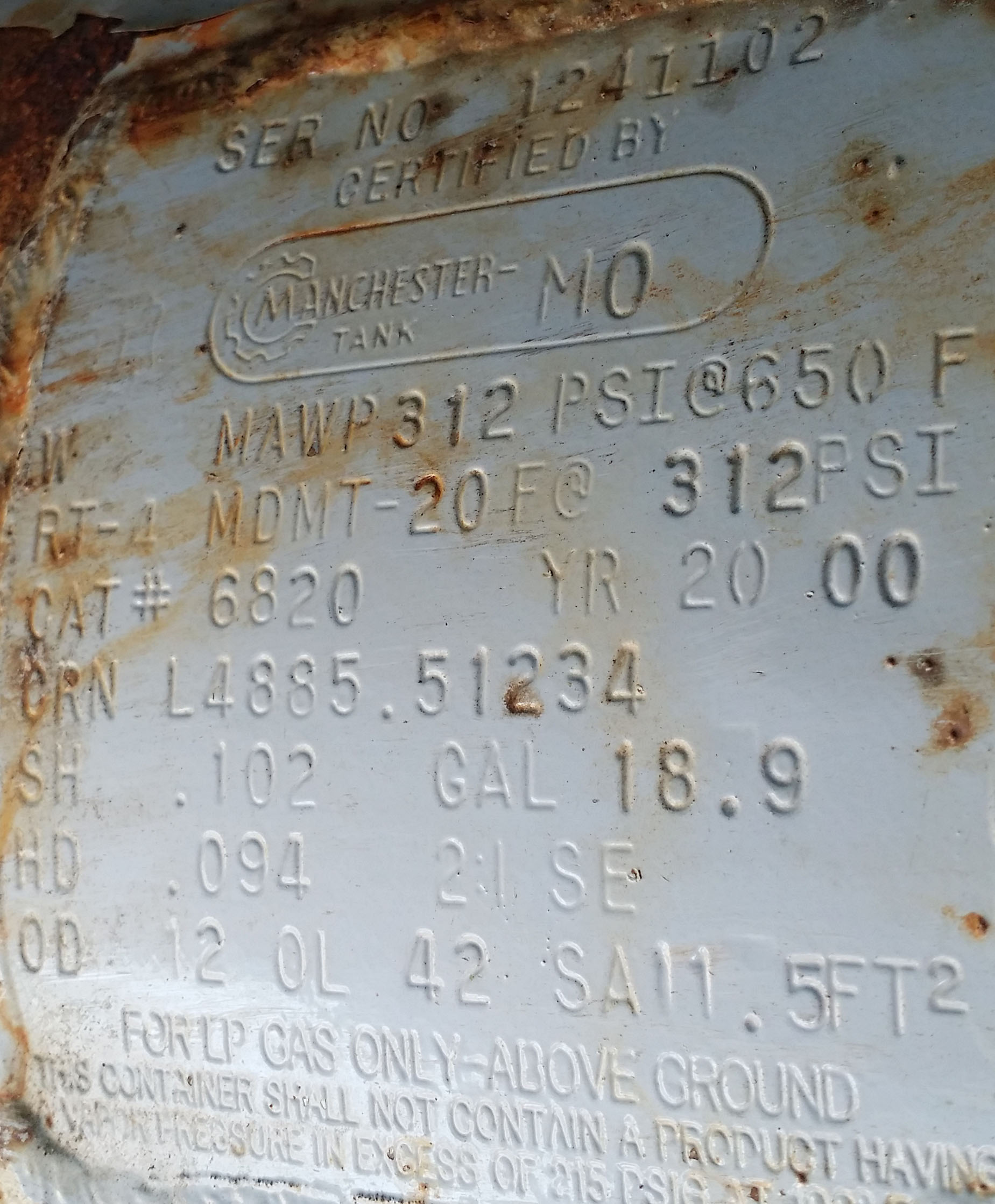

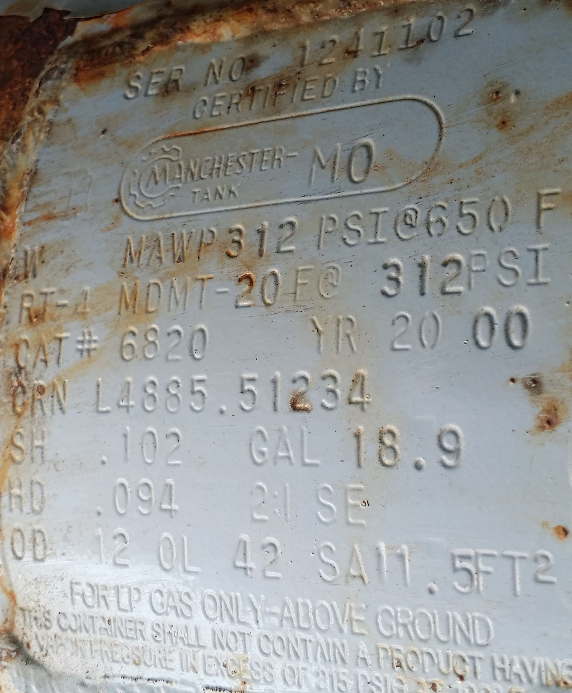

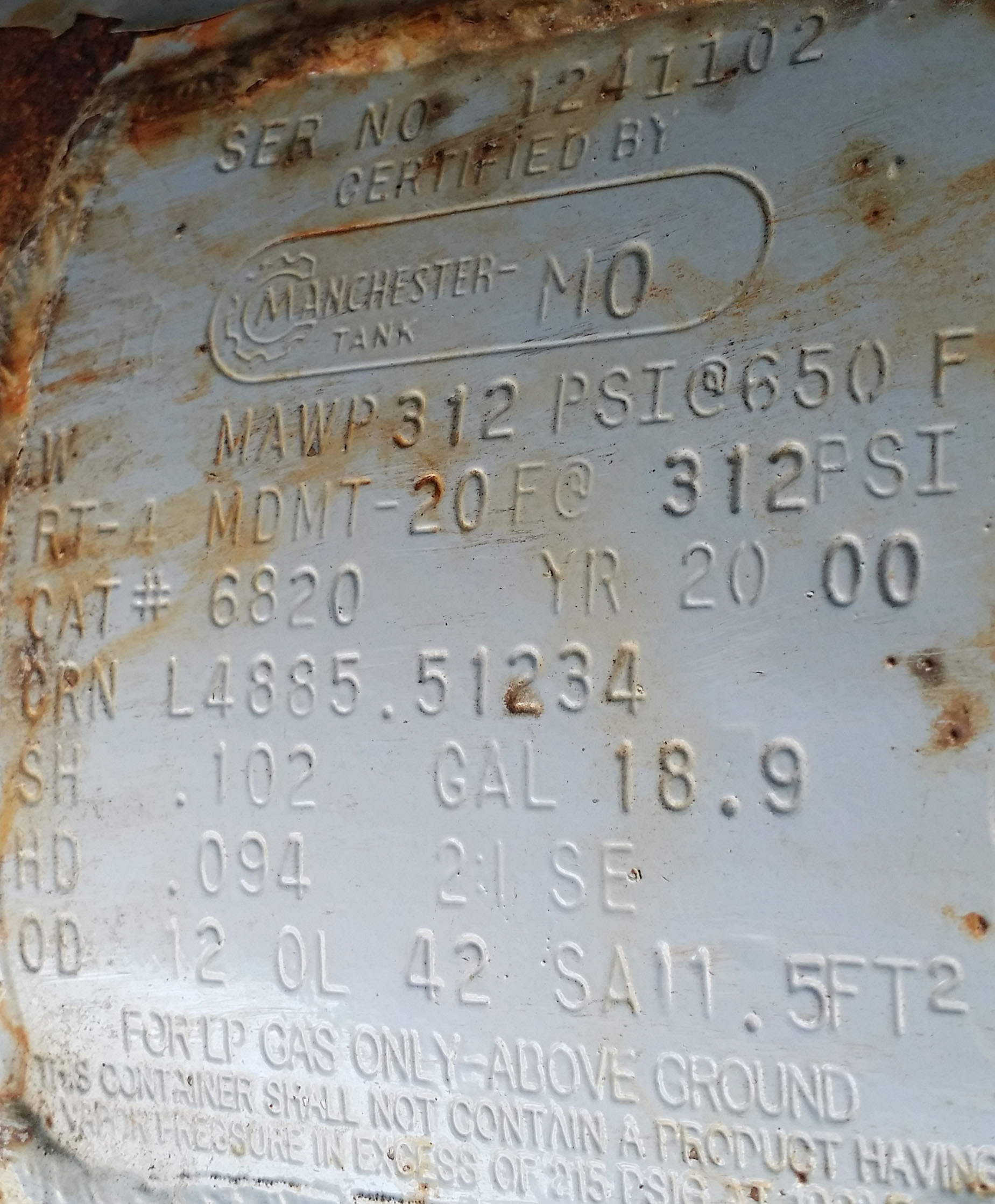

I just sent Manchester an email so I'll let ya'll know what they say about replacement models, etc. Here's a pic of my label. I see we have the same catalog number...
After looking at the link, I see while it's a match gallon-wise, it's longer. Mine is listed as 12x42".
