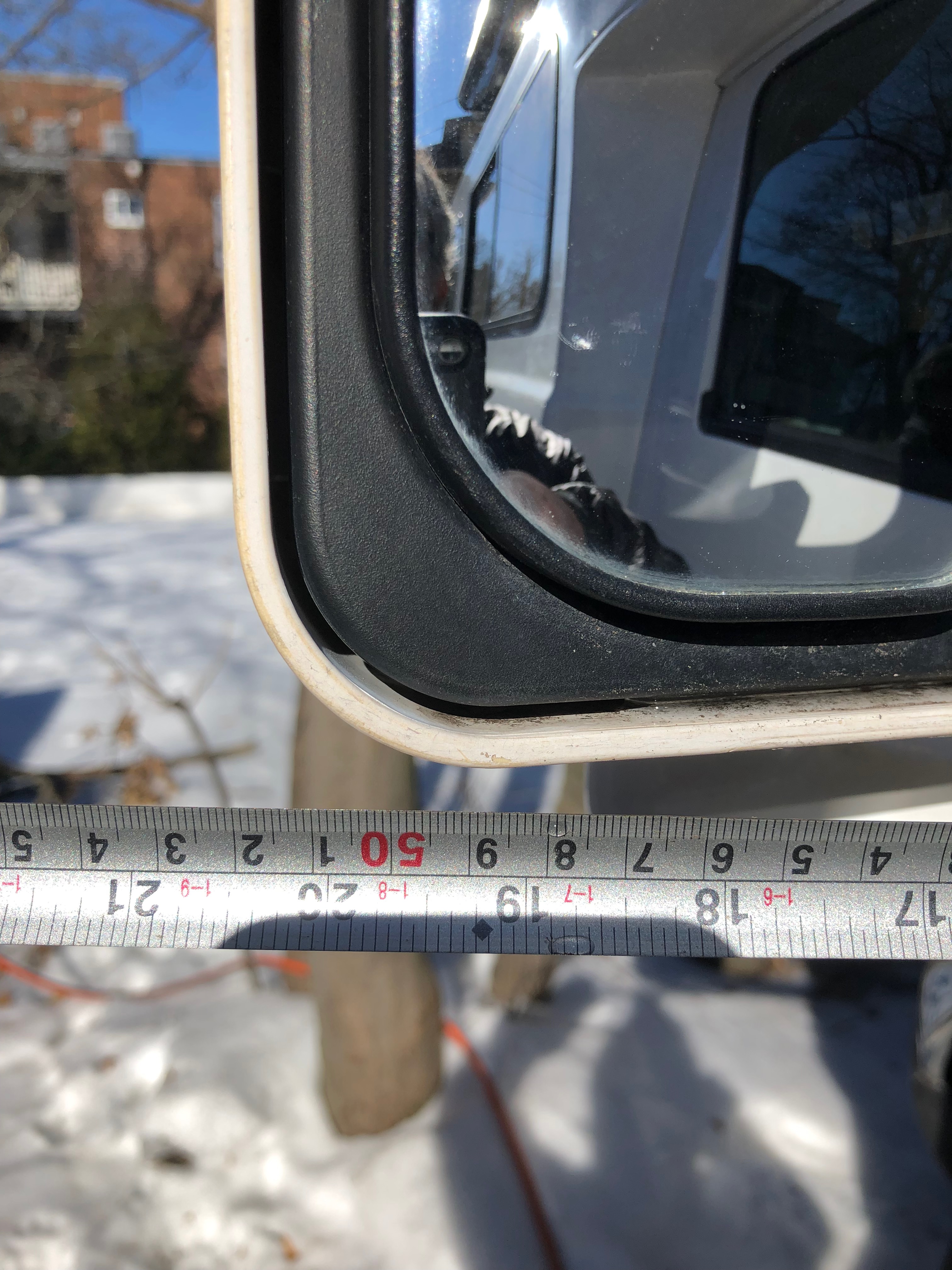

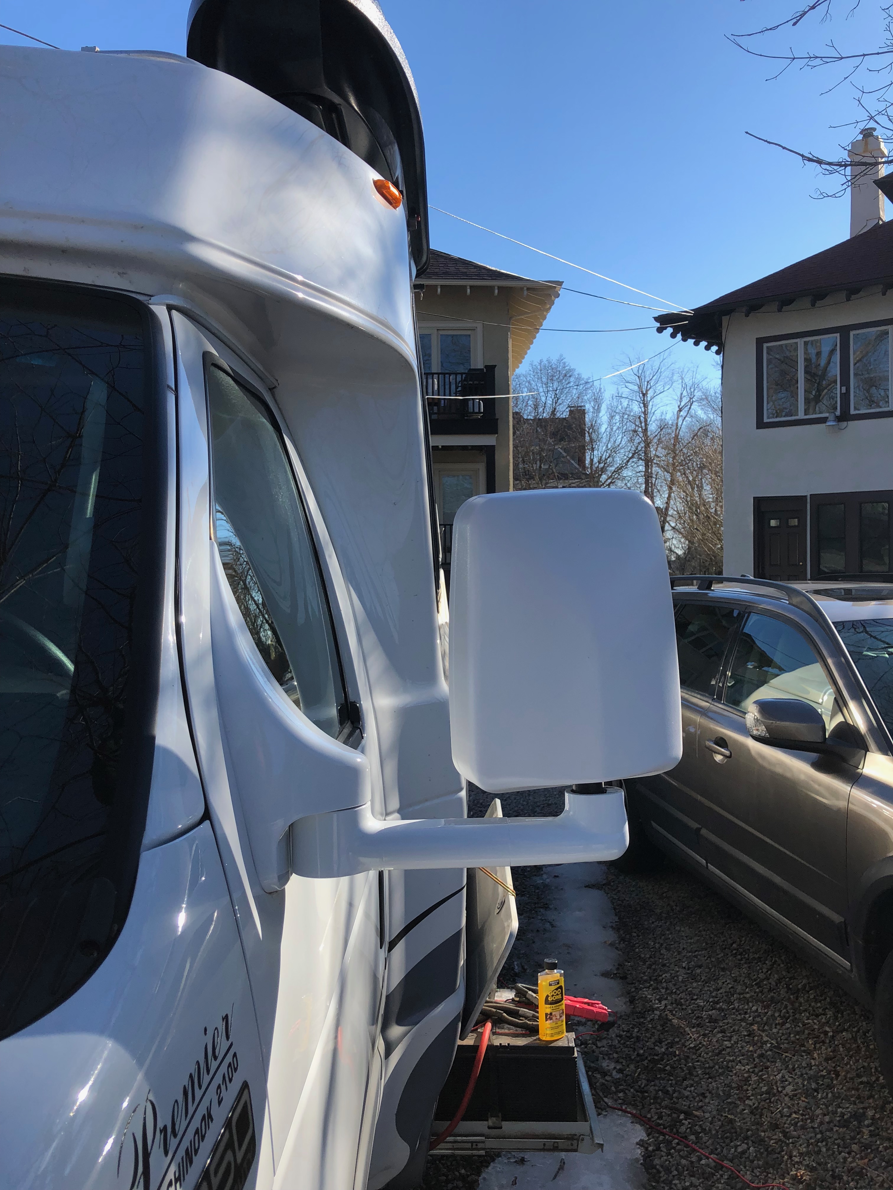

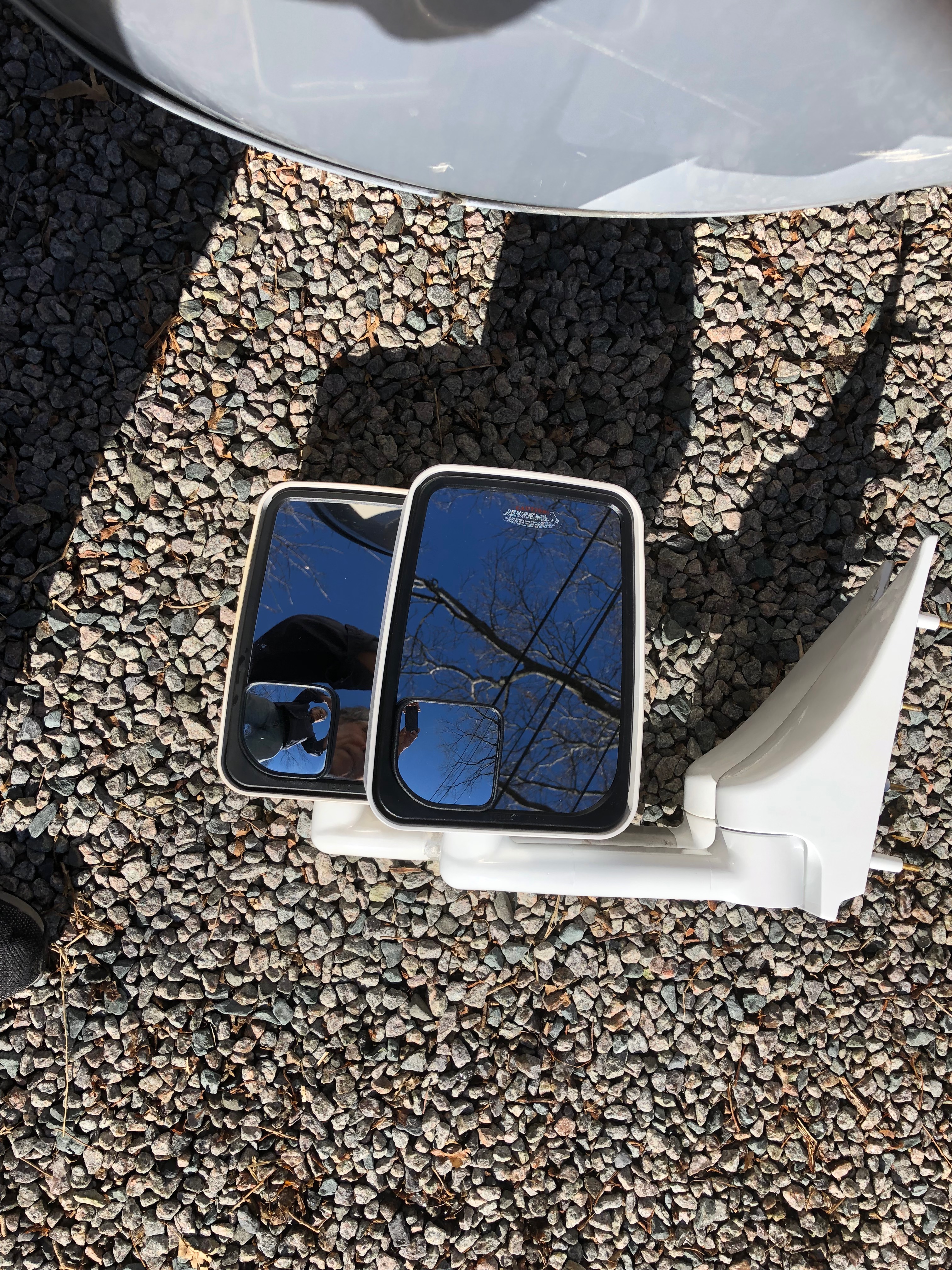

I'm resurrecting an old thread here to describe a Mod I just completed. Our 2004 Premier came with Velvac mirrors (like most of us have--unless, of course, you have already upgraded to power mirrors, or something better looking). Anyway, I found the Velvacs to be fine in terms of vision...and, unlike some others' postings, I have not had any trouble keeping them tight. BUT I have always had a problem with the way in which they stuck out so far--as one of my pictures indicates, it's about 20 1/2 inches from the driver's glass to the outside edge of the mirror that came with our Rig. And that has always made me a bit nervous--especially when passing a biker on a narrow road, or driving in the city along side a row of parked SUV's with their ginormous mirrors protruding into my lane! So, I finally decided to do something about it. I thought about an upgrade to power, or installation of something more sleek, but, in the end, I simply opted to swap my existing set for the exact same mirror, but with a shorter arm--5 inches shorter! In doing some research, I discovered that our mirrors actually come in three different lengths (86", 96", and 102" models with the numbers corresponding to the width along the back bumper). It seems that the stock mirrors on our Premiers and Concourses are the 96" models--Velvac said that was a pretty standard install by Ford since they didn't really know what sort of box was ultimately going onto the chassis.
The actual width across my Premier's back bumper is 88 inches, so I ordered the 86" model. Full disclosure here: This may be the easiest fix, but it ain't cheap! Cost me $600...but the install was easy, and I am already finding my peace of mind while driving in city traffic to be worth the price.
A couple of pics are attached for reference.
