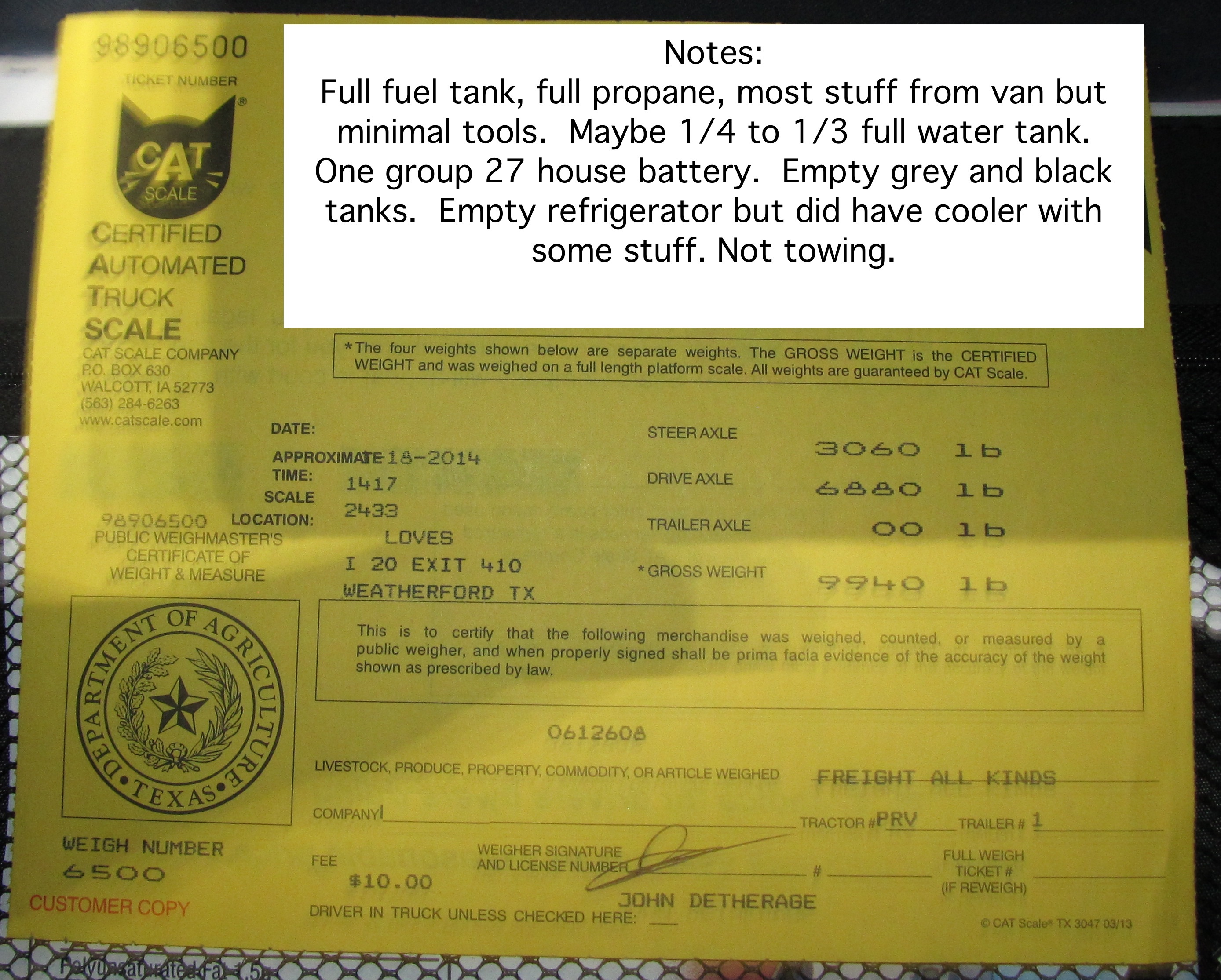

I thought 65 sounded a bit high for typical weight. I still don't think that should make it pull, presuming both sides are inflated equally; but knowing weights and tire pressures is still good.
So for the chart, you need to know your front and rear axle weights. If you went to a CAT scale they may have them listed as "steer" (front) and "drive" (rear).
For comparison, here is the weight I did on my way home from picking up my Chinook. I did have all the stuff from my camper van loaded into it, so not empty by any means (I could barely clear a place to sleep!).
As you can see, my total came to 9,940# at this weighing. If you don't have your axle weights broken out, you could probably use these weights until you can do so. So in this case (my Chinook back in 2014), I had 3,060# front, and 6,880 rear. Note that I did not have a passenger, and I'm not a big driver.
So let's go through the steps of using the chart. First, we divide each axle's weight by the number of tires on the axle. So front axle has two tires, and 3,060# ÷ 2 = 1,530#.
Using the green line on the chart (single wheels) we see that the recommended pressure for the front tires at 1,530# load on each tire is actually below the minimum chart rating of 40psi. That doesn't necessarily mean you should run them at 35psi though, I don't think. I take that to mean that I should start at 40psi and then add pressure until I like the way it handles. Being at the very very bottom of the range obviously makes it a bit different. Also now I'm at closer to 3,500# (1,750#) on each front tire, so now I'm theoretically at like 44#. You are probably a bit higher in front already due to having a passenger. So not knowing your precise front axle weight, I'd say start at 45# and see how it feels. Nothing wrong (IMO) with adding some psi above that, but clearly you likely don't need 65#.
Okay, now we'll do the rear (for my original scale weight). I was 6,880# on the rear axle. So dividing by number of tires we do 6,880 ÷ 4 = 1,720# Now we look at the blue line on the chart (because that is for dual wheels, which are de-rated a bit due to heat I think), and for 1,720# we see they recommend about 48psi per tire. One thing to note especially is the fuel level if you weigh without a full tank. That's because a full fuel tank in our rigs weighs about 250# (in fuel) and it's behind the axle. So it would add something like 75# per tire. Same with black and grey tanks (way back there) vs. potable water tank (up forward of the axle). Upshot is that unless I'm chock full when I weigh, I add some additional psi to the rear tires.
Hope that helps explain the weighing/chart/psi. These are guidelines put out by the tire mfgrs, btw. There are also psi recommendations on the door jamb but they are only listing what they *think* your weights may be, because they are making up the stickers while the rig is being built and they have to estimate something. Scale weights are just exactly what you DO weigh.
I don't know how it works in Texas or nearby states, but some states (eg Oregon and Washington) leave their public highway scales on even when the scales aren't "open" for trucks. So anyone can drive in during those off hours and use the scales. It's fantastic and oftentimes you can be there for 30-45 minutes without anyone else pulling in. I've used these to not only weigh the axles, but do the left and right sides, plus weigh my trailer(s) tongue and axles. Super handy. It's usually a bit more rushed at a CAT scale and you can't do all the permutations.
