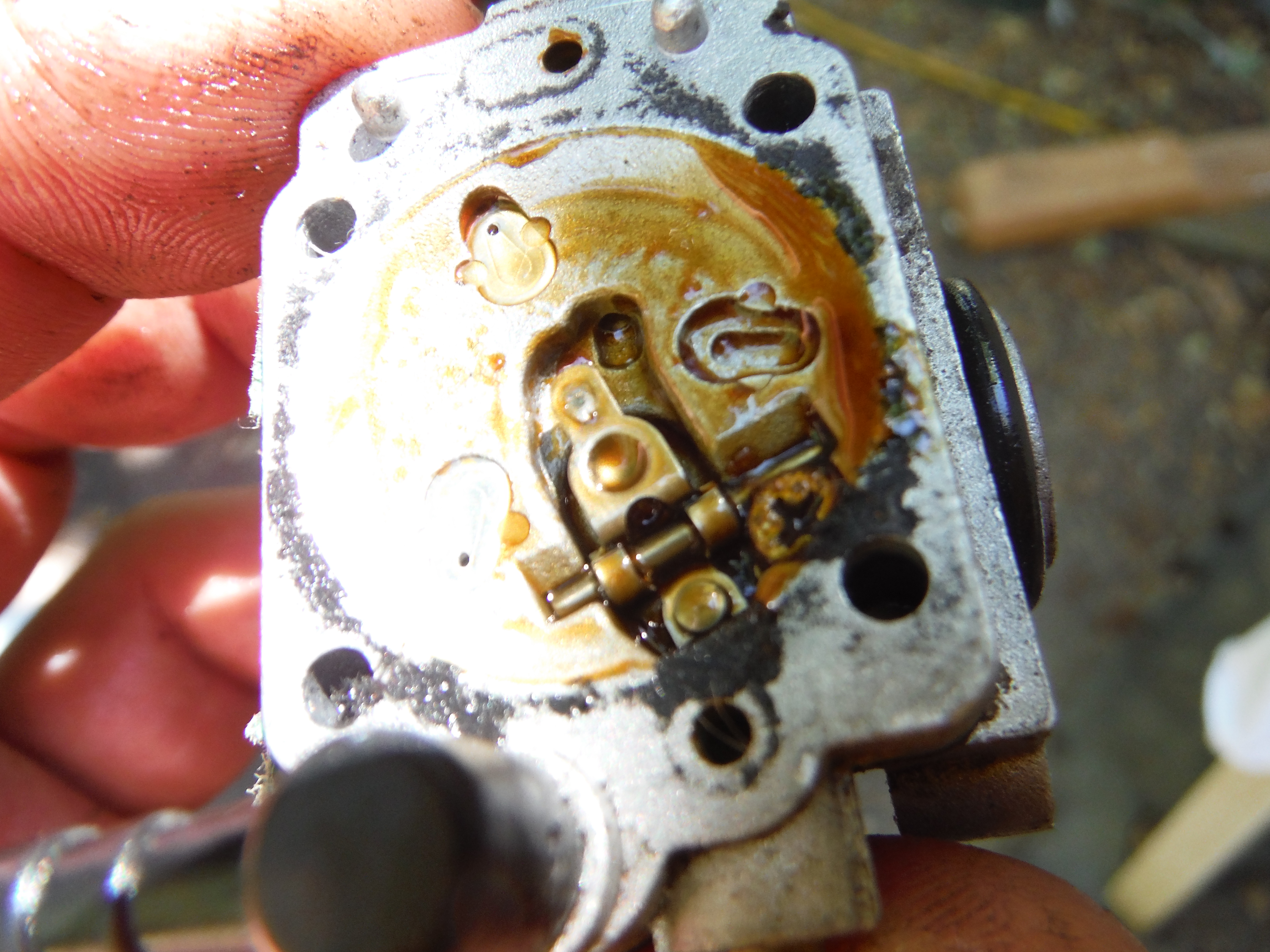

Right. Thanks for pointing that out. For gravity fed fuel systems, I drain the bowl then run it until it stalls. It's not ideal to let an engine run lean like that, but it's better than the alternative.
Pictured is the carb from a Honda rototiller that I accidentally (stupidly) stored with half a tank of E10. I tried everything to clear it out (kerosene, injector cleaner, MEK, acetone). It was like honey. A new carb was outrageously expensive, so yet another great machine went to the scrap heap.
