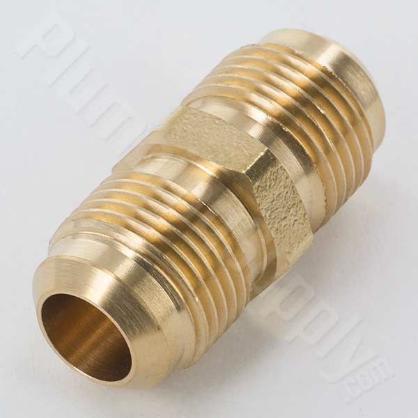

And here is the type of "coned" fitting that goes on the other side and fits into the flare bell. This happens to be a union, but there are T's, plugs, etc.

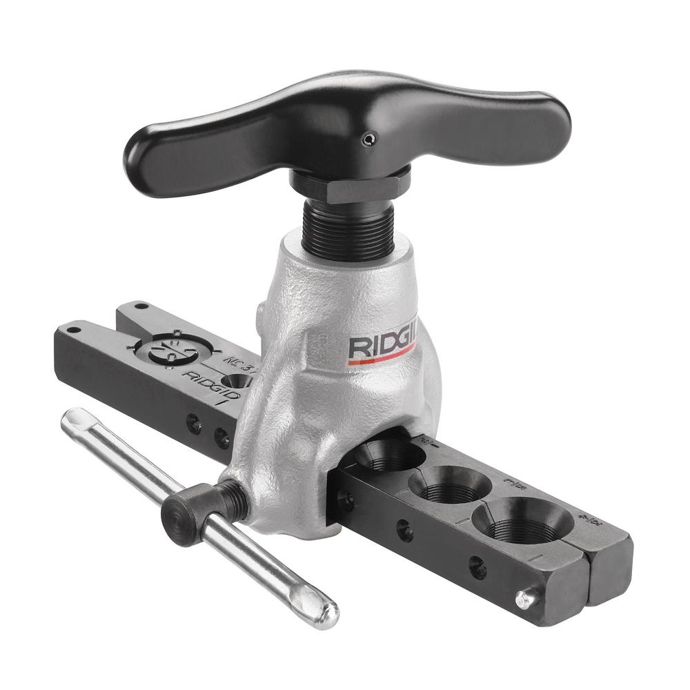

Flaring tool (there are different types):

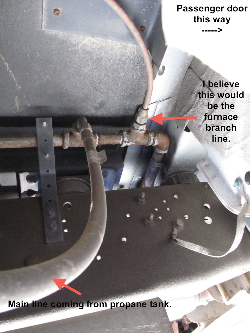

Oh, on disconnecting the furnace fitting beneath the floor. It is dark and cold outside right now, but here is a photo I took previously when my Chinook was on a lift. It's annotated and shows what I think is the "furnace branch" where it connects under the rig. Since the branch line has the flare and flare fitting, you would use a cap on the main part (vs. a plug), after removing the branch line and the flare fitting. That'd be a 3/8" Flare cap. Should be easily soured at Home Depot or hardware store.
You may have to click once or twice to be able to read it.

Looking at your photo again, a question: Are there plugs meant to fit in and block off where the branch lines normally connect? It looks like that would need a different kind of plug - kind of a flare nut without a pipe through it.

A) Since you want to get rid of the propane line that comes into the living room by the furnace, then I would remove that one underneath the coach where I showed in the annotated diagram. Given that I see the furnace pipe has a flare nut, we can assume that the "tank side" of that line has a flare/cone type fitting, in which case a 3/8" flare cap will fit on it (no tape or sealant on flared fittings, note). Then you can pull the furnace branch copper and store it away (note: Don't fill the floor hole with steel wool, as this can oxidize and spontaneously combust. Better would be a permanent fill like thickened epoxy, or for temporary something like copper "mouse mesh," perhaps with some sealant on the underside. There is likely one of Chinook's plastic collars in the floor hole so you could leave that and fill the inside of it with the mesh (that's what I did for now on the former refrigerator drain hole).

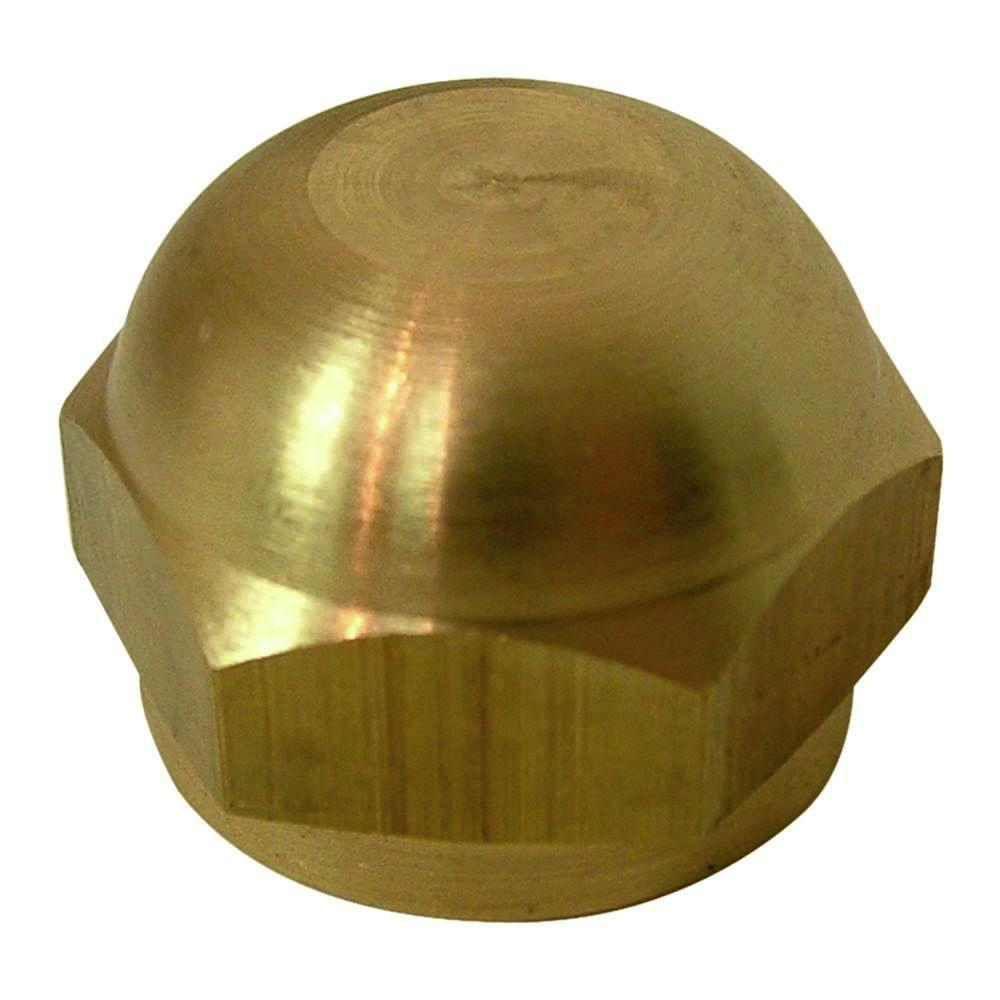

B) Since you may want to re-use the stove and fridge lines, and since they are not in spaces where they are in the way, you could cap those off inside (this would be with 3/8" flare plugs, technically, not flare caps). That's because this is the reverse of the case in A, and you are filling the flare nut, not capping the flare cone.

I'm surprised that your Home Depot doesn't have the caps/plugs. I think I've seen them at both HD and Lowe's. But if not, most hardware stores will have them (sometimes on sliding wall panels that hide them behind other fittings. A hardware store may be easier and have better selection. Make sure they are 45º FLARE fittings, not compression or other type. You will see that they have either the male or female "cone" shape inside. Here is what I mean:
BTW, these are all easily available on Amazon, if that's easier.
Cap:
https://www.homedepot.com/p/Everbilt-3- ... /207176831
Plug:
https://www.homedepot.com/p/Everbilt-3- ... /207176679

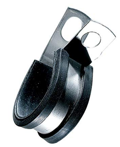

Cushion clamp (see how it has a rubber liner - that helps to protect the tubing): One note on these is the holes are usually fairly large, so you will want a decent sized washer under the screw, or a truss headed screw (big head).
https://www.amazon.com/Ancor-Marine-Ele ... th=1&psc=1
