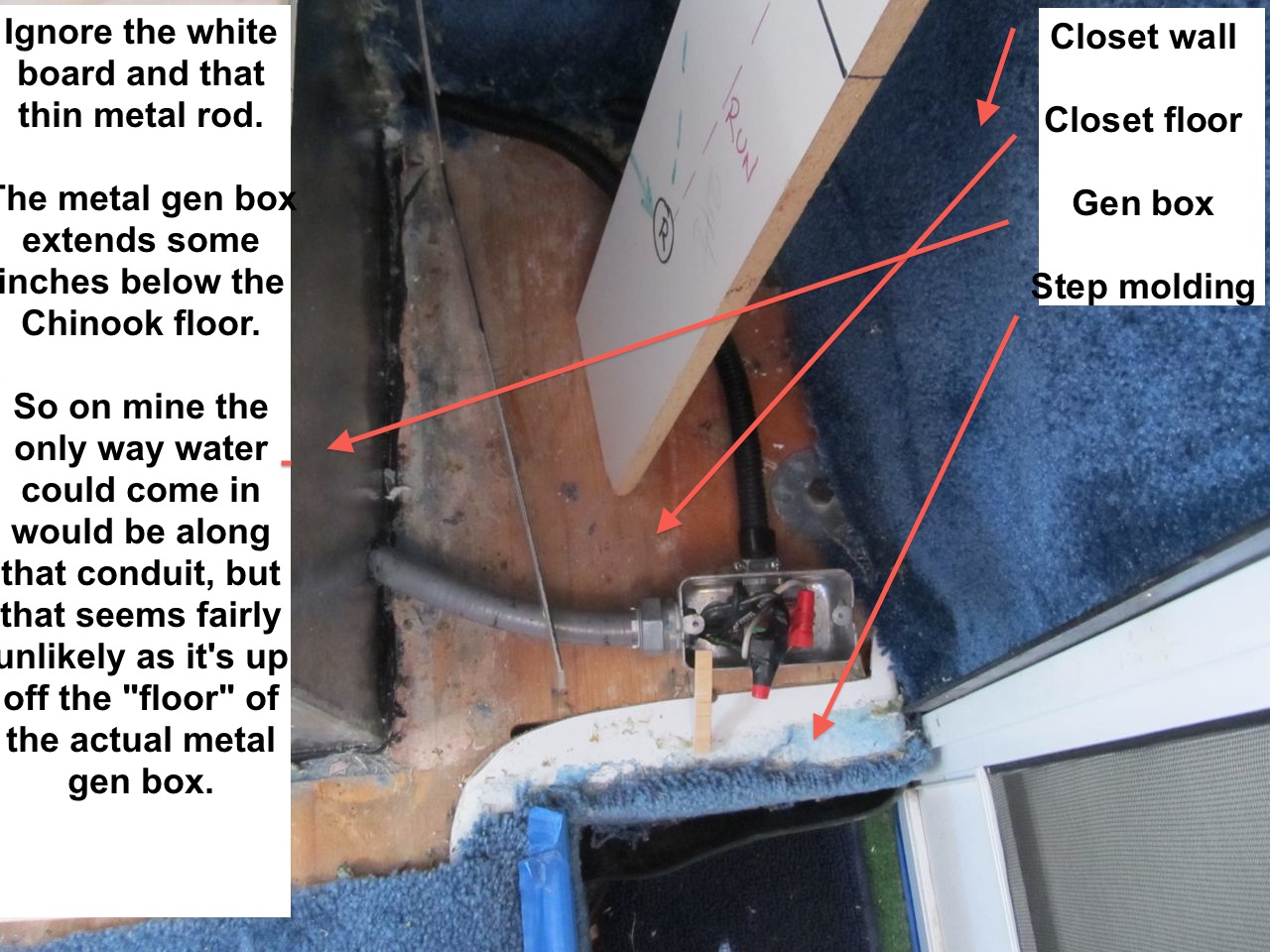

That's curious to me because my generator compartment "floor" is well below the Chinook's floor (where the junction box is). The whole gen compartment is lined with a sheet metal box with folded (sealed) corners, and that box sits 3/4 above the Chinook main floor and 1/4 below. So how does water get up to even the lowest closet floor section? (The wiring for my junction box would be the only penetration but it's up off the "floor" of the metal box and sealed - course it could be re-sealed if necessary.)
Is yours different?
Here is a photo that shows what I mean. Although you can't see it that sheet metal box is continuous (no seam at Chinook floor level) and runs down below the Chinook floor. The black caulk line between the box and the Chinook floor is just to seal the floor to the side of the box, but the box doesn't "end" there - it extends further down.

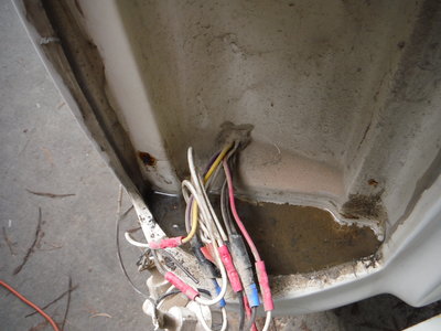

You know, I couldn't tell ya :(. They're tricolored and have a horizontal bead profile. Did I read somewhere that they used something from a minivan at one point? Aerostar? I don't even know if they're Ford or not. [Edit: yes, they from an Aerostar]
The actual light assembly isn't the problem. Water get's behind it due to a crusty gasket, then pools in the bucket that Chinook glassed into the main shell (pictured). The piece that the wires go through is not a part of the main shell. The joints aren't 100% fully glassed, so they put a bead of caulk to seal it, which failed and caused the leak. Easy fix, though. It's really not as bad as it looks. If you see the silicone boogers sealing the wires, you might get a bit of a feel for what's going on. Mine could be totally different from other years/models (caveat).
This is the driver side, which didn't leak into the coach, but made a pretty cool mud puddle. On the other side, it leaked in under the closet floor.
