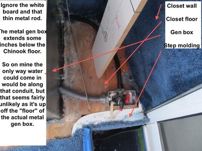

I've had intermittent problems with some dampness in the closet floor (mostly under the fake floor, where an AC junction box sits), which then crossed the lower step. Recently, I think I've traced it to heavy rains with wind pushing some water through the generator compartment door grill (the fencing/holes on either end of the door that let air in when the generator runs). This then sat on the floor at the back of the compartment (it's usually parked on a very slight incline), which then seeped through down into the closet.
When I finally realized what might be happening I checked the back floor of the generator compartment and could feel the dampness and that the floor/side felt like it was rotting a bit (this was days after a big rain, and still damp). Anyway, I cut some Lexan panels that bolt on to the grill and seal the generator compartment door. I plan on leaving them normally, and then just remove them when I need to run the generator.

That's curious to me because my generator compartment "floor" is well below the Chinook's floor (where the junction box is). The whole gen compartment is lined with a sheet metal box with folded (sealed) corners, and that box sits 3/4 above the Chinook main floor and 1/4 below. So how does water get up to even the lowest closet floor section? (The wiring for my junction box would be the only penetration but it's up off the "floor" of the metal box and sealed - course it could be re-sealed if necessary.)
Is yours different?
Here is a photo that shows what I mean. Although you can't see it that sheet metal box is continuous (no seam at Chinook floor level) and runs down below the Chinook floor. The black caulk line between the box and the Chinook floor is just to seal the floor to the side of the box, but the box doesn't "end" there - it extends further down.

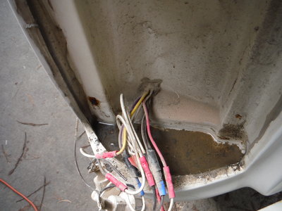

I also had water on the closet floor. It entered through the tail light housing, which is partially glassed into the Chinook body, then caulked at the seams; the caulk had dried up. I also had a very slow leak at the water pump.

The actual light assembly isn't the problem. Water get's behind it due to a crusty gasket, then pools in the bucket that Chinook glassed into the main shell (pictured). The piece that the wires go through is not a part of the main shell. The joints aren't 100% fully glassed, so they put a bead of caulk to seal it, which failed and caused the leak. Easy fix, though. It's really not as bad as it looks. If you see the silicone boogers sealing the wires, you might get a bit of a feel for what's going on. Mine could be totally different from other years/models (caveat).
This is the driver side, which didn't leak into the coach, but made a pretty cool mud puddle. On the other side, it leaked in under the closet floor.
