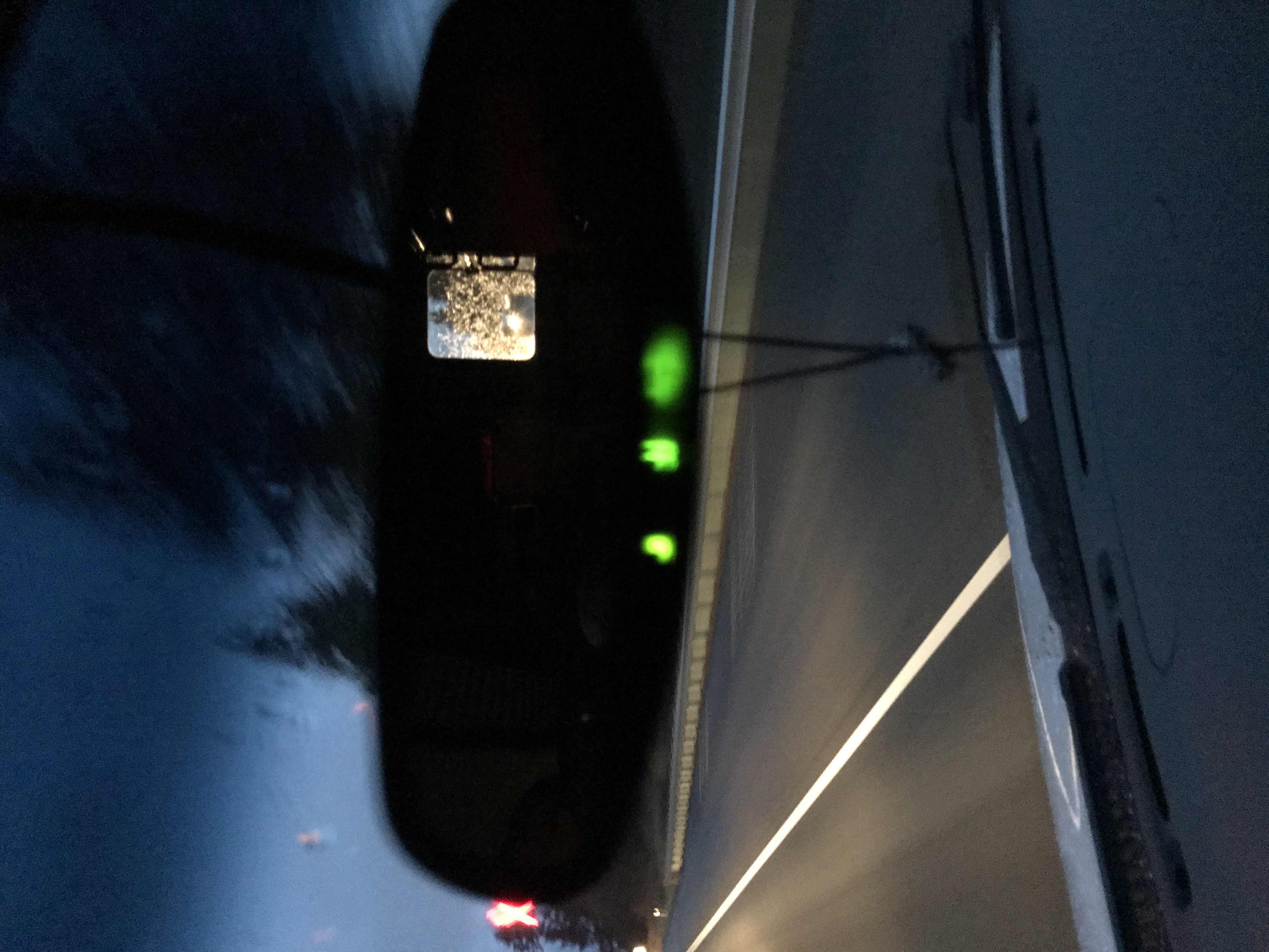

My rear view mirror has the compass and outside temperature capability. I think it also should have the automatic dimmer since it has the little light and sensor, but that doesn’t work.
What bugs me is that perhaps someone tried to clean it at one time with the wrong type cleaner and the temp area is blurred and hard to read.
Not sure if it would be worth replacing since I don’t want to pay lots just for outside temp, but it bugs me. Any way the plastic can be replaced?

Depends on how the plastic is mounted, maybe you can remove it and polish it to remove the blur?

Hmmm, didn’t think about that.
Maybe I can pry it out and polish it.
I’ll try that!

you maybe able to use those head light polish for this, but my experience is on polishing acrylics paneling, and the kind of polish I used is called Novus.
Re: Rear view mirror defective
I can't tell from the photo if you have the same one I do ('99). I wonder if the little lenses are lights? Mine has two "dome" lights in the base, one on each side. Plus then the temp and compass. No auto dim.
OTOH, if it is auto dim, maybe it can't work because (at least the one in my car) needs to see lights coming in the back window (shining on the sensor from the face side of the mirror). I don't think I'd say light gets that far up from the rear window of the Chinook.
Does anyone else have auto dim? Does it work? Or do you have little "dome lights" like mine does?
