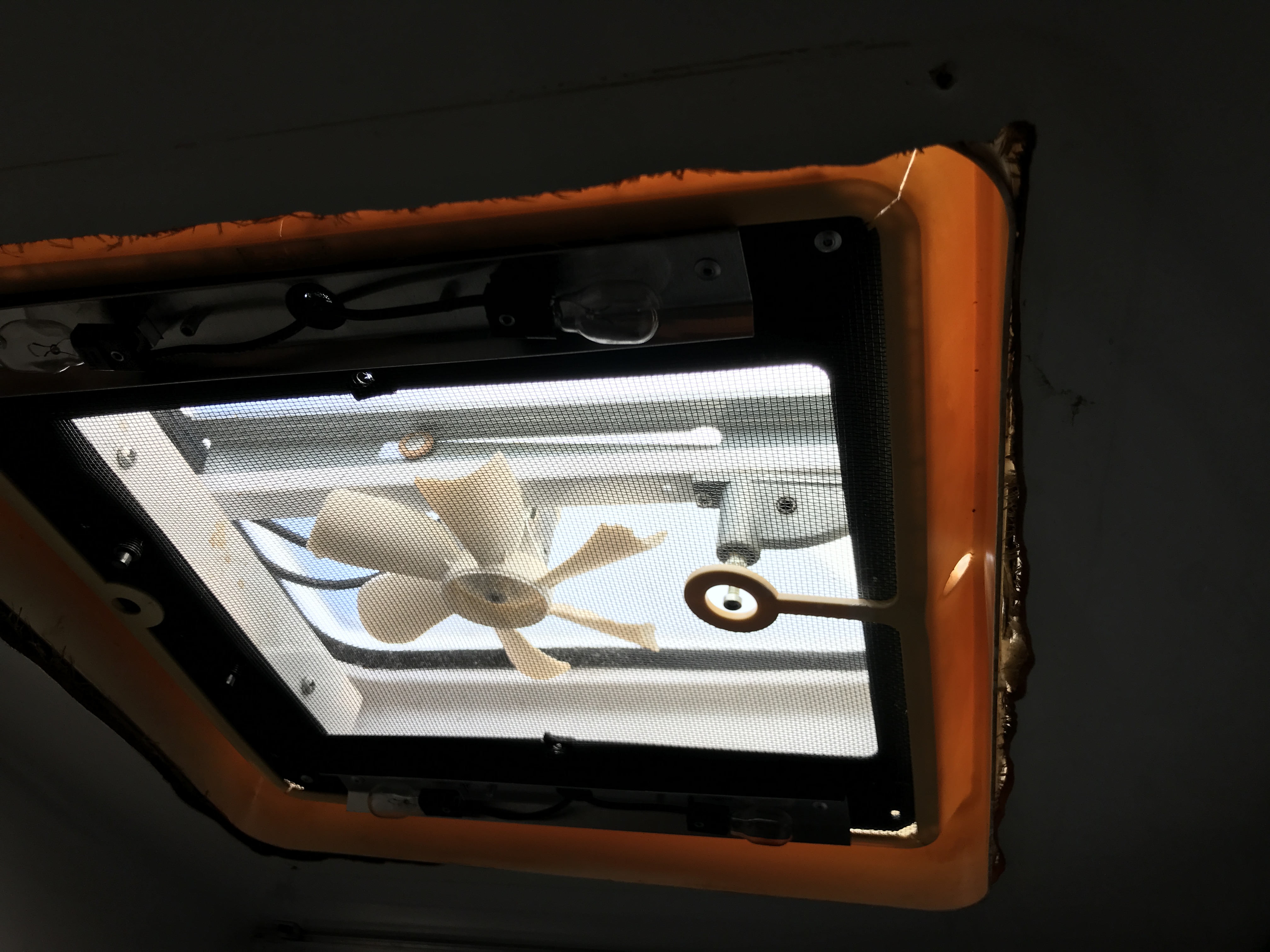

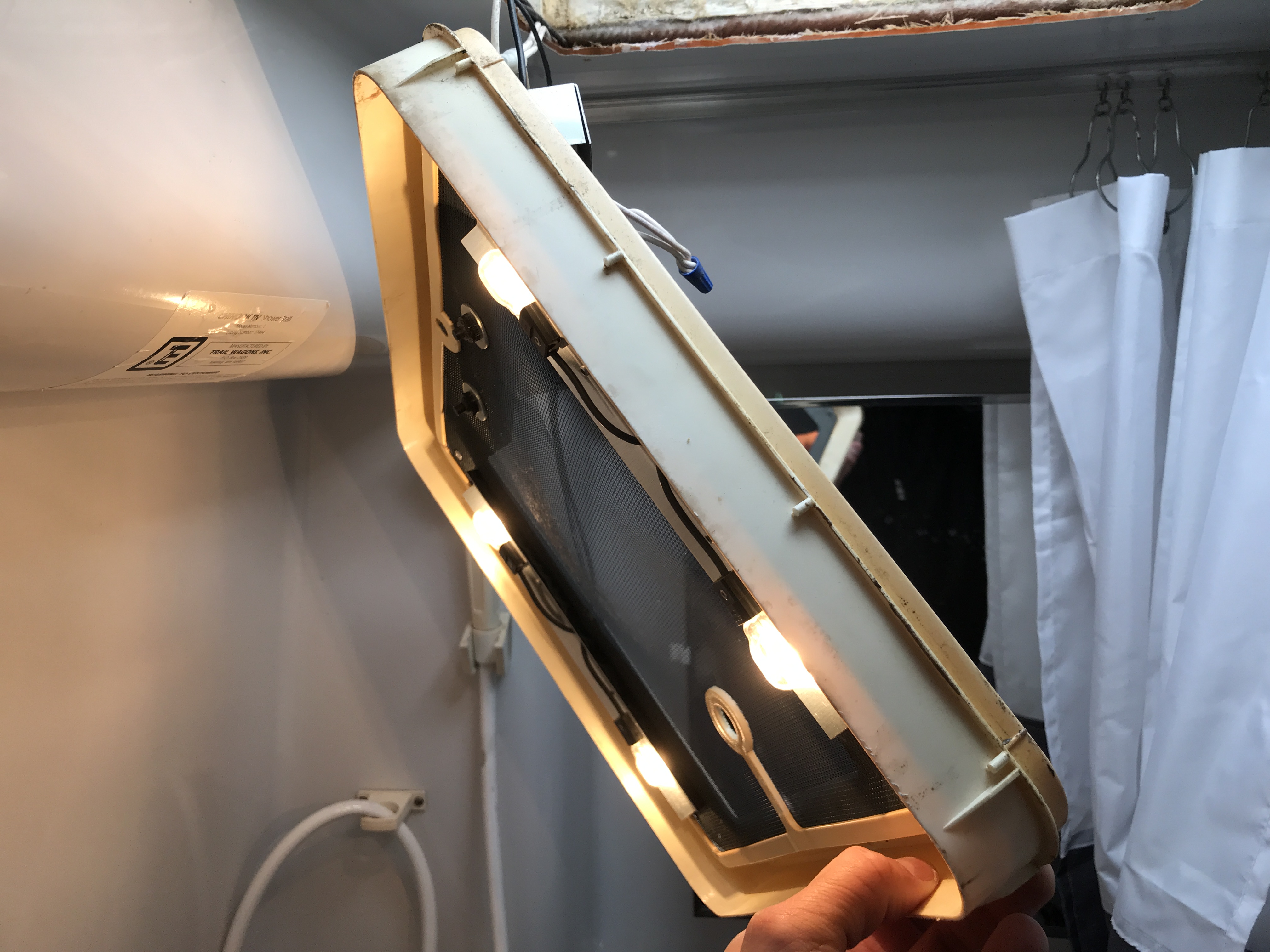

My bath light didn’t work, but the fan does, so I’m taking it apart and voila, the lights came on, then off. So there’s a short somewhere. Trying to take the housing off from inside and noticed that someone’s been there already. A couple of rivets are gone and replaced with screws and one plastic screw retainer on the housing is broken off but still present. I’m going to glue that part back in.

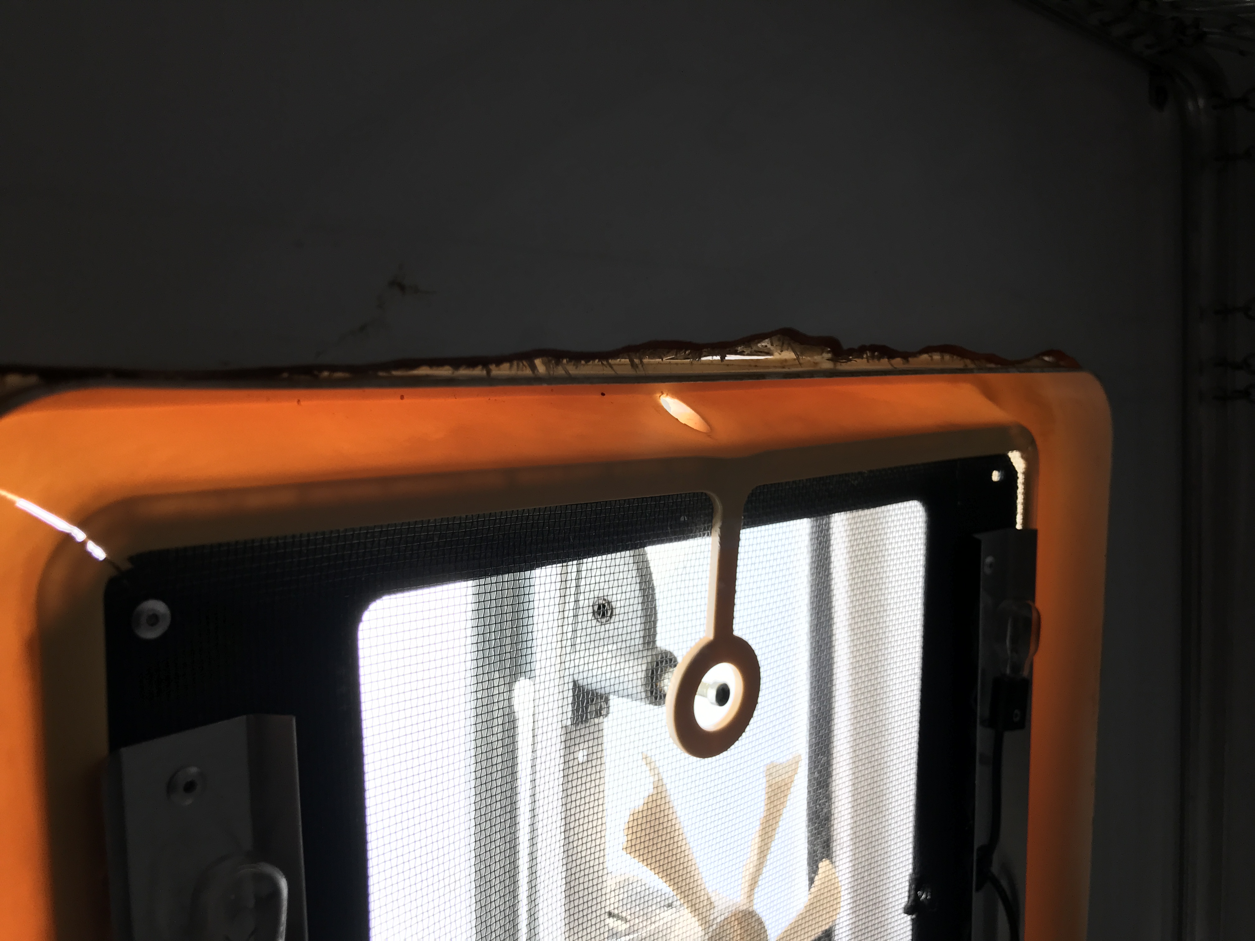

My point in this thread is that the fiberglass cutout is horrible and I can’t seem to get the housing out with altering the opening a little. I suppose they forced it in at one time. One would think the cutout would be nicer!

Don't feel bad. Mine certainly wasn't CNC laser cut, either. Not as bad as yours, but mine might be considered a personal safety hazard in the state of CA. "That's what trim is for," they chanted in the production meetings

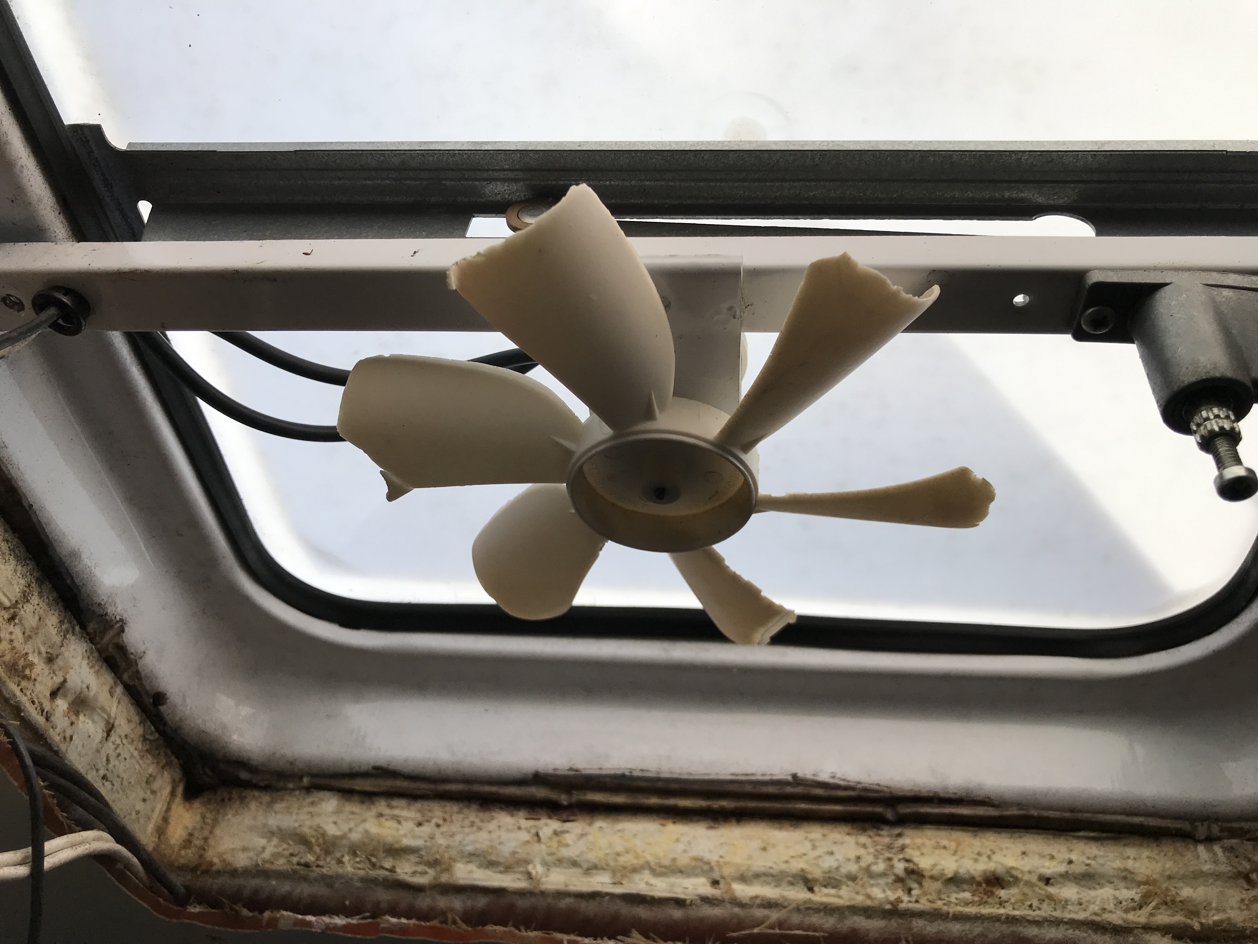

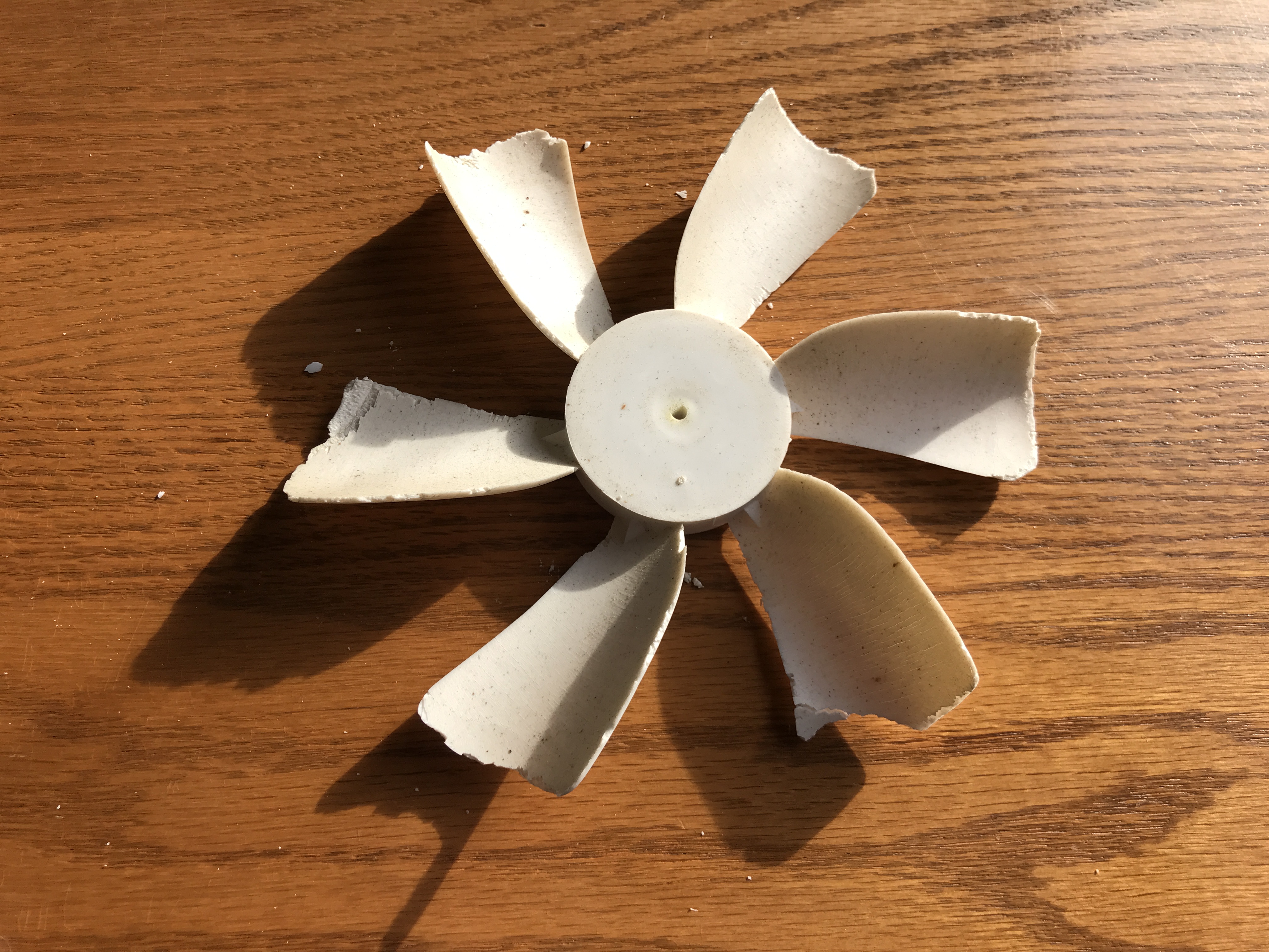

I talked about that very issue in a post awhile back. I had to enlarge the whole as it looked like a 10 year old installed it. I suspect they may have been put in from the top at the time they were built. My fan blade disintegrated a few months back and the light no longer works. I will more than likely replace with something else.

I took what I thought was a ballast cover off (I’m no electrician or even a smart guy with this stuff), and sure enough someone had messed with the white wires and didn’t tighten the wire nut very tight, so the connection was loose.
I’m glad it was just that, so I’ll be buying a new fan blade and trim, and putting everything back together soon. I kind of like things stock for now until I can get everything working, then upgrade later if I decide to.

I can't tell for sure what you mean, but just in case: The cutout in the fiberglass shower liner "roof" is only for getting the screen and garnish on and off. The main body of the vent comes off from the top. But maybe that's already obvious
My shower cutout was also was cut a little too large, so two of the garnish screws pulled out (they only had a couple of threads of fiberglass between them and the cutout. I epoxied a couple of wood blocks up inside (to the top/back side of the liner) to give the screws something to bite into (they only hold the garnish).

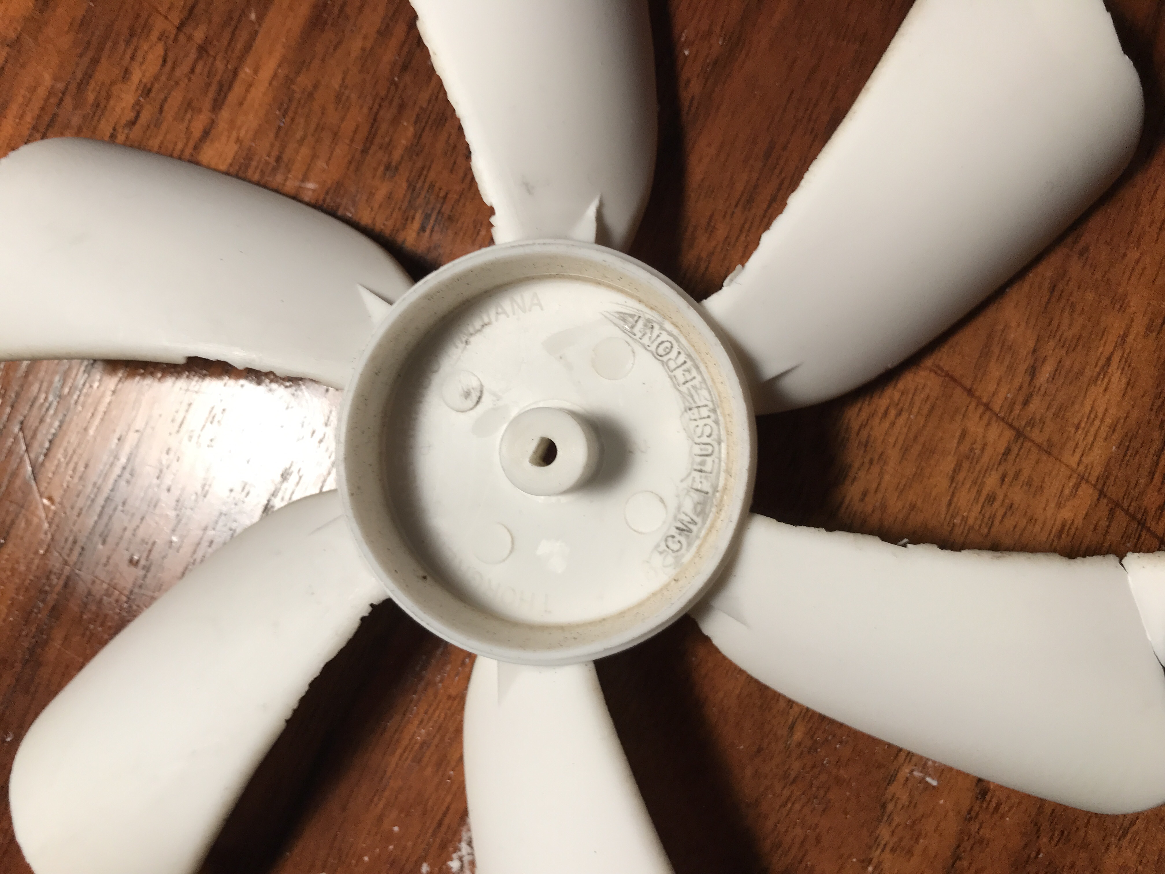

So while I’m waiting for my new fan blade to arrive, I noticed at an RV store that there are clockwise and counterclockwise fan blades!
I looked at my old one and see that the previous owner installed the blade with the flush side up. I reinstalled the blade and saw that it turns counterclockwise.
I’m wondering if correct blade shape dynamics makes a difference. I hope I’m not reading too much into this!
The photo shows how it was before I took it off. It looks like it would blow air up and out if going counterclockwise, but it looks funny with those angles on the blades.
When it turn it on, I feel air going in both directions, and yes, I opened the vent lol.

The inside of the blade housing says CW FLUSH FRONT.

Well this is timely. I was just looking at the hub of my fan (nothing else left) and thinking that if I could find another one, why not replace it (realized it just pulled right down and off). Guess what? Same inscription as yours, plus a few numbers that I was going to Google later this evening. I'll report back if I find anything.

Yes, the fan motor shaft is a D shape, and the impeller? just pulls right off. On mine, the flush side faced up, so it makes sense that if looking from the top (or roof), it would be going clockwise, hence their directions of flush front. That would move air out of the bathroom, so I’m glad about that. I ordered a new one from eBay for 7.99 free shipping.
