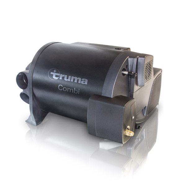

Interesting design of a water heater and furnace combination. European manufacturer. I was getting pretty excited about this concept, until... I found a US price of $2,900!!! Yikes

I got pretty interested in it a few years ago, but besides price I had a couple of issues:
1) It's too high to fit under the couch (unless you make the couch higher or the floor lower, neither of which thrilled me.
2) I read a number of reports of issues, and the repairs seemed expensive (although I can't recall details right now, and that may have changed).
It is a cool concept though - I mean how many different propane appliances does one need heating things?
I think I remember a self-winterizing feature. Can't remember how that was controlled (or maybe I didn't look into it further since I ruled it out).

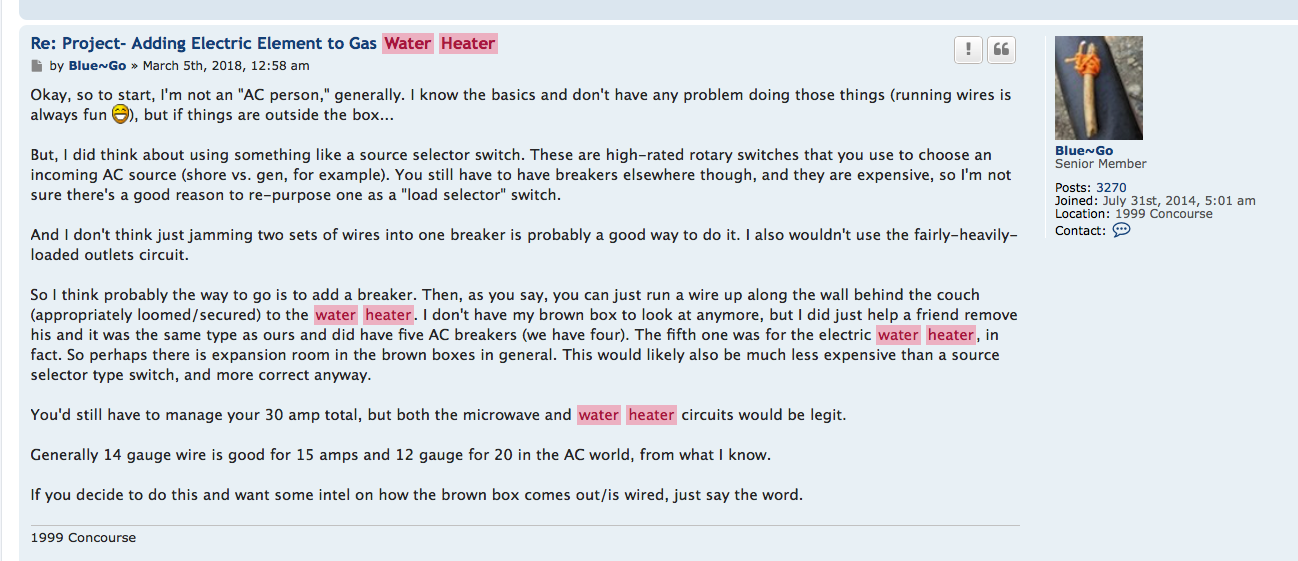

So back to my original plan... upgrade to a new Suburban SW6DE (elec/lp combo) for about $330. Direct fit with the option of heating with shore power electric. Per a topic a while back, Blue~Go suggested adding a fifth breaker to the brown box dedicated to the SW6DE. Since we only have 30 amp total service, I will need to select my use between the microwave or WH so as not to overload. I will be able to install proper wiring when the couch is removed for the "Dano Twin Bed Mod". The water heater and furnace are 18 years old on my rig, too. We usually use a Lasko ceramic electric heater to get toasty. Can't remember the last time we used the Lp furnace...hmmm, maybe more storage space?

I don't even remember mentioning an added breaker - maybe I have been here too long?

Blue...this still seems like a good idea to me.
To refresh your memory from waaaay back when.
