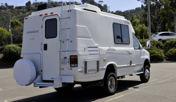

I'm in the same boat with you. I'm looking for a rig worthy of 100+ ski days. Even if I had to build one.
There's this beauty in SoCal. Built by a member here and most probably worth the flight.
https://sandiego.craigslist.org/esd/rvs ... 04775.html
Not exactly what I'm looking for, but...
