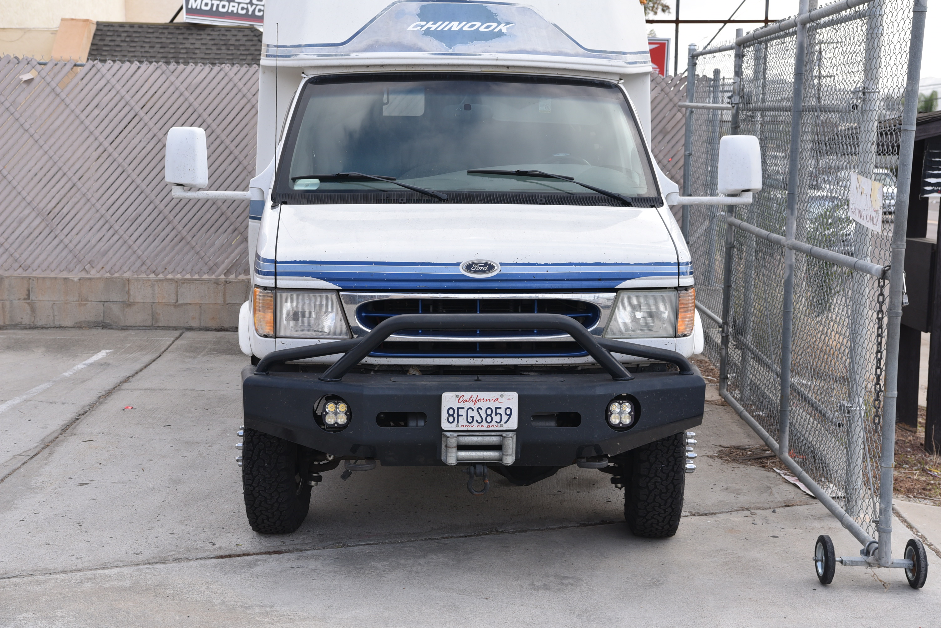

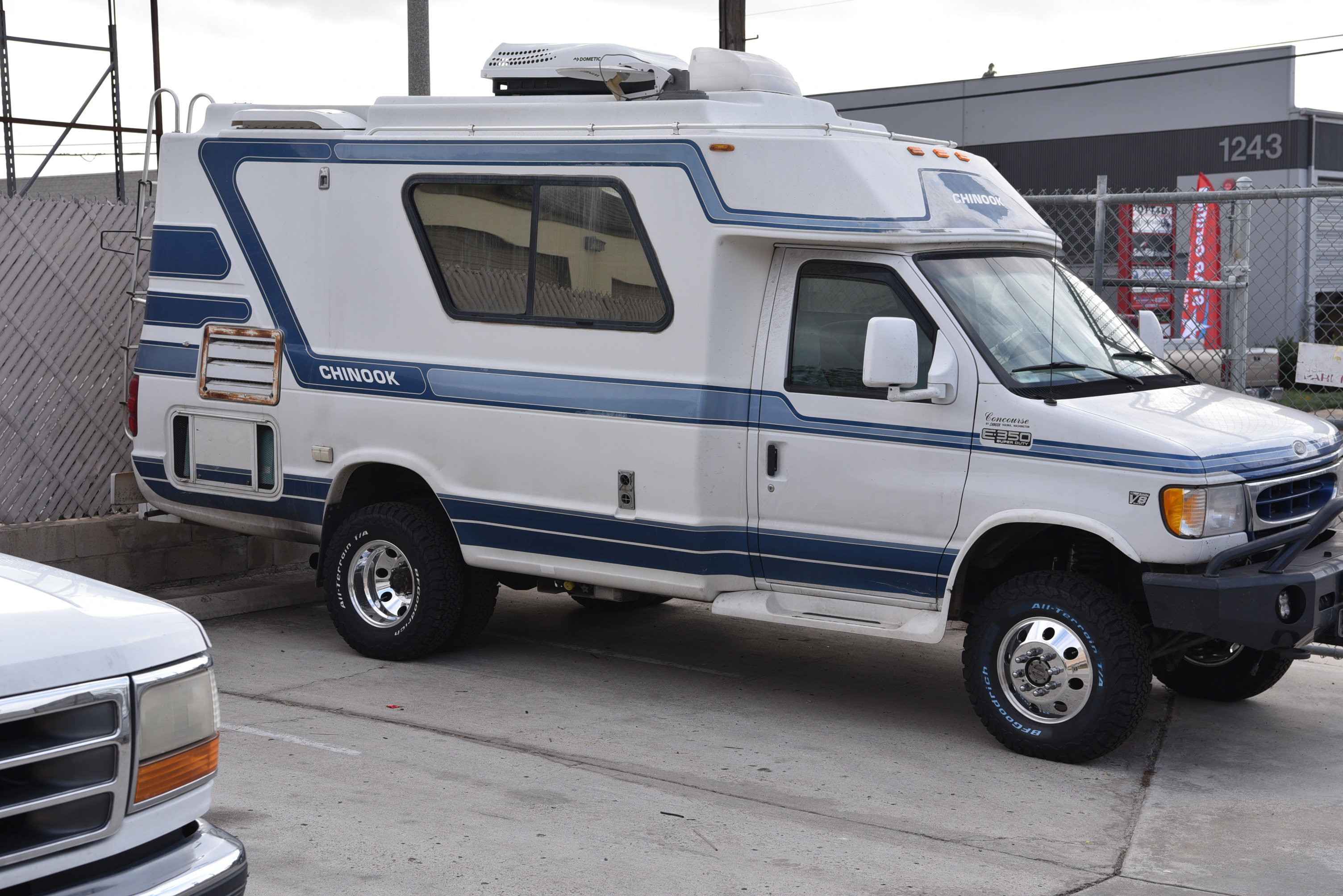

Major tune up done on the diesel (7.3) approximately 50 hours of labor; 4 wheel drive conversion is complete; Front bumper with warn 16.5 Ti winch and digital lights installed; Seven new 235/85/16 BFG's and new Alcoa aluminum forged wheels installed; New ac unit; propane generator serviced; Now it is time to make it prettier; The stripes will have to be completely removed or repainted; MDF on inside needs extensive replacement with oak plywood. The saga continues...

Whose front bumper did you install? Any idea on weight?
I was looking at a Weldtec but they stopped making them until they get a new fabricator/welder.
Right now I have narrowed down to Ujoints own and Move Bumper.

Where did you get those wheels!!!
My Chinook needs a 4x4 swap!

I'm curious about the lug nuts. Did you get them from Alcoa? I'm tired of the lug nut covers I'm using.

I love the aluminess products but I did not like the look of their front bumper. I bought this bumper from a company called Buckstop; It has more of a baja look. I bought the wheels and lug nuts on ebay. I think I paid $800 for the Alcoa rims.

Its looking great Mark, I do like the flare the alcoa's add to the overall profile. I am very interested to see your interior work for ideas / confidence to tackle some in my coach.....
