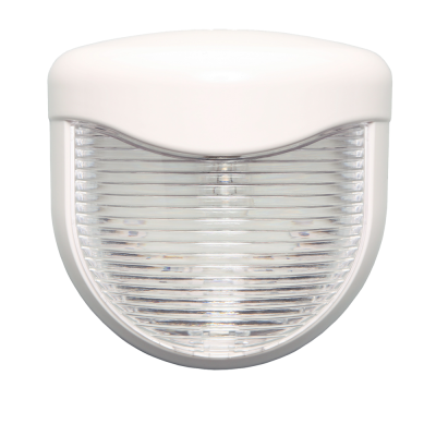

Like other discontinued items, you can upgrade to an alternative that is available. Like this Bargman #80 series porch light fixture. Check dimensions, but looks like it would cover the existing hole.
Bargman LED porch light

Thanks for the input. Looks like I'll take the advice and replace the fixtures.
