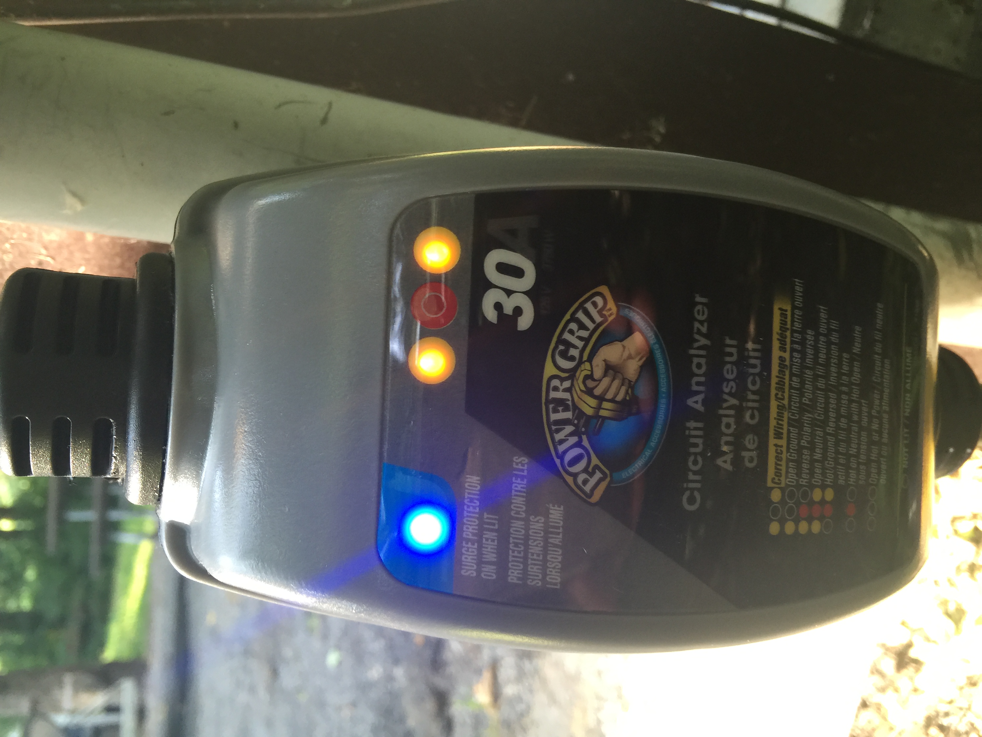

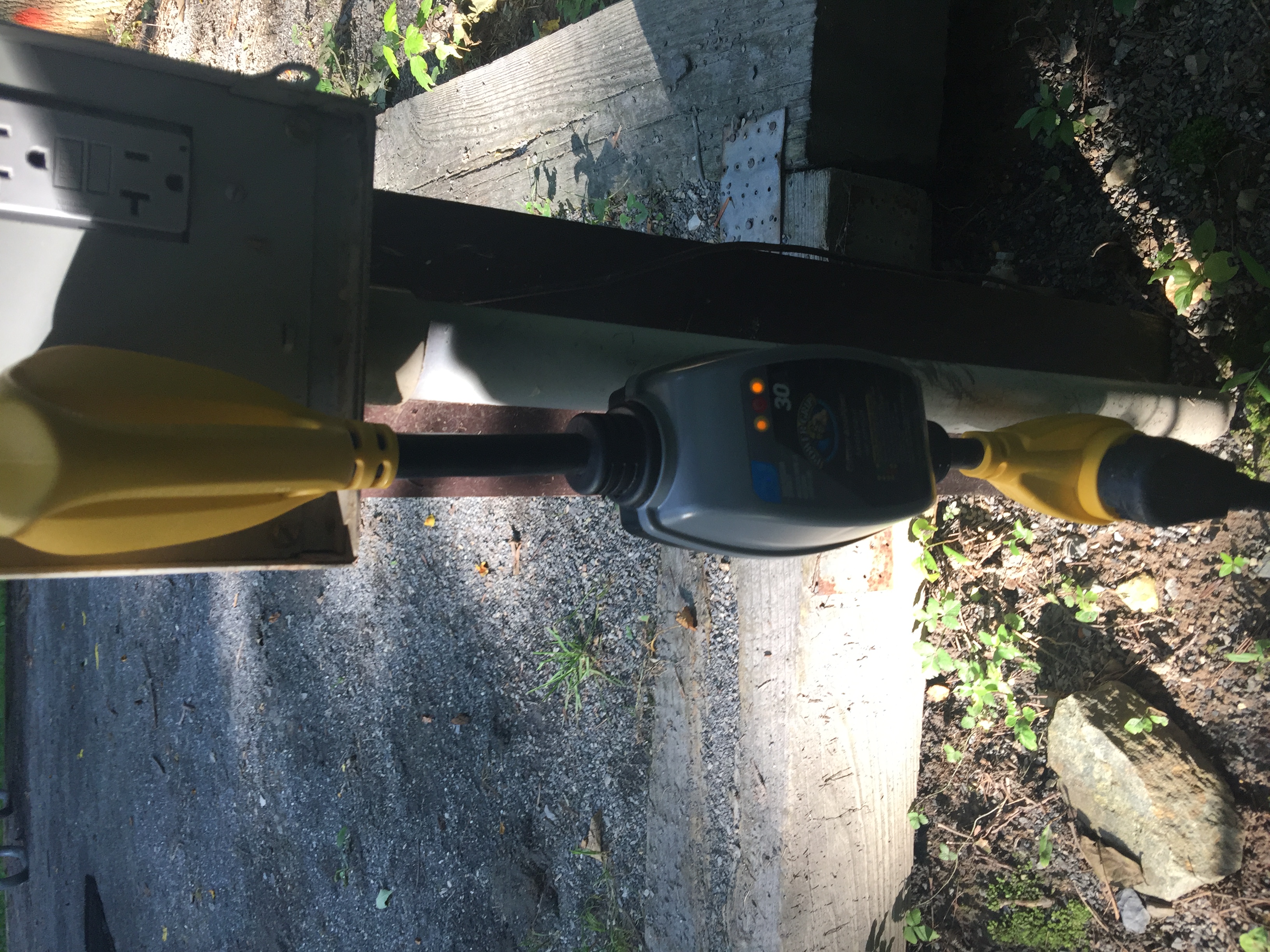

I ended up buying a circuit analyzer/ surge protector with a 2100 joules rating. It's not a compact size but it's easier to see if the wiring is correct before plugging in to the pedestal. I believe I'm going to get a small chain and lock before it walks off.

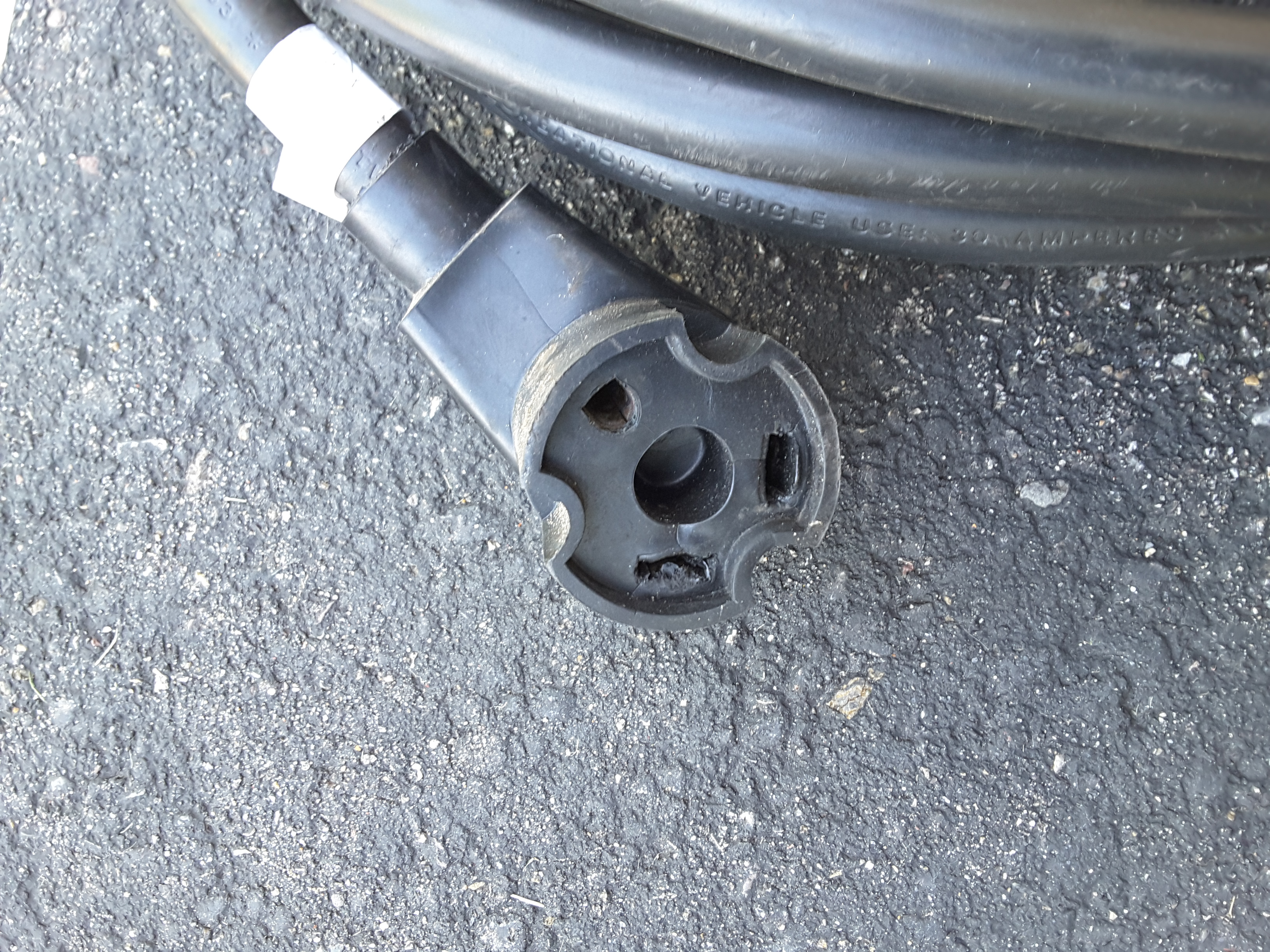

Surge protectors. I have been reading alot about them lately. Is this a must have piece of equipment? It sounds like it is and I am trying to buy things for my new rig in order of importance. And, while I have you here....this power cord came with the Concourse. It appears to be fried on one of the sockets on the receptor end. Is this also an important piece of equipment that I should replace?

Presuming you plug in, then a surge protector can be useful to protect your shore power system. Progressive Industries is a popular brand.
If my reply so far sounds a little generic, it's because I almost never plug in and don't have a surge protector; likely other folks here can give you more specific advice.
On the shore power cord though: Yes, I would say by all means replace it. These can cause a fire. If I were plugging in on a regular basis, I'd switch to a Smart Plug, but at least get a new one of some sort. I did help a buddy install a Smart Plug and it was relatively simple (he plugs in on a regular basis).
