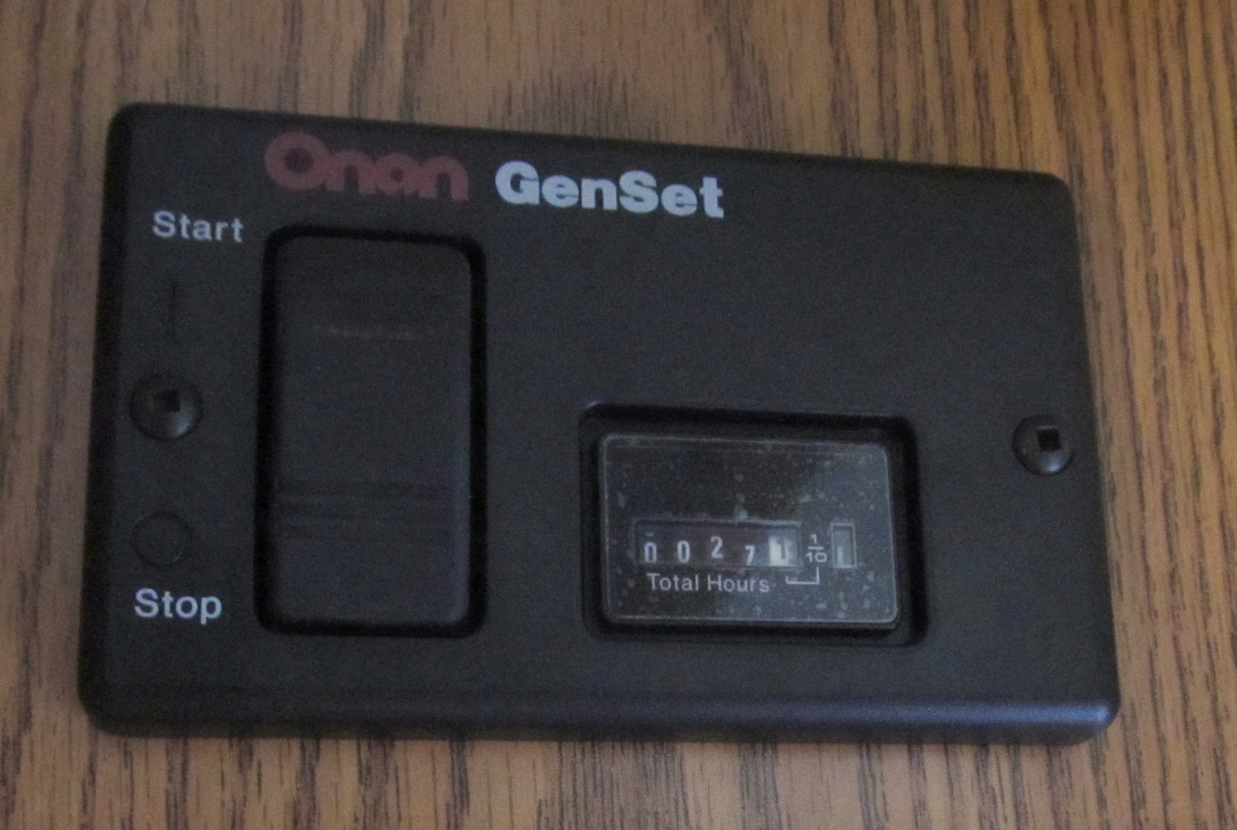

For reference, this is what my stock one looked like on an Onan 4000:
It was kinda dark because it was a photo that was actually of something else nearby, so I lightened it up but it looks a bit grey now.

Blue~Go wrote: June 16th, 2020, 3:50 pm For reference, this is what my stock one looked like on an Onan 4000:
I have that without the meter. One in the cab on the ceiling, one to the right of the fridge on the wall, and the one on the generator itself. No meter on any of them.
Could I just replace the one by the fridge with this, connect using the wiring harness currently in place, and it will start ticking?

yes, it should be simply "plug and play" if you have the Onan MQ4000 like most of the Chinooks. The wire harness from the genset to the remote panel is standard, so it should have everything you need if you decided to add the hour-meter. Obviously, you need to enlarge the opening, so make sure it is working properly before you do the cut.

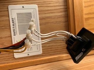

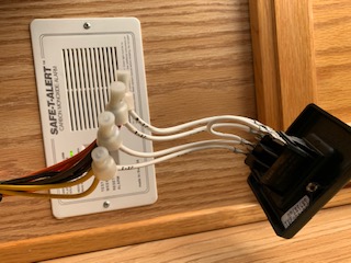

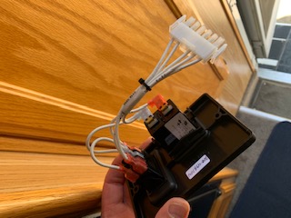

So, not exactly plug and play. Looks like there will need to be some splicing done here. Any suggestions to where I can find what goes to what? I guess the wires to the start switch are the same, but what of the meter?
