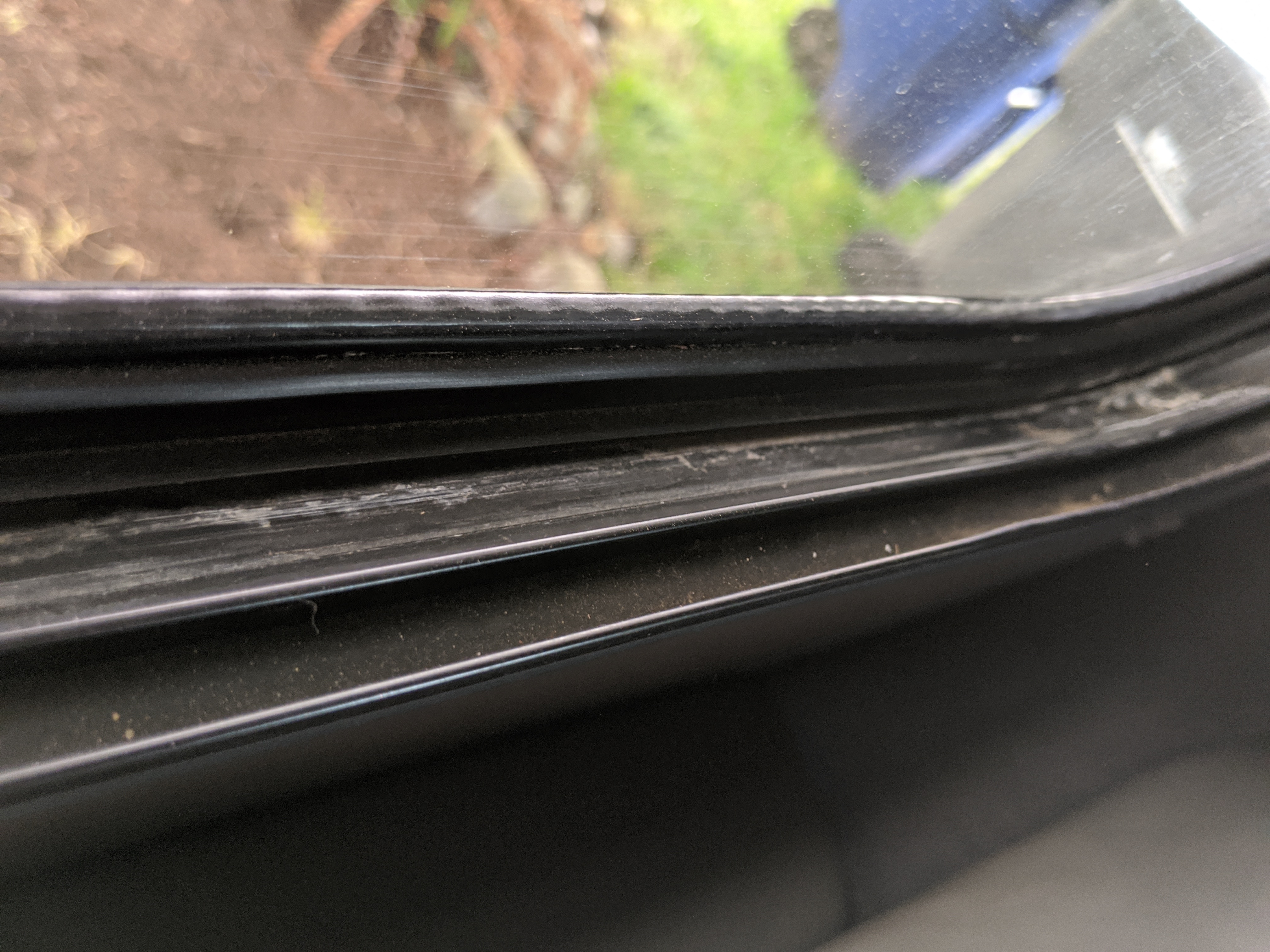

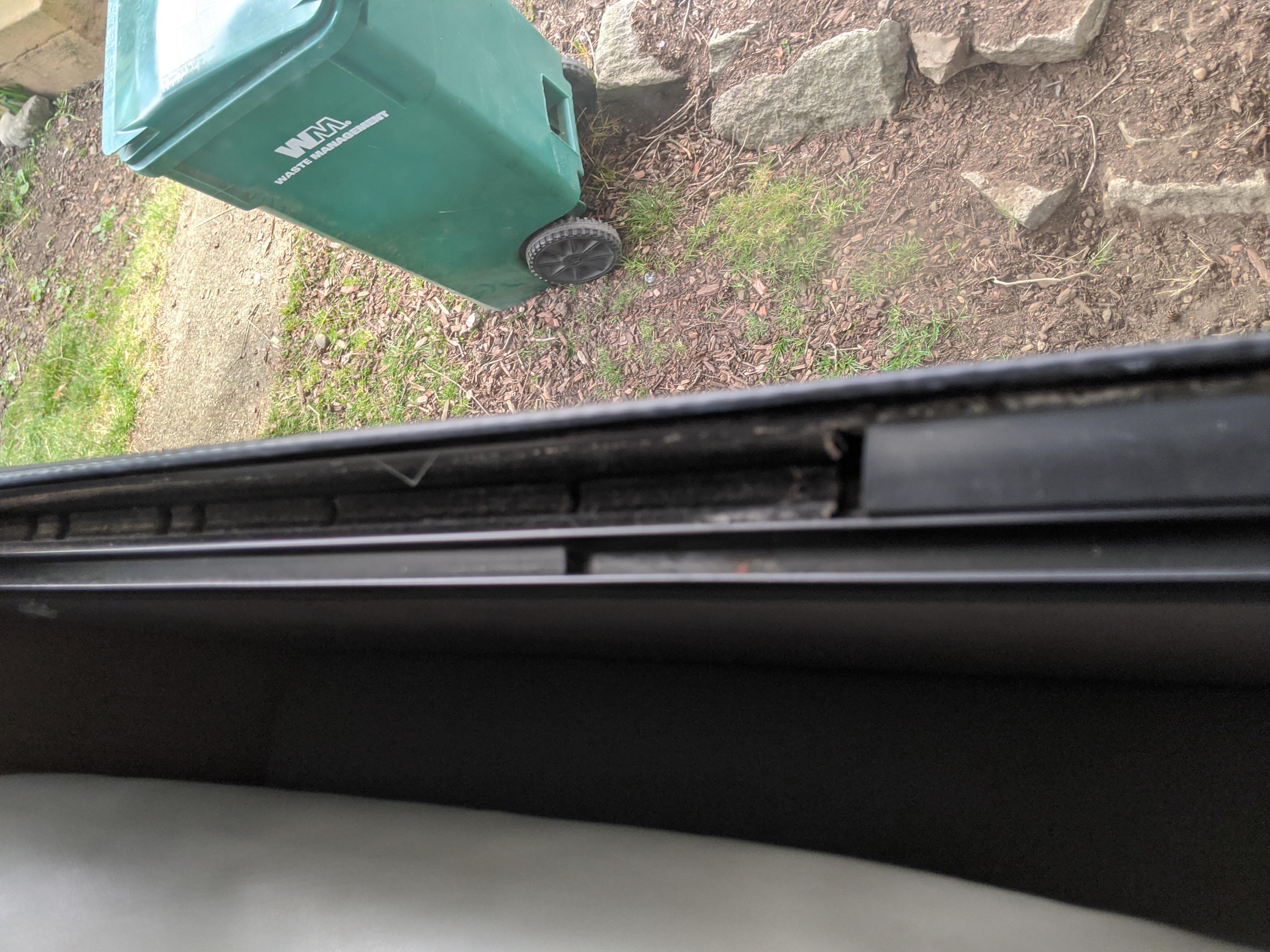

We just purchased a 2003 Destiny and are getting familiar with it. I noticed after it rains there is moisture on the inside track of the sliding window. I looked at some previous posts and tried cleaning the weep holes by blowing them out with my compressor. I tested by spraying over window with hose and it's still happening. It appears this has happened to others, but I couldn't determine if it's normal or if it could be a problem. Has anyone managed to solve the problem, or is it something I can live with?

I will get some water in the inside window track in certain extreme rain/wind conditions. I believe it comes in where the fixed pane and movable pane meet. I've read similar from other owners. The track and seals look to be in good condition on mine, so I don't think it's because anything is worn out.
In order for this to happen there has to be a LOT of rain, and it has to be coming at a certain angle. So it never happens to both sides at once (driver/passenger), but only on the exposed side.
Usually, it will just run harmlessly along the track and then exit via the weep hole.
A couple of times I've put a paper towel or rag there to soak it up. These were times during a desert downpour (these can be HUGE), where it was something like 3" of rain in a short period of time (with just the right wind).

My windows were made by R.J. Sampers (who??) and the gutters get wet all the time. Keep the weep holes clear and no worries.
I have some sort of hornet who likes to fill my weep holes with mud so I clear them a few times a year. A wood toothpick works nicely.

I took a closer look yesterday (by coincidence it rained really hard about an hour after I posted), and the water definitely comes along under the movable pane and there is a teeny gap at the lower/forward edge of the movable pane, and that's where water flows along in certain situations. Perhaps that gap could be closed, but OTOH, the movable pane does have to move. I do notice the other side doesn't tend to flow water, and that window takes more effort to open and close.
Also what might compound it is that my Chinook tends to sit higher in the rear and lower in the front and I don't "level that out" typically when I'm camping or parking.
