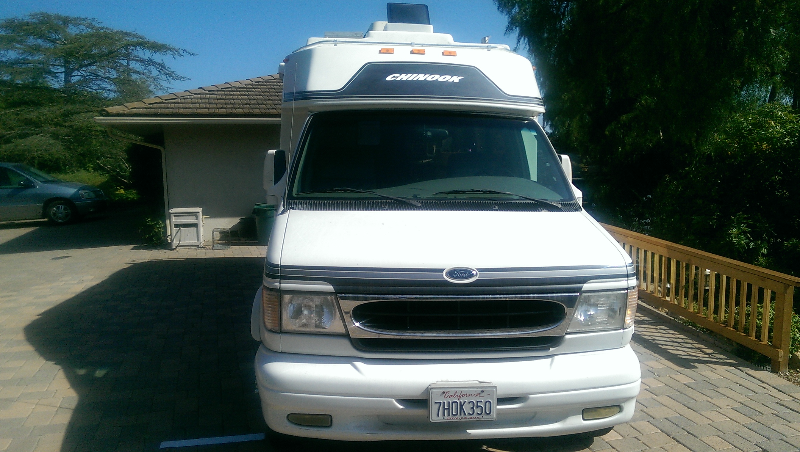

Here is a new picture of my Chinook from the front showing my new paint job of the trim over the cab, along with the fairing and open fan. (The paint is darker than the original silver because the paint company messed up, but they gave me my money back, and it still looks way better than the old peeling clear coat.)
