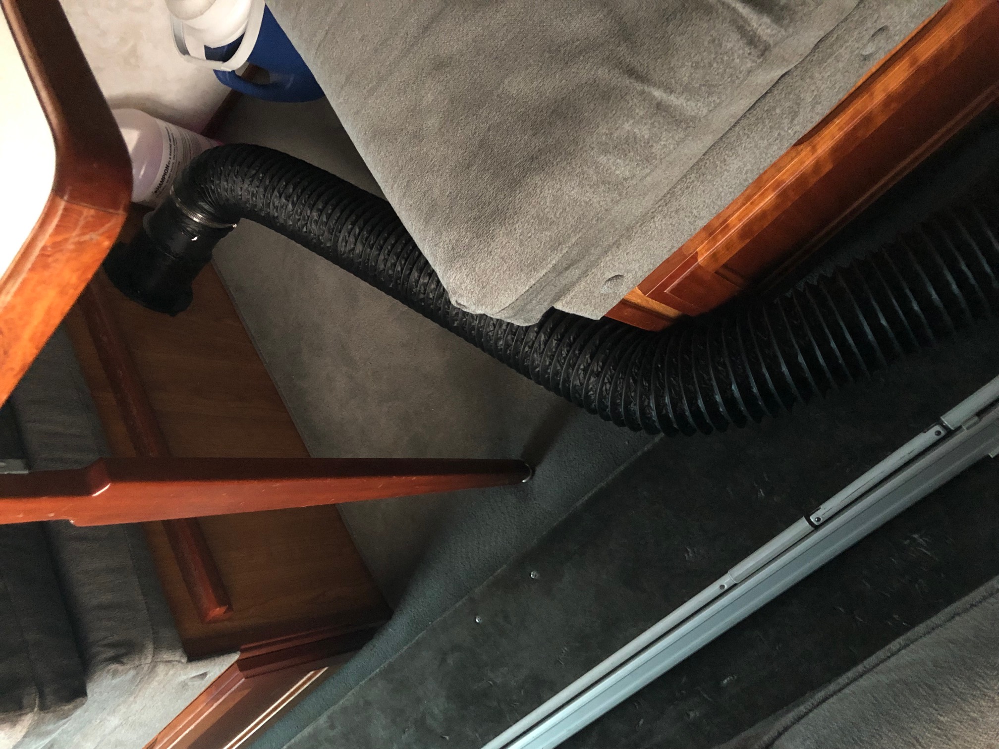

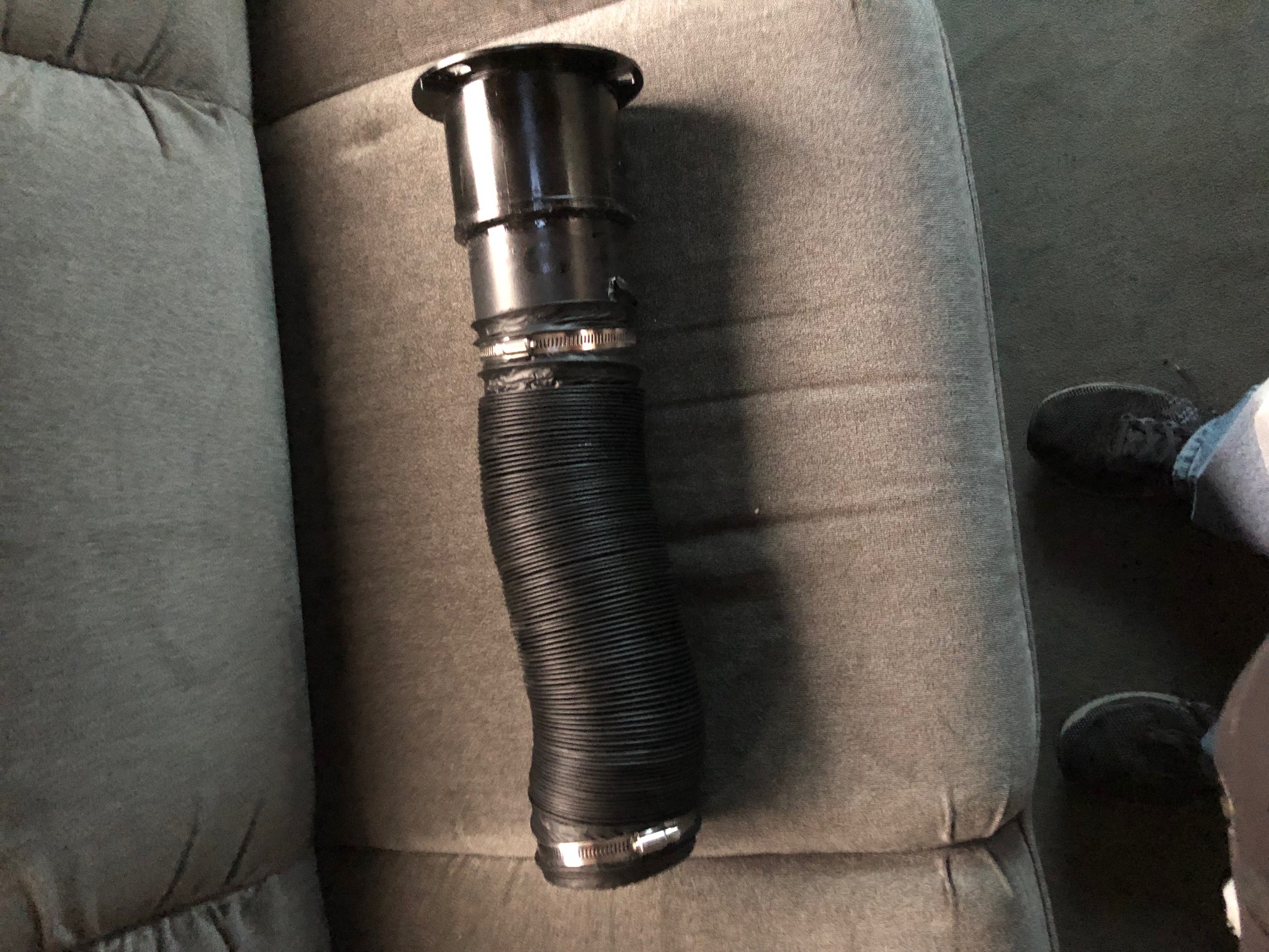

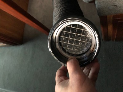

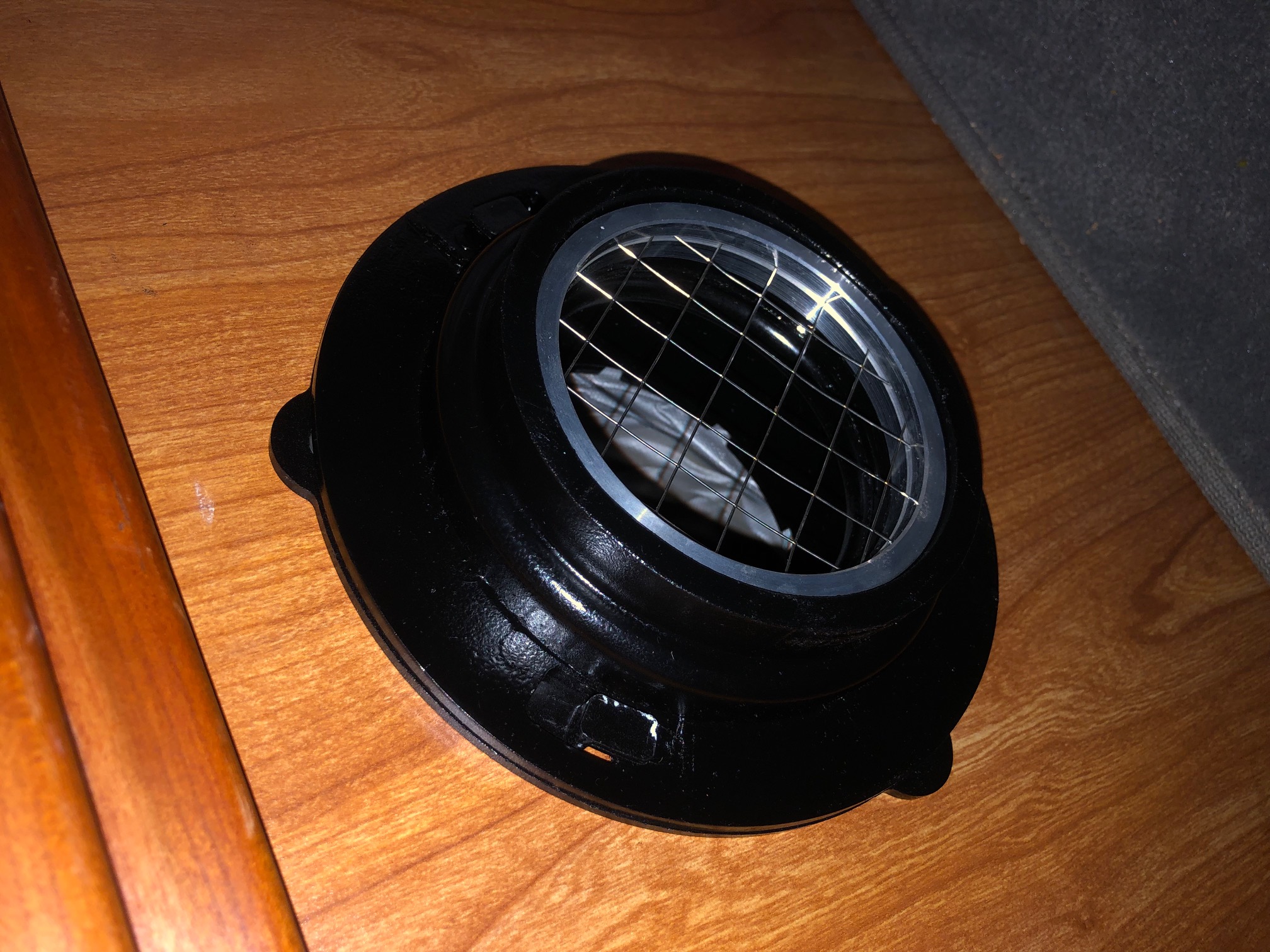

Ever since I heard that some of you have an additional heater vent in back somewhere below the frig, I have been jealous and trying to think of a good way to get some heat to that area--particularly when the dinette is collapsed to make a bed (which is how we sleep). I have never liked the way the heat gets trapped under the bed at night with nowhere to go but up into the bottom of the bed, which doesn't help much of anything. So, with Covid isolation time on my hands, I have come up with what I think is a decent solution. Using a "dryer hose quick connector"--essentially a two-piece plastic collar with bayonet connects...the fixed bayonet side of which screws into the dinette base (replacing the existing plastic vent) with the other piece attached to a 4' heater hose via a pvc connector (pictures of all this to follow). I purchased two of these connectors, so I could use one attached to the hose and another just as an open vent (with screen) for use when the dinette is in the upright position (hence hose not needed). This now means that I can direct air to either the area under the couch (think water lines under there) or out to the edge of the bed and into the back "hallway"...think easier for heat to rise, and a warmer bathroom (door open) for those night-time trips so necessary for us people of a certain age :)! And, just to put icing on the cake, I have ordered and will install an upgraded propane heater (Suburban NT 16SQ model 2444A) that only draws 2.8 amps and ups my current 12,000 btu output to 16,000 btus. It fits into the current location and uses existing fittings.
I don't imagine that this will give me the capacity to do serious boondocking in sub-freezing locations...but it will address my particular concern of being able to have really adequate heat for those nights I am traveling in cold climates when no electrical hook-up is available--and not have to worry about waking up to drained House Batteries.
Anyway...in case anyone else is interested, here are some pics of what this set-up looks like.

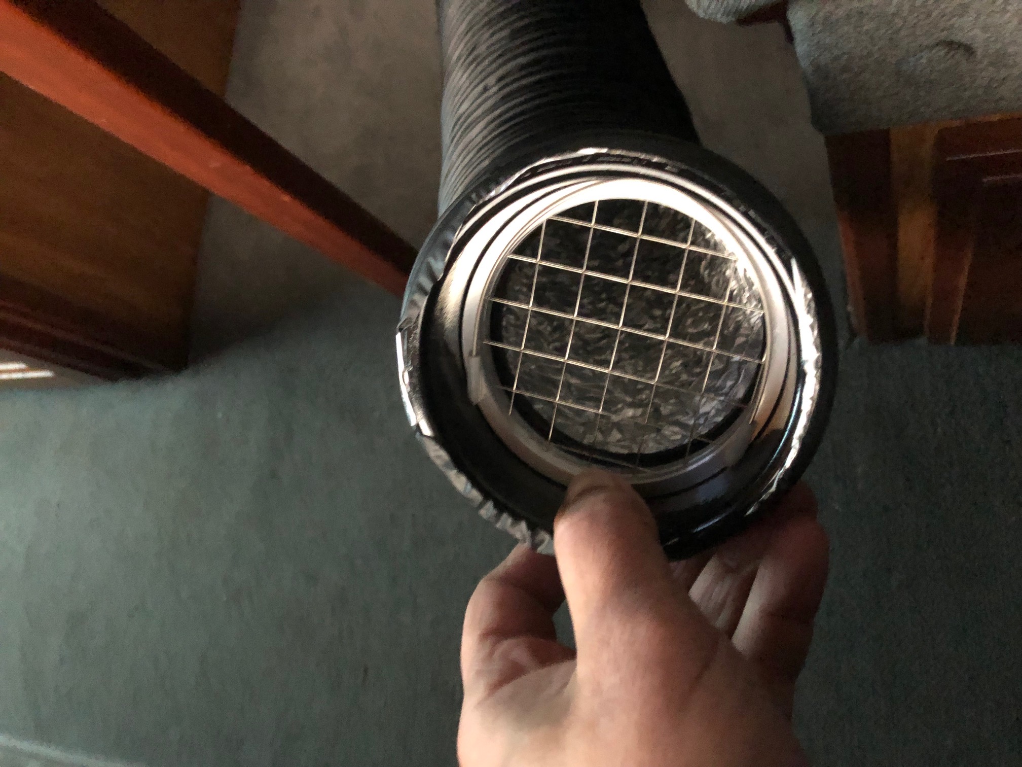

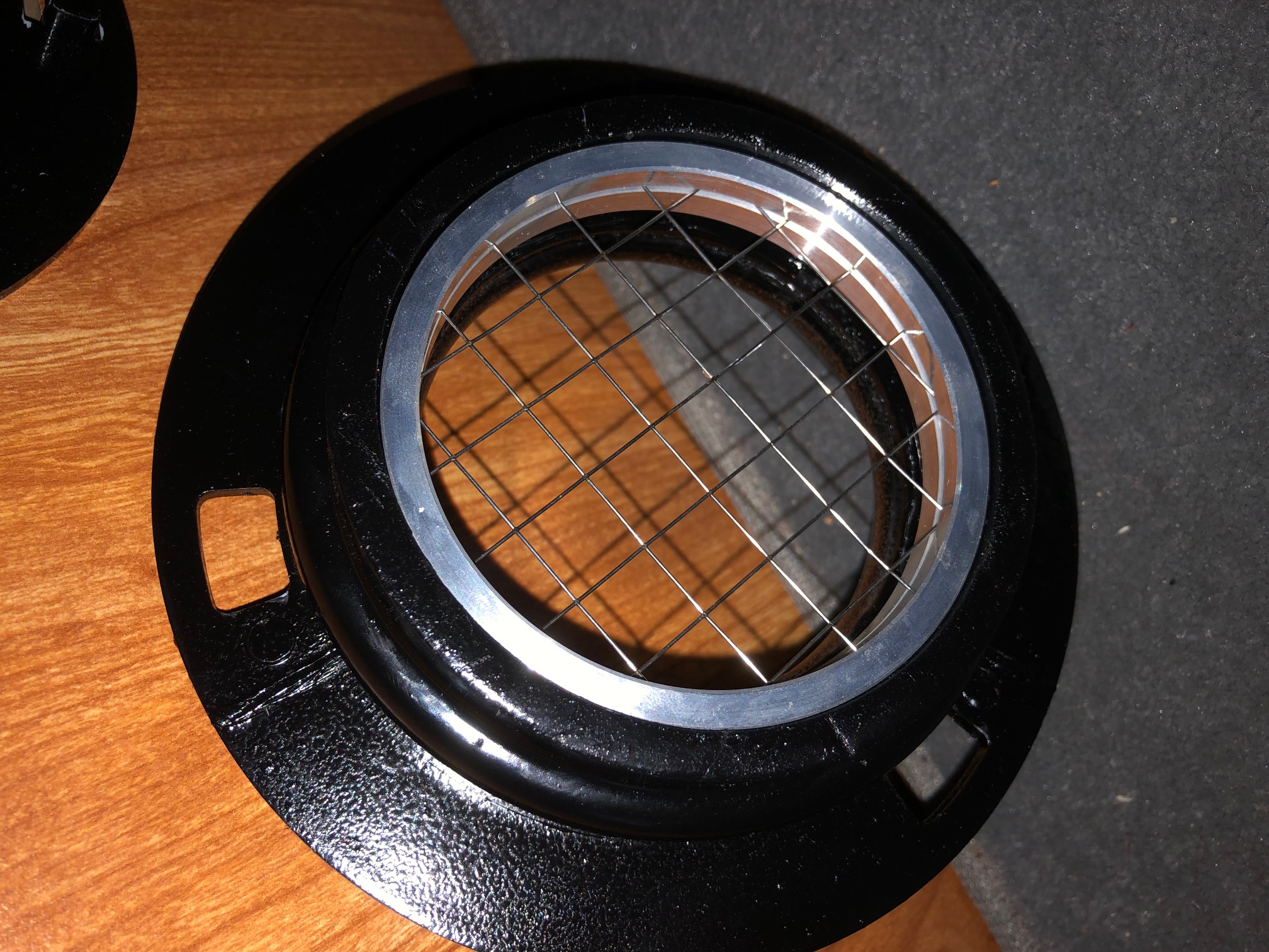

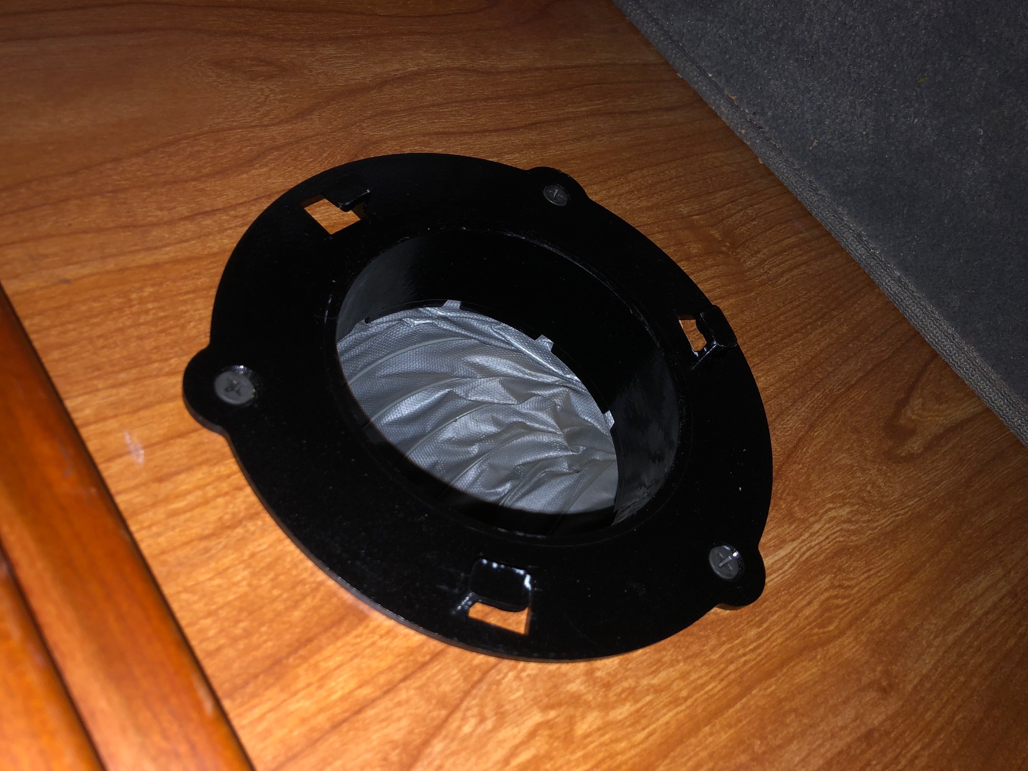

As follow-up to previous post, here are the final 3 pics of my new heater hose set-up
Re: Better Heat Distribution from Dinette Vent
What a great idea!
I have the club layout, so no problem with heat coming out from (the furnace I removed) under a bed, but dang, that bathroom is nippy! The thought of heat blowing out back there is glorious.
But yeah, there's not exactly a great path for a duct. Between the generator box and the fridge they kind of cut you off at the pass as far as getting all the way back by the door. I have had an idea to run a duct in very outboard side of my aft club base (above the wheelwell), then behind the oven area, and around the corner in aft end of the wheelwell on the floor in that cubby aft of the wheelwell, then out the face of the "toe kick area" at the aft end of the stove (this is just behind the wheelwell/just ahead of the generator box). Then aim the louvers aft. Basically you've already accomplished that, ten times more simply :D Plus you can heat the area under the couch. Bonus!

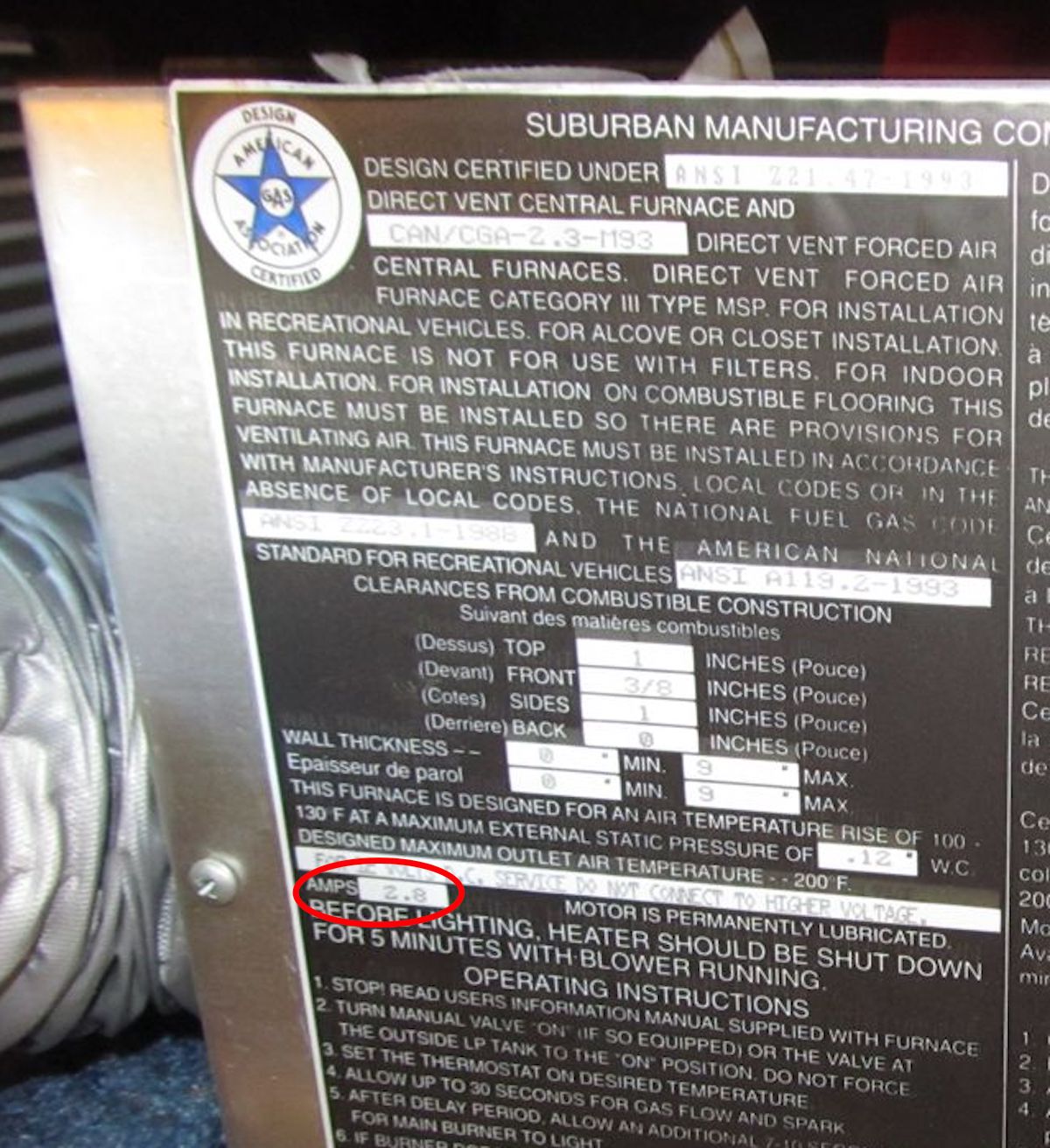

Then I got curious as to what the amp draw of my original furnace was (1999 original Suburban 16S). I had this idea it was 6 amps or more. Lo and behold it's also/only 2.8 amps. That said, mine is missing the "Q" part, and that quieter operation should be very nice on your new one.
Here is what I looked at to check. Mine is packed away, but I had taken this photo of the front plate when I was removing it. So now I'm curious: Did your original one draw more?

I too cogitated a bit on some sort of permanent duct run...but the combination of routing and being close to cold wall deterred me. Then I happened upon this "quick connect dryer vent"...and the rest is history as they say.

So, low and behold--my 2004 Suburban NT12s furnace also says 2.8 amps!
Must confess that I have a hard time believing that given all the info on amp draw of typical rv furnaces online, and the touting of low amp draw of the new model (why would they talk about that if its the same as it was in 2005)??? But, I have already ordered the new model, and it does produce 25% more BTUs AND it is supposed to be noticeably quieter...so, I'll stick with the plan. Must have saved at least that much by not going out to dinner over the past two years :)

I know! I was almost disappointed to see that. I would still rather put in a Propex, but I thought huh, if I buy a new one of the Suburbans it will just drop right in, and 2.8 amps isn't all that bad. Then I looked at those old photos and saw the original 1999 one also only drew 2.8 amps. And it works just fine. Hmmph.
That said, quieter is nice! I think it was bfischer that put in a new one and did say it was quieter. I wonder how much quieter it is? Please let us know what you think when you put in the new one. And the high draw isn't a myth: My buddy's late model Airstream (2017-ish) had a stock furnace that drew around 7-9 amps. That sure adds up.
