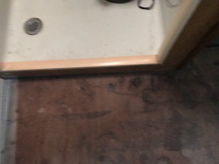

Damage in front of bathroom door.

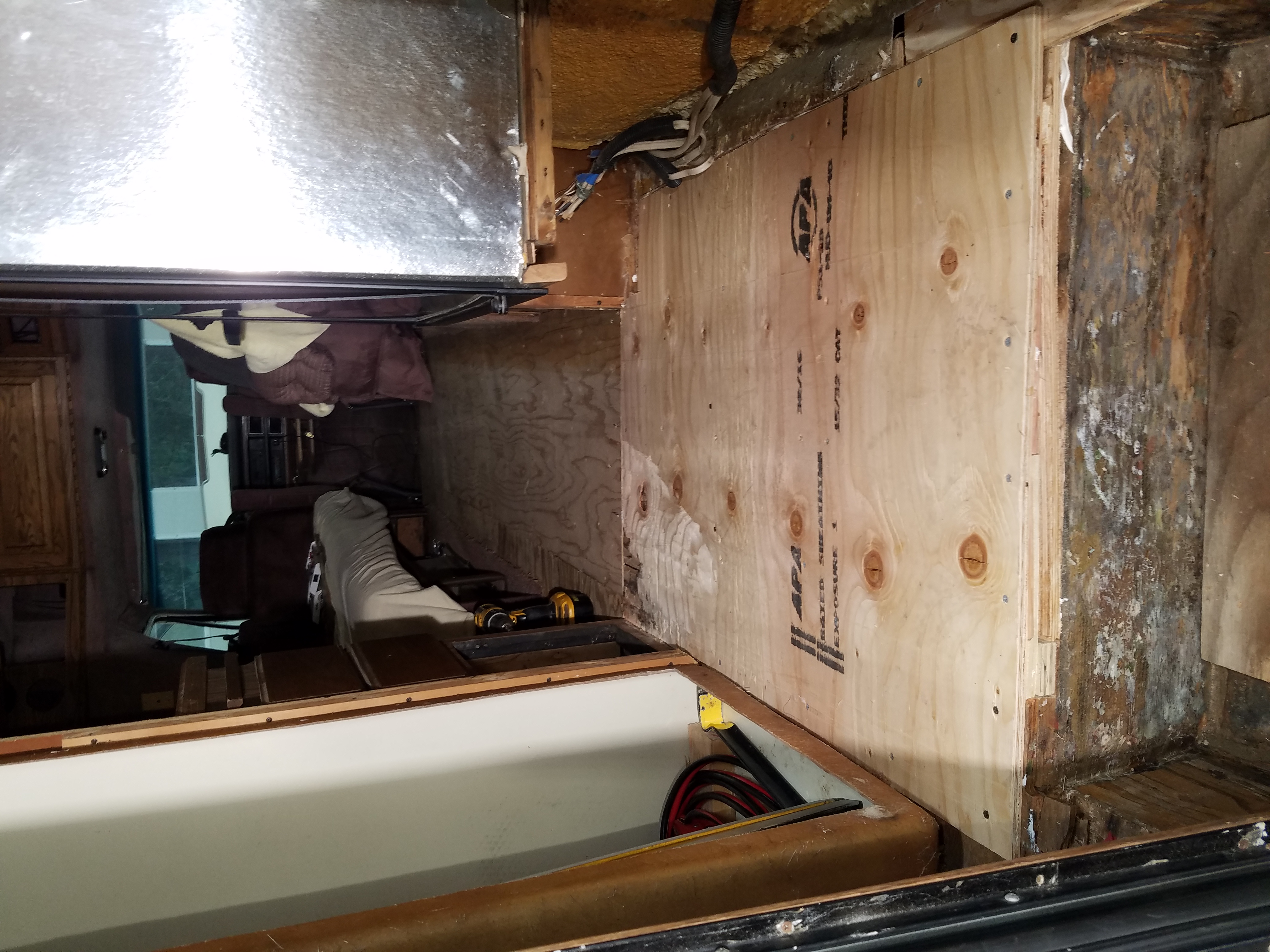

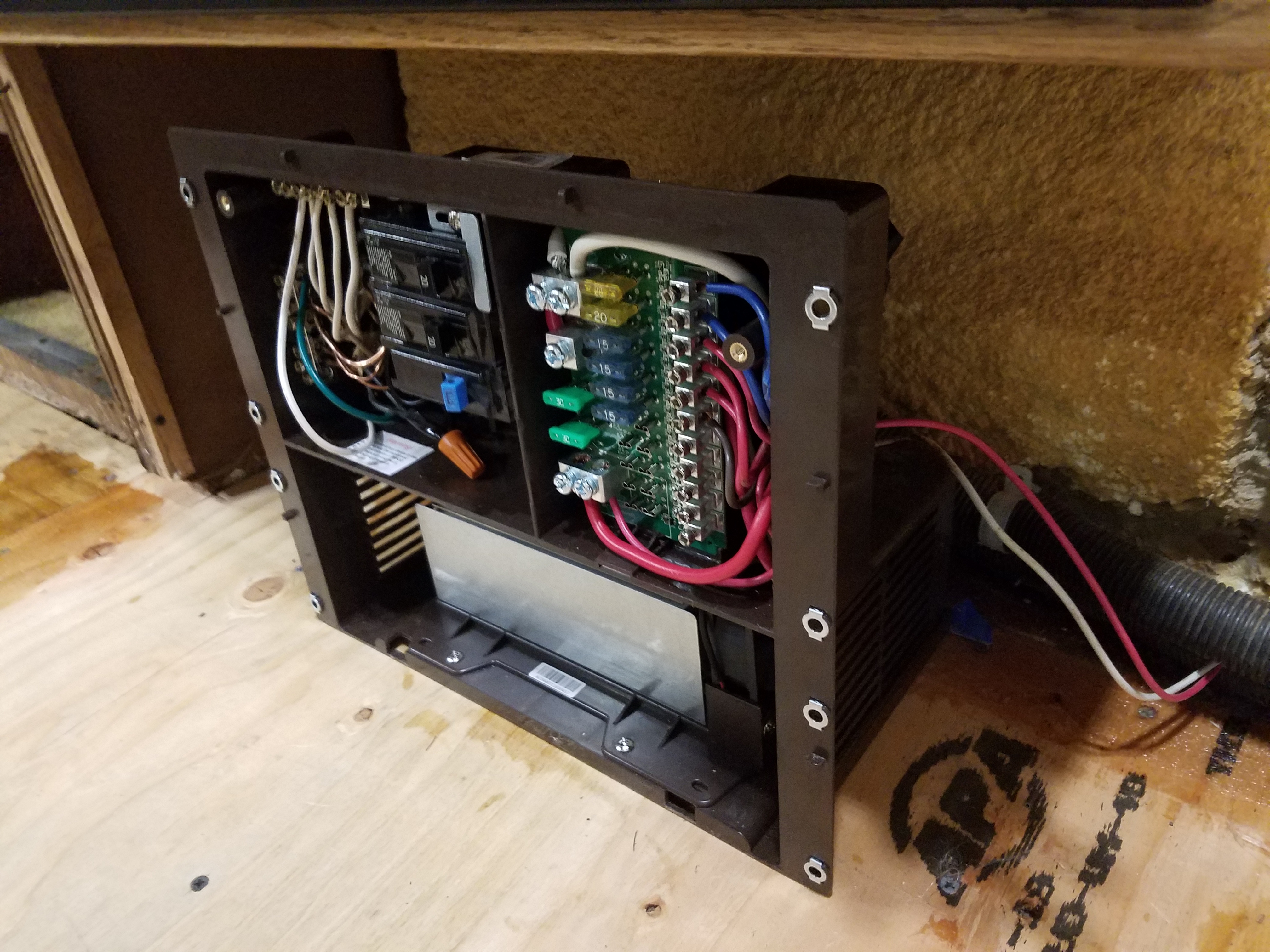

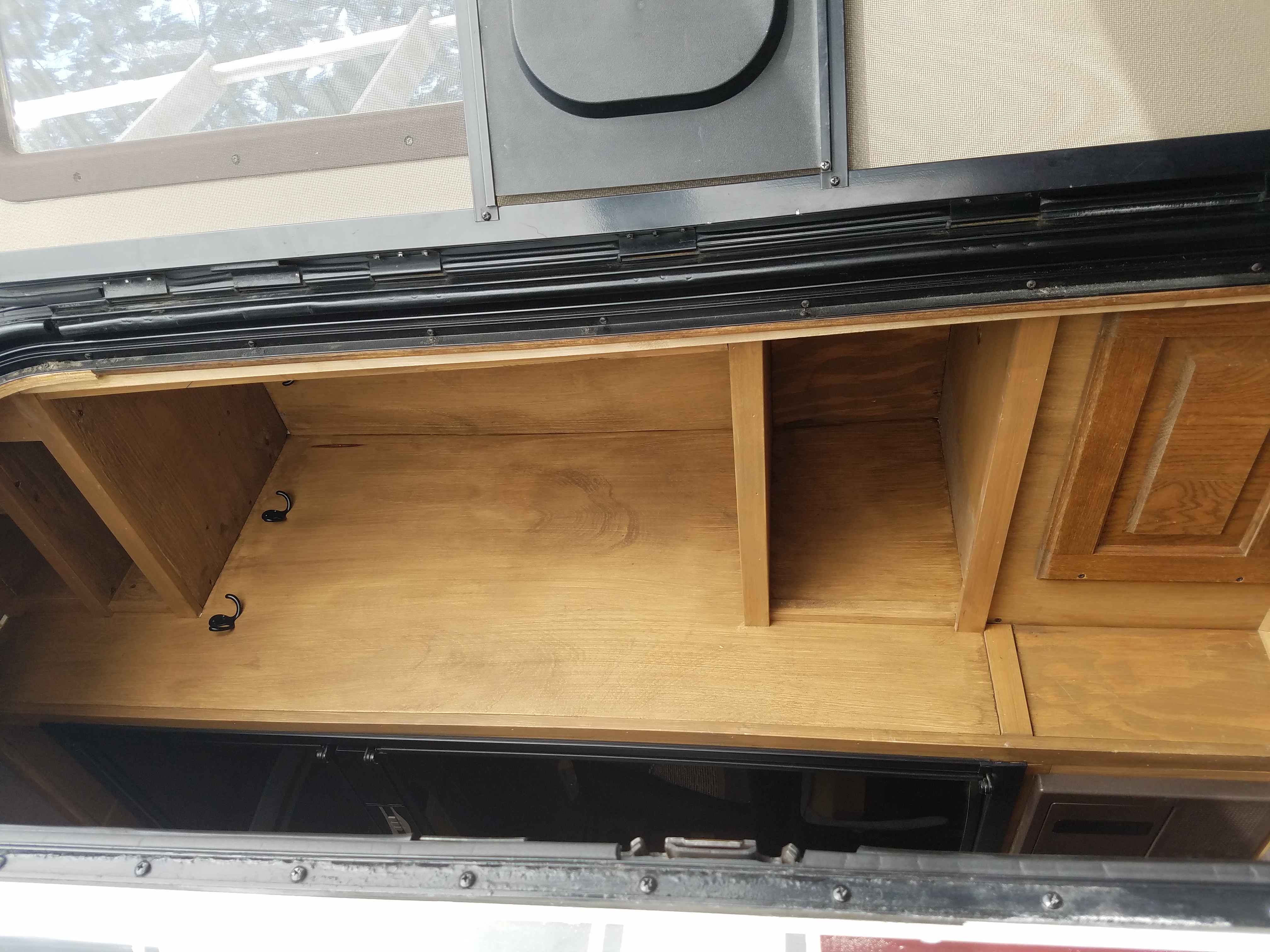

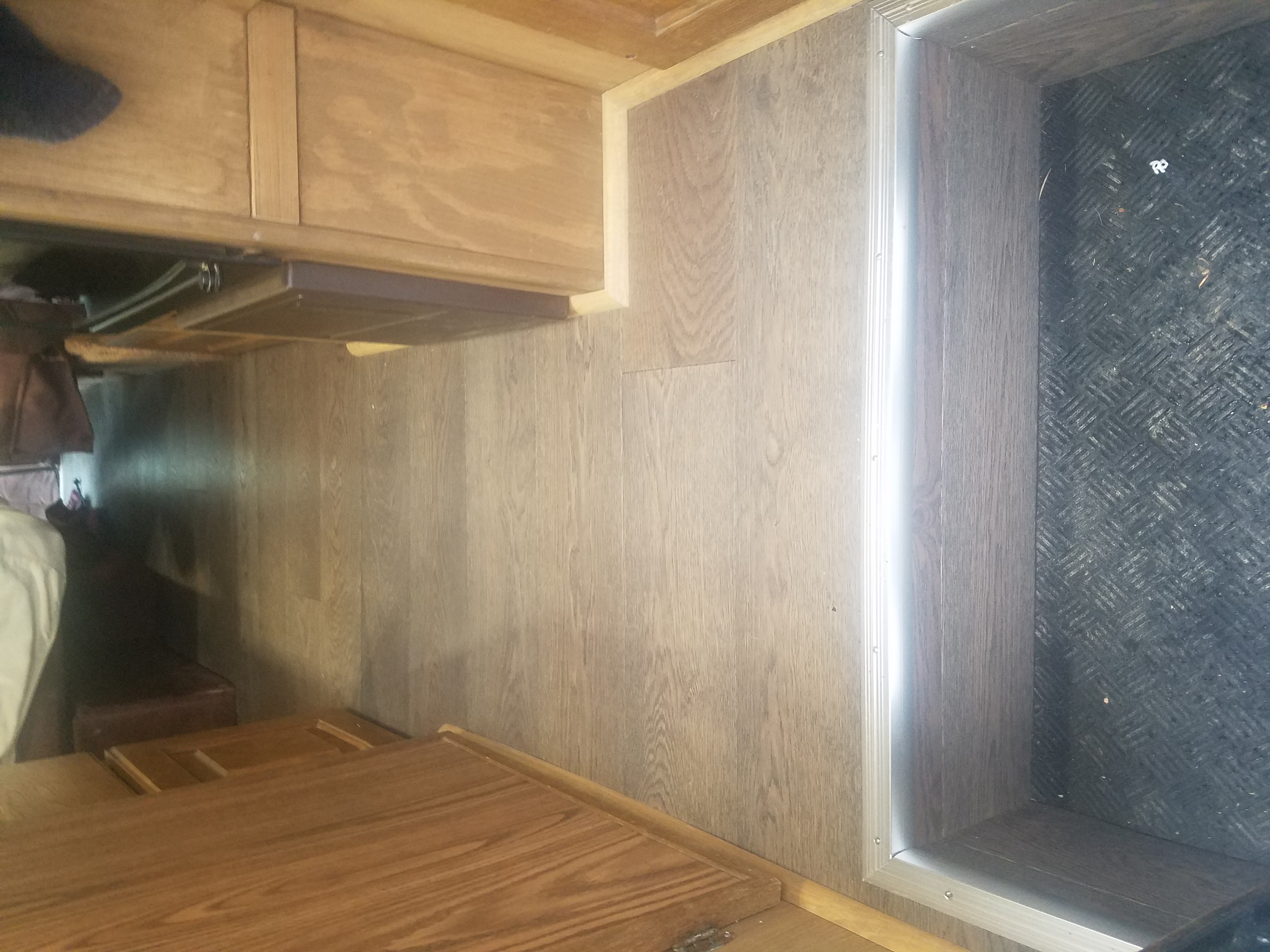

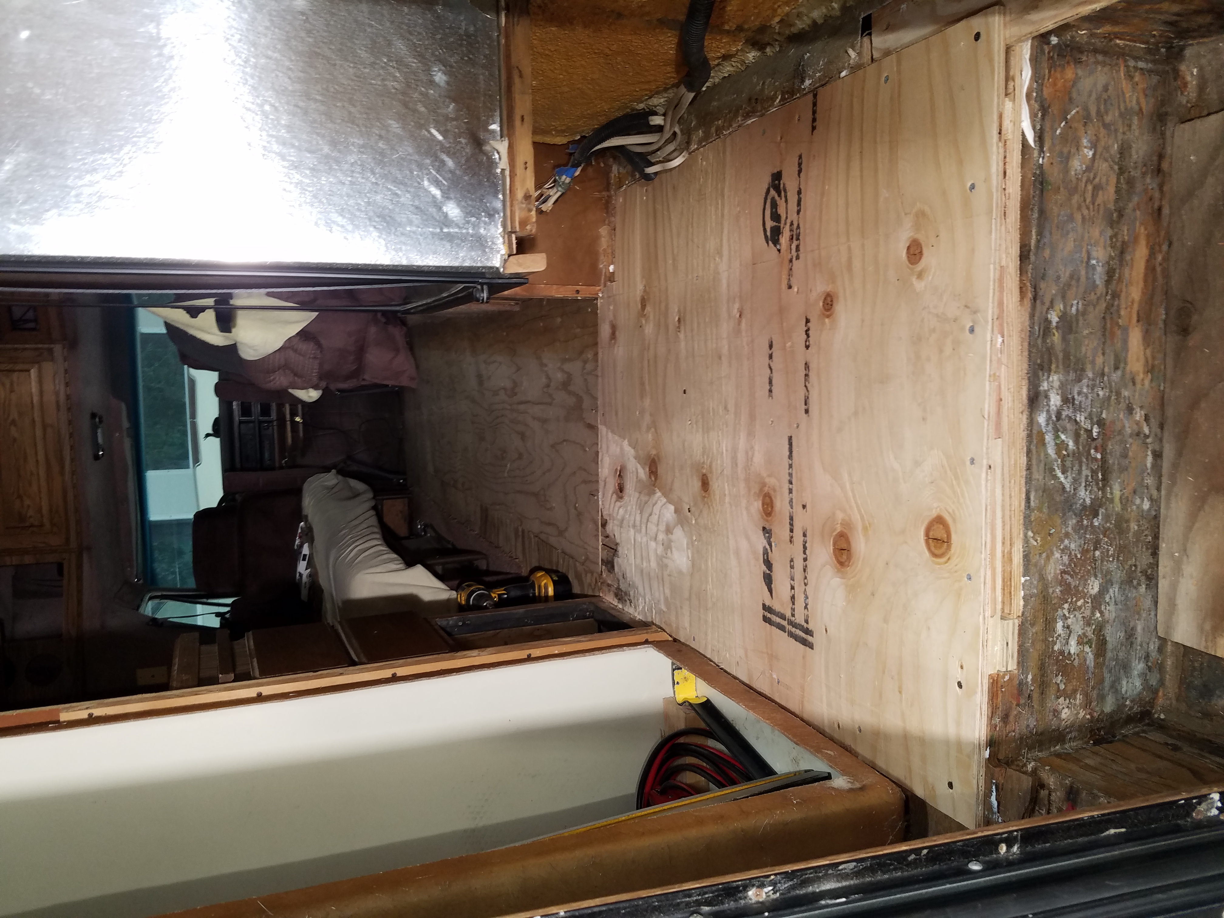

My Chinook needed similar repairs. I gutted out the back behind the shower, behind the refrigerator and around the generator box, and then up the aisle to the cab.
The 1987 version, was quarter inch plywood bottom layer, one by four sleepers with batt insulation between them, and half inch plywood top layer. Fortunately the underside of the bottom layer was fiberglassed and undercoated, and survived.
Once i got the rot out, i glued (liquid nail) and screwed 3 layers of plywood, one at a time, eliminating the hollow core where the batt insulation was. I'm pretty sure i got most of the rot, although i didnt take anything out down the sides.
I did fiberglass the old and the new together, quite vigorously and with fibermesh.( see photo )
Then I through bolted the new floor into the frame. Would I do it again, taking on a coach that needed that much work? The answers no.
Click on the attachments to view in proper format.

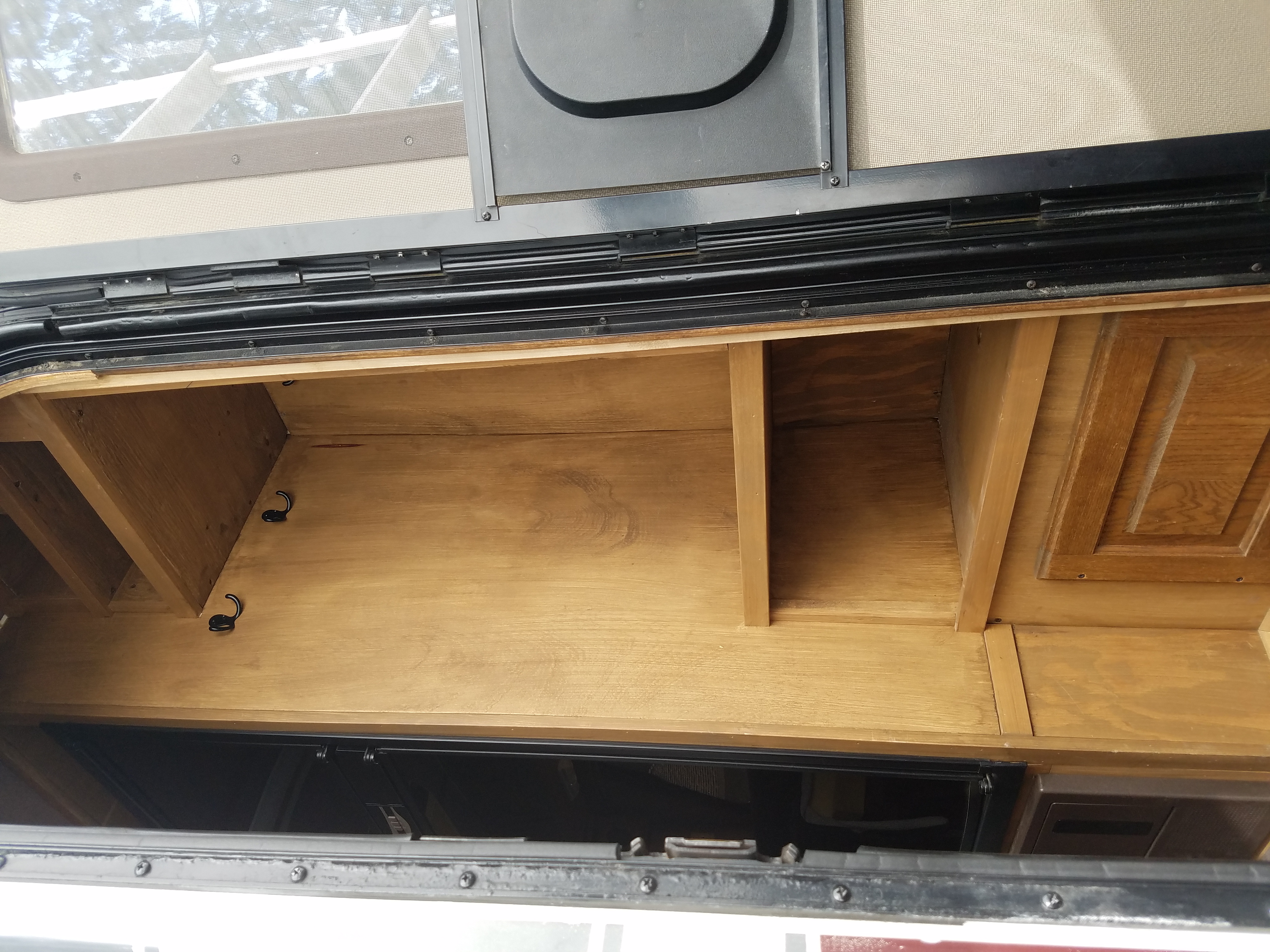

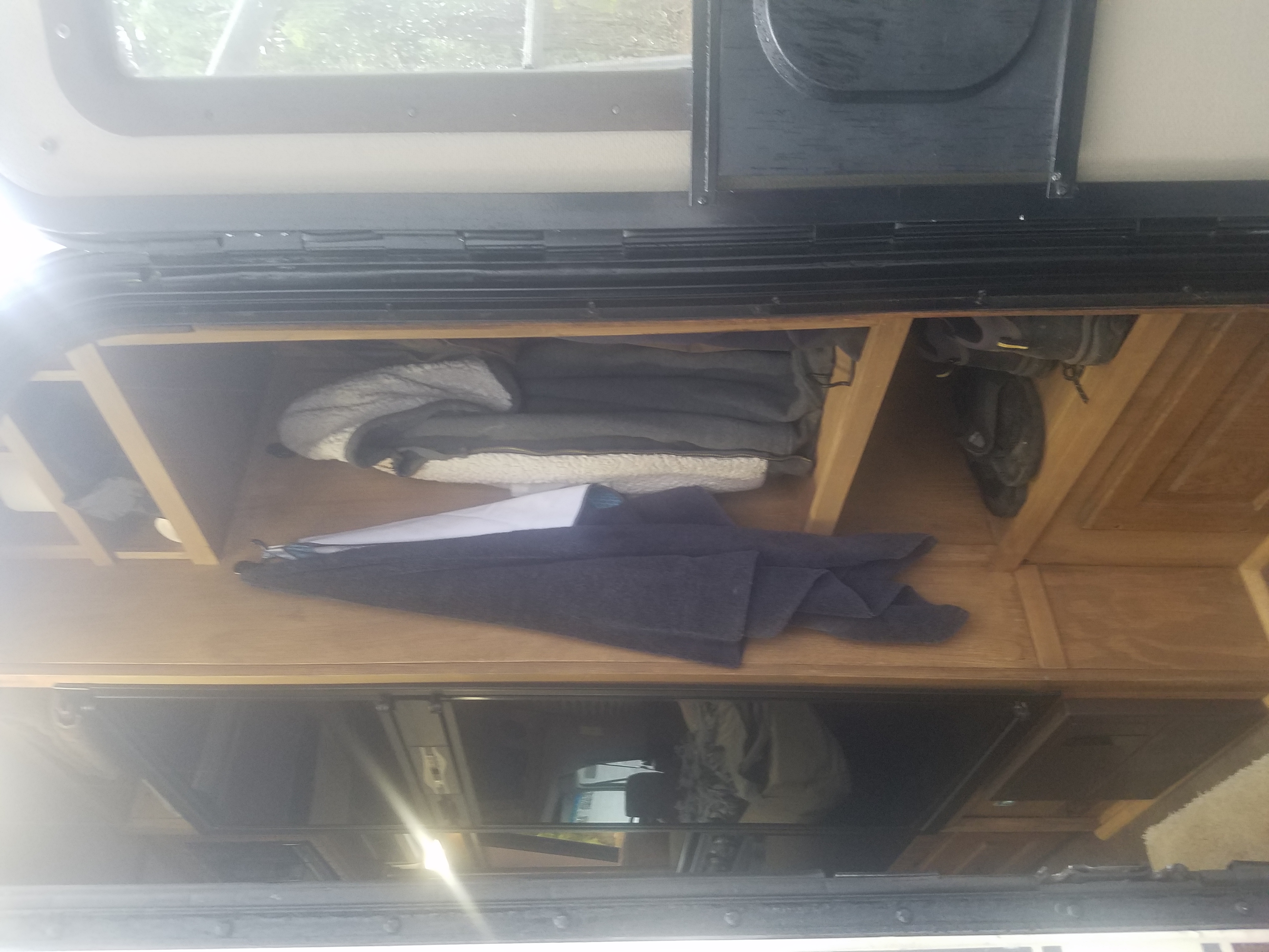

Finished right corner at doorsay

Wow! Chinnin-About! You did a great job with that closet. I would so love to do that, but I need that space for other things and just can't afford to give it up. That's some beautiful work you did there. We're still at the tearing out phase. We've gotten a lot done, but it's gonna take a while to finish. Thank you for your info!!
