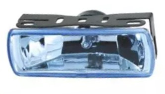

Replacements that I've read of being used include...
For about $180 a pair:
PIAA 1500XT fog lights
Apparently they're really nice. For the price, they should be!
For about $26 *each*, these LED bars from Amazon:
https://www.amazon.com/gp/product/B01N4 ... UTF8&psc=1
Pretty blinding.
For about $60 a pair from Autozone:
http://www.autozone.com/collision-body- ... true#close
Same as above, but only $25-31 a pair from Amazon:
https://www.amazon.com/gp/product/B0002 ... UTF8&psc=1
At least it says it's a pair. Also plenty on eBay, but hard to tell if single or not. You might need to ask the seller. Search for model NV-515W.
NV-515W
NV-515W
The above model NV-515W lights reportedly even fit in the original brackets. Be sure to check sizes vs. your openings of course. Luck!

Kevin, I have the same lights that that you showed in one of your responses blue Lenses.
